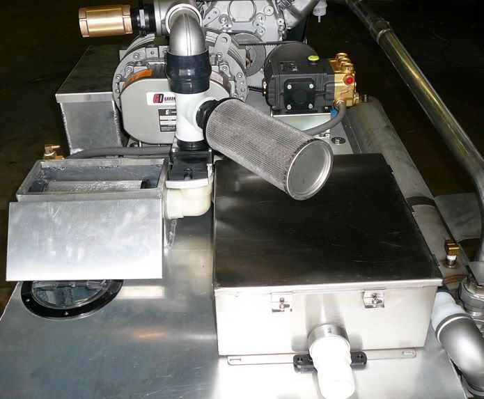

Here is a photo of the new QuickDry TM system for speed-drying carpets.
This photo is taken from the back of our Dynachem 534 TM ...,
First it shows two stainless filters, one in the recovery box at left,
and one for the drying system on the right.
2 Valves to control the air flow.
The box on the right lowers the temp of the airstream from the #4MR blower.
Another configuration is used on some other PTO TM's.
We have some special new Hi-Temp Vac hose that is included in the system.
The specially-modified RX360i is the final part of the system.
Drying time is 10 to 15 minutes with the #4MR Blower.
What type of extra charge do you think your customer would pay for this service ?

Larry Cobb
5,795
Dallas, Texas USA
Larry Cobb
Mikey;
There is NO air from the recovery tank going thru the blower.
The Blower is used, but since it is subjected to continuous 235° F for long periods of time,
microorganisms will be essentially eliminated.
Some heat will be introduced, but the AC system should be able to handle it.
The system cools the air before introduction to the house.
I would have no problem with typical cleaning including urine done before this process.
I have some customers now, who charge a premium for "Quick Drying".
Larry
Larry, I'm having a hard time seeing the second control valve. Are you saying that the valves are set to draw air from the recovery tank for normal extraction, then set to shut off air through the tank and draw air through the second filter (clean dry air from inside of van) for the drying step? As in the drying step is separate from extraction? The main problem I see if this is the case would be drawing CO fumes out of the van from the propane heater or TM engine. Correct me if I'm wrong, and perhaps more pics from different angles would help.
Larry Cobb
5,795
Dallas, Texas USA
Larry Cobb
Dan;
The second exposed filter has a shut-off valve inline.
The exhaust from the engine is routed out the front of the TM with a flexible hi-temp exhaust hose.
It will be outside the truck, at least 10 feet away from the fresh air intake.
It will require some minimal housekeeping inside the truck :roll:
Larry

So you would set the valves for extraction, do your normal cleaning, then reset the valves for drying and go back over the area with the 360 to dry?
