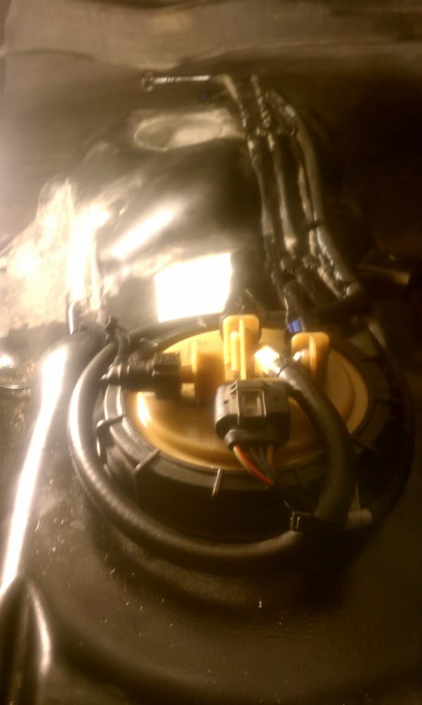

Almost all 07 and up will have an auxilary pick-up, top left center of this pic, if you do not need return, you pull from here and you are done.
If you need a return, you have to drop the tank. disconnect the lines in the front of the tank, and there is a wiring harness plug you must disconnect beside them, both clearly visable, no tools required just push the lock tab into the fitting and they pop apart - remove the fuel door and filler neck bolts, 3 bolts to remove the exhaust shield, 6 bolts (you need a star socket set) for the tank straps. Note, run the tank as close to empty as you can - but don't run dry. Drop the tank.

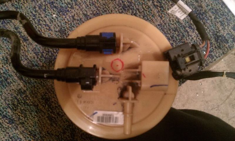

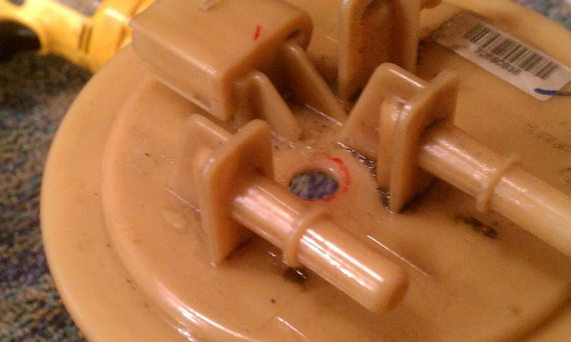

Top view of the sending unit out of the tank you'll see a red circle where you want to drill through

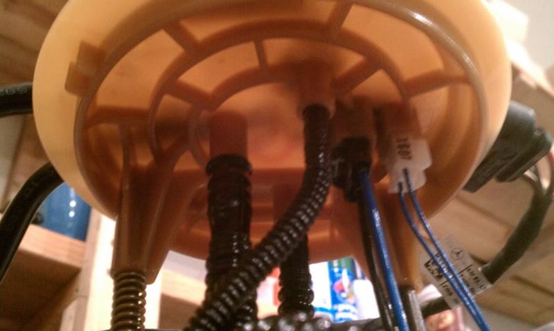

Here is the bottom of it, and why you have to use that specific spot

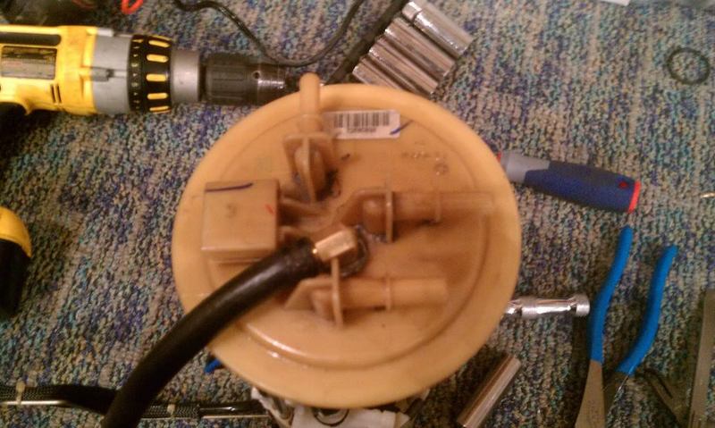

Hole drilled (make sure not to get plastic bits into the bottom assembly of the unit when drilling). Note that you will have to dremel out a tiny little bit of the plastic gusset going to where the wire plug goes.

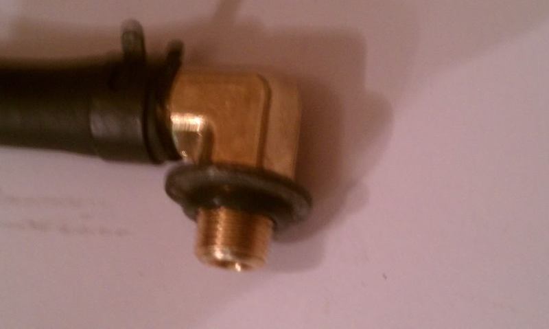

Brass fitting with the line already installed on it, you will need to use the squeeze on clamps, the others won't fit. I drilled out a washer to fit the brass fitting through to serve as a backer for the rubber ring to seal the tank.
This is the only way it will install, position the hose this way, you have to use a 90 fitting, a straight won't have the clearance.

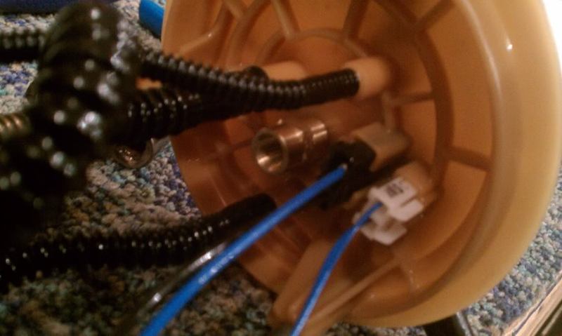

Barrel connector on the enderside with a smaller oring to seal from the inside as well - don't go too nuts tightening, you do NOT want to break the plastic - I believe these pickup/sending units run upwards of $2500
