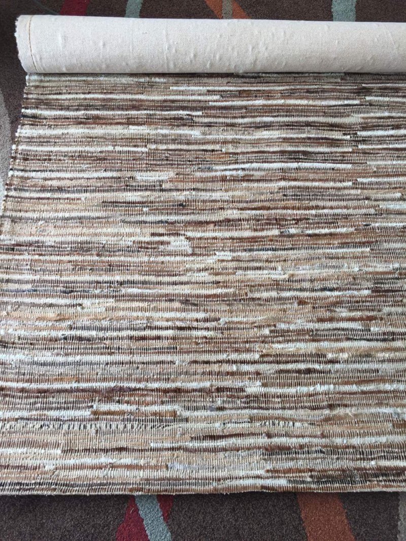

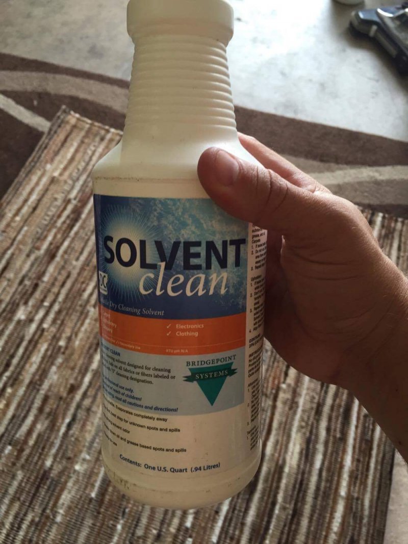

I've gotten a few tips from our local vendors on cleaning this. Have not come across 100 cow hide with 100% Cotten back. It can't have to much moisture on it as the glue from backing could start coming apart. Was recommended to use Solvent Cleaner by Bridgepoint. Hand wipe on and possible brush in and wipe to remove? Anyone cleaned one of these before and how?
No but I have noticed very few cows in Kansas fall apart from rain. :winky:
OMS is usually your safest bet...however OMS is not a great cleaner. It works great on grease and oil but is fairly ineffective on water based soils and spills.
If I were you...which I'm not or I'd be smarter and better looking, I'd lightly spray it with your prep and use Host. :cool:

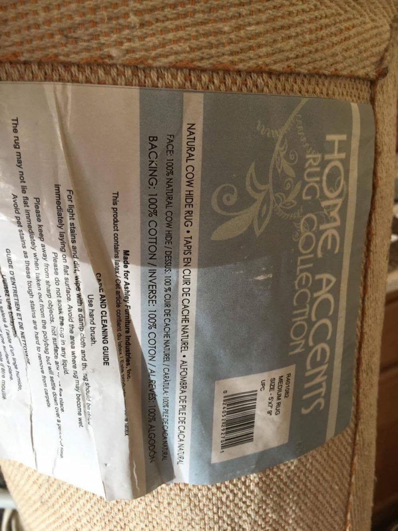

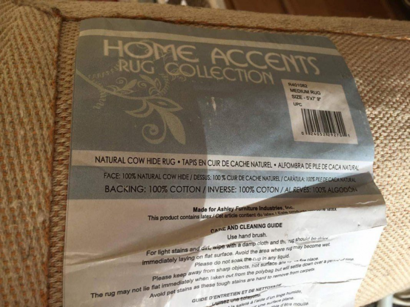

It says not to soak the rug in any liquid. That doesn't matter? We wouldn't soak, but light spray with an encap is what I was hoping for...

With Latex in the backing, I'd be wary of any solvent & would be inclined to encap with a Cimex.

The rugs pictured in the first pic both seem different, neither one looks like leather/cowhide.
Also, I don't see on the label where it mentions solvent??
The pic with the label also does not look like cowhide??

@ShortyDownUnder it looks like patchwork cowhide rug... Will just said it was recommended to use solvent...it doesnt say that on label tho

They bought it at RC Wiley for $900. Cleaned up easy. Was worried at first, but just some encap and compound and back to new. As always. :)
