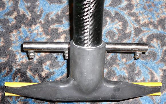

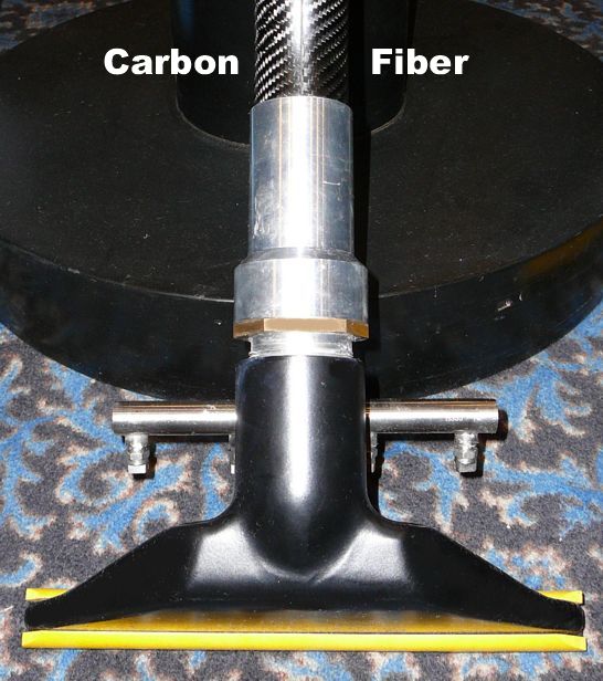

The Bentleys from Mytee were the ones I thought had the features, I was looking for.
This is the 2" Carbon Fiber model, which had the best vac head design and only weighed about 7#:
It had a nice overlap of jet spray. I thought the jets needed to be slightly more vertical.

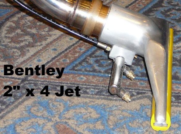

Next was the same model with a new swivel assembly:
It enables you to clean under beds and around furniture.

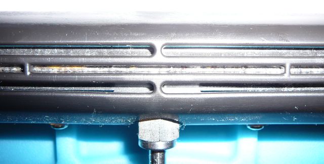

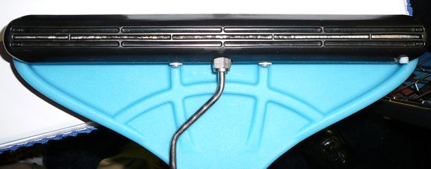

The updated Stryker from Legends was next.
It has 96 jets across the 14" width and 2 vac slots ------ (white cleanout at right):
Here is a closeup of the jet assembly: (equivalent to 3.5 jet)
I have some concerns about the jets clogging,
and the rotomolded head durability.

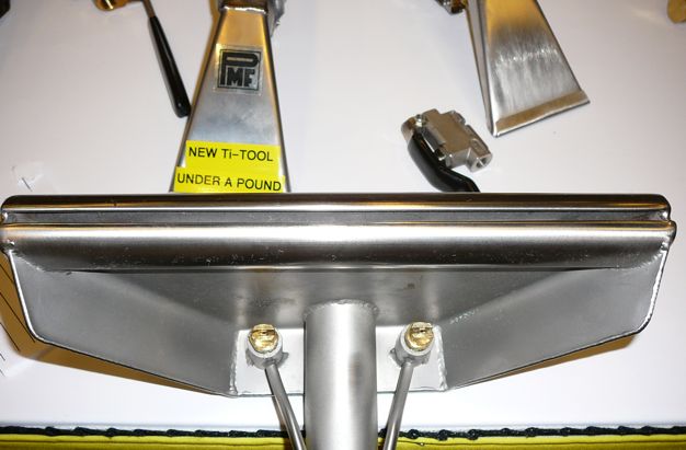

PMF also had a couple of interesting wands.
First, a 14" wand with round SS glide:
Above the wand is their new Titanium upholstery tool.
It was less than 1 pound.

96 jets? :shock:
Just what kind of pressure drop could a guy expect with THAT many?
I agree with Larry about the clogging concerns. That would be a royal PITA cleaning those buggers out, you'd have to do it very frequently I'd imagine. Doesn't sound like something I'd be interested in.

Regarding the Stryker the flow is 1 gallon per minute at 375 PSI using a CAT 3CP (1500 PSI) pump and 50 feet of solution hose. Of course more solution hose + more disconnects increases restrictions and affects flow so increased presuure may be needed. Regarding cleaning the Stryker actually has a self cleaning feature which I believe makes it the only wand on the market that does.

Hi Bill;
One of the guys at the booth pointed out the threaded nylon fitting at the right end of the picture above for clean-out.
But, how does it actually work to clean out the 96 jets ?
Does it just flow water past the 96 holes ?

Opening the fitting subjects the inside of the manifold to vacuum which when combined with the flow of water cleans the inside of the manifold it's just another feature that Keith and Roy brought to the project based on years of real world experience. We all knew from the beginning that keeping the manifold operating and clean needed a simple built in solution

That bentley looks interesting, but the way wands get beat around, would that manifold hold up being totally exposed like that?

Hi Aris,
Were you at Connections? Did you see it close up? I think it's the type of product that you have to try out and see if a person is comfortable with it. I think a demo period is appropriate. I have many out there and never has a manifold broke or been damaged to my knowledge. If anything we have tried to over build it so it will last.
I was more concerned with whether the swivel would hold up so we made that part really beefy (and it is rebuild-able), so it's designed to last. That seems to be one of the features that PCC's really liked. Once they use it they got to like it a lot. The carbon fiber tube is also another innovation from Mytee that we will start to see others incorporate in their products in time. That material is hi tech and at this point unequaled. The swivel version is in the $600.00+ price and the non swivel is $500.00+ price range so it's good value for the dollar.

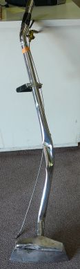

Aris;
Customers month-old TM wand:
. This is why I always look for durability on all of the wands at Connections.
The Mytee has a round stainless manifold.
It mounts on a 2" wide half-round section in the aluminum head casting.
It can swivel rotationally, and has a half-round clamp that goes over the round jet bar.
Larry
