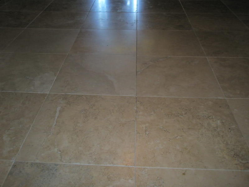

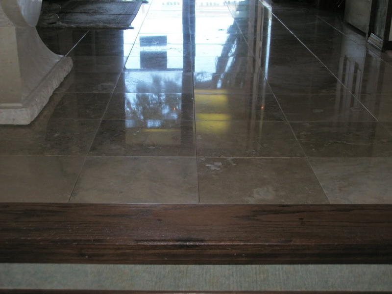

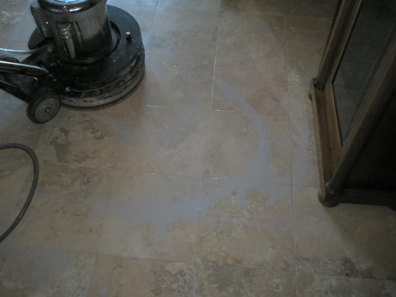

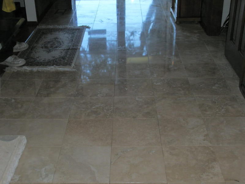

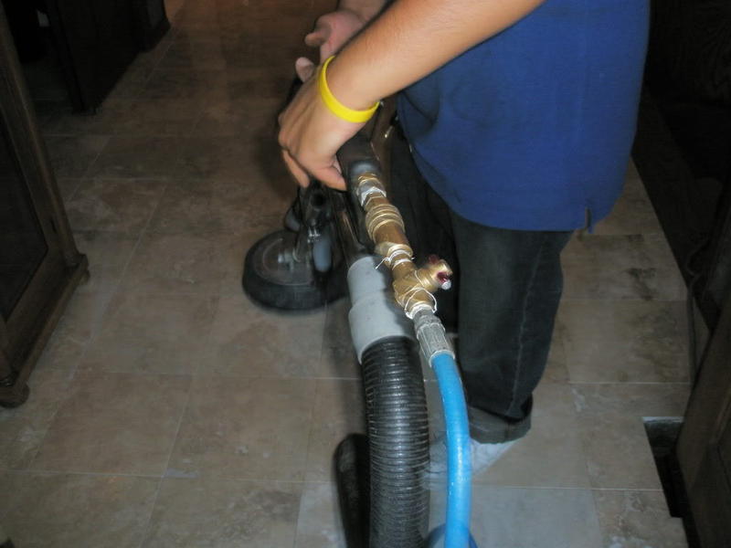

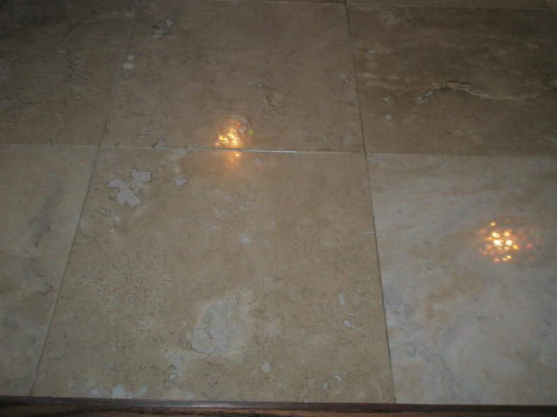

Well it went well worn floor 30 years plus. It does take some time but im happy. Cleaned with oxy blaster 175 floor machine and 50 pounds of weight 800 grit to 11,000. you really get the pop for the last step. IM happy.
