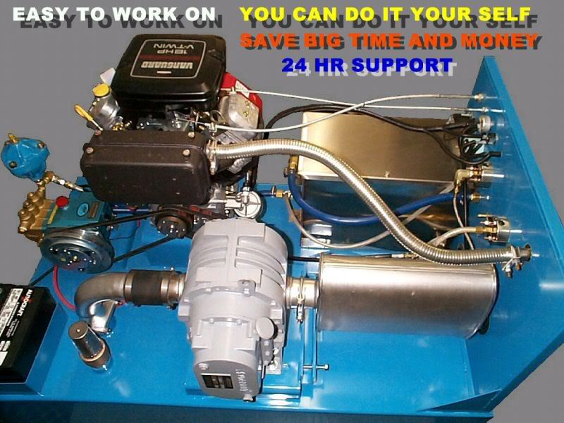

If it was me I'd go with the Reactor. Main reason is longevity of the machine and simplicity.
The stainless steel will last a lot longer than the HM or Blueline. The reactor is very simple to fix. If you have engine problems the local small engine shop can deal with it. There isn't anything with a blower that goes out or a cat pump and if they do you just swap them or fix the cat pump by rebuilding and can be done locally. I think all the sensor and extra junk is a waste myself. If you have a problem with the heat system the only part to go out is a cheap 10 buck wax thermostat. Belts should be easy to change....that's all you really have to worry about. Not to mention you're getting a liquid cooled machine. Compare what you get from HM with what you get from Judson. Then look at price and not to mention you'll get superior phone support and most likely be able to do the repair yourself saving you time and money.
Now if you can't turn a wrench go with your HM, Prochem, or Blueline from your local guy. they aren't bad machines, they are just designed to be replaced every so often.
Only $19,900
Includes:
Power Console
104 Gallon Stainless Steel Recovery Tank
94 Gallon Stainless Steel Supply Tank
Briggs & Stratton 27 HP Water Cooled Engine
Cat 3CP Pump With Clutch
Roots Tri-Rotor Blower
100' Of Vacuum & Pressure Hose
Wand
Outstanding Features
Stainless Steel Construction
A Water Cooled Engine
A Cat Pressure Pump
A Tri-Rotor Blower
A Simple Easy To Work On Design
Pressure Pump, Only Pumps Cold Water
No By-Pass On Water Heating System
No Recirculating On Water Heating System
No Exhaust Diverter On Water Heating System
No Solenoid On Water Heating System
No Valves On Water Heating System
No Sensors On Water Heating System
No Relays On Water Heating System
No Electronics On Water Heating System
No Moving Parts On Water Heating System
No Adjustments On Water Heating System
Free 94 Gallon Stainless Steel Water Supply Tank
Replace Engine In 2 Hours
Replace Blower In 45 Minutes
Replace Pump In 30 Minutes
Low Engine Replacement Cost
Low Fuel Consumption
Clutch On Pump For Flood Work
Simple Trouble Free Chemical Injection System
Dash Mounted Blower Lubricator

I know what the Cat 3CP is capable of, but what kind of pressures will the rest of the Reactor handle? I got a very impressive "looking" Victory 47 but if had it to do over it would be a high flow Reactor with a propane post heater.
I think I may have already stated my opinion here before but I'm more convinced everyday.
Bob Foster
Oct 8, 2006
8,870
Reactors are designed to run at up to 1500 psi. There currently is some testing of exchangers that is going on with higher temperature capabilities with 1500psi exchangers.
The higher you push the psi capabilities of a Hx the more challenging you make the unit to deliver and sustain higher temperatures. This is because to have higher psi you need thicker tubing which does not conduct the heat as efficiency.
Many people do not realize it but the current Reactor has a very efficient HX system for higher temperatures sustainability and high pressure capability. Judson has been working very closely with a prominent company that is specialized to only building heat exchangers. They have been building heat exchangers for many industries for many years. Nobody else but Judson in the truck mount business have these advanced heat exchangers.
