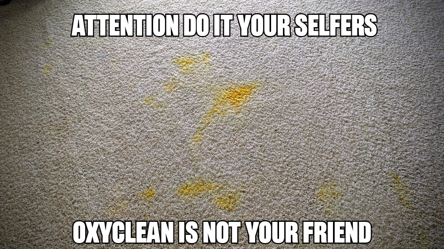

of my last carpet jobs had yellow or orange stains on Polyester that I could not get out with Oxidizers, Reducers, high pH mega sprays , 40 or Fels
What spotters do you care?
and which get use more than once a decade?
28,275
I carry volatile and nv solvents, ultrachem clean, tannin products, 40 vol, 2 part peroxide/ammonia on the truck, many more in the shop.
