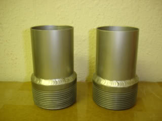

go to the local plumbing supply store, get an appropriate size threaded close nipple and cut off about 1 1/2 " and the tig a tube that has been cut on a 45 and made into a 90 then put on the flowmaster silencers (two) and you are done
Bob nailed it on where to find the big fittings
local plumbing supply.
(the place where plumbers and pipe fitters buy their stuff)
If you know any plumbers/pipe fitters or HVAC outfits that work on commercial steam boilers, ask them.
they'll know where the nearest local supply house is.
This outfit is local to me and where I've bought fittings large and small.
http://www.jfgood.com/locations.html
that's the kind of place you're looking for

Larry they are just standard but I wanted aluminum because it would be easier to weld to aluminum.They are 4" npt. I found what I wanted I just though a carpet cleaning supplier would have the parts and I would give them my money. My local did so I tried here.
Gene

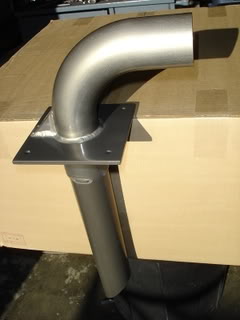

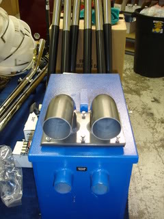

Gene;
We have some 4" pipe fittings and some 3" pipe fittings . Also 3" Aluminum 90° bends.
3" & 4" SS. tubing. Here is some typical blower piping and flex connectors:
More important for flow...
is utilizing a stainless silencer, that you hook up to the blower.
Larry

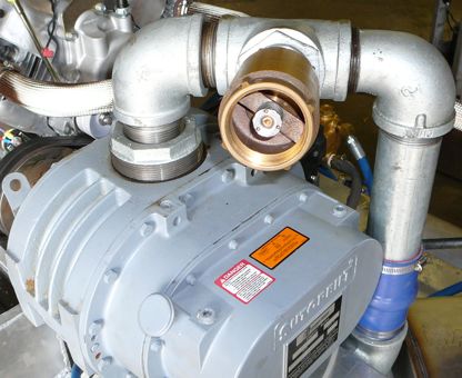

Actually that SHARP 90 going from blower to tank at the releif valve is just as bad as the hose restriction.
You are gonna hate me even more when I tell you what the inside of your BL filterbox looks like...
Don't shoot the messenger.

Greenie,
I'm assuming that those are 2.5" connectors. To go along with your theory why don't you make them straight instead of a 90. You are right about the hard 90 on my machine. I can see it would be a little restrictive. I going to change the connection at the tank so I can clean my filters easier. It's starting to hurt my wrists twisting that hose back to get at them. That hard 90 will be gone. I'll put a relief valve on the tank.
It doesn't both me if you find fault with my machine. Sometimes engineers over do things with out thinking about it. While I'm welding the filter box is getting a little make over. Besides the 2" connections do you see an addition problem?

GeneMiller said:
Greenie,
Yes, pretty obvious when you put them side by side with 2", kinda tells a story.
Like this?
If you look close on the TNT pictured, you will see that exact straight 2.5 nipple coming out of the blower, some TM mfgs. think they cost a bit much, but I wanted it super thin walled for maximum airflow.
Great!
If you do, just make damn sure your blower filter is super clean, every 6 mo. or so unscrew it and run the machine without it, IF you notice a dramatic Increase in vacuum sans filter, you know your "clean" filter isn't really clean...junk it, and get a new one, they can be deceptive.
The bottom of your 3" Stack inside the box, look at how close it is to the bottom of the box, it's too close, cut a 45 deg angle in the pipe like the bottom of this custom piece:
