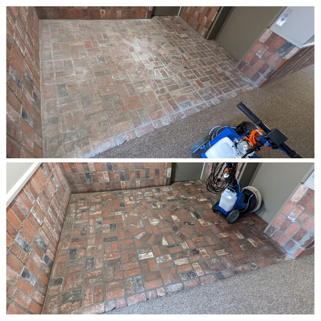

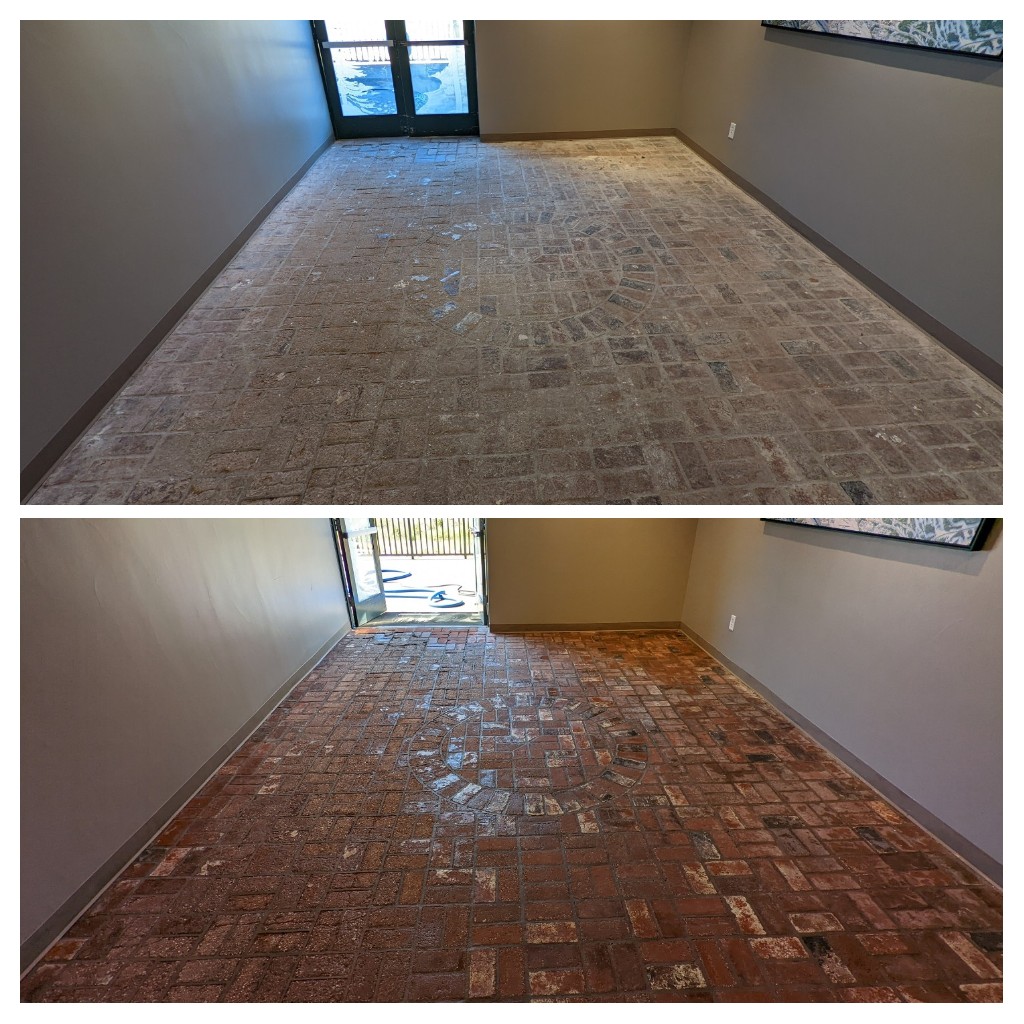

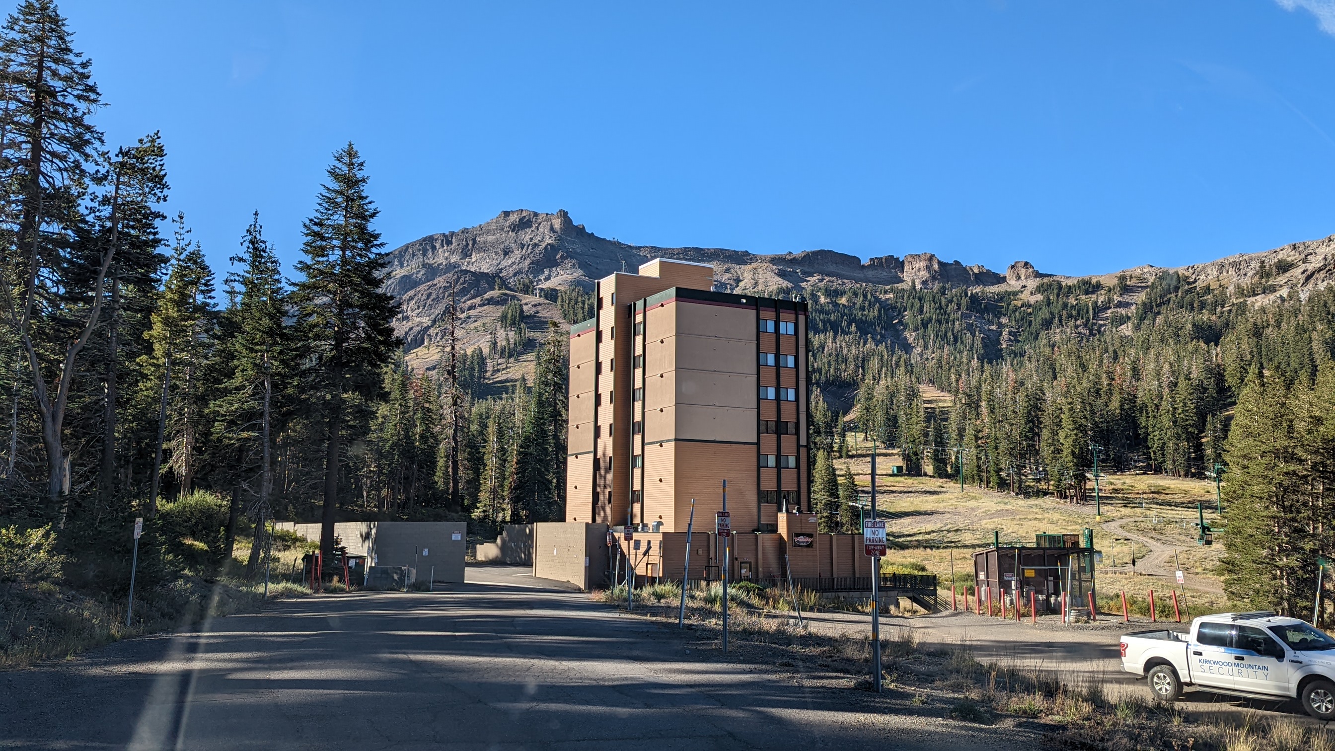

7 floors of CGD & brick w/ the PHX and a 175
1 floor of just wasted snow damaged brick w the 370 and a Westpak
and 4 estimates for carpet and slate at a condo
All up at Kirkwood sku resort, where its supposed to snow this weekend..
What are you idiots doing today?

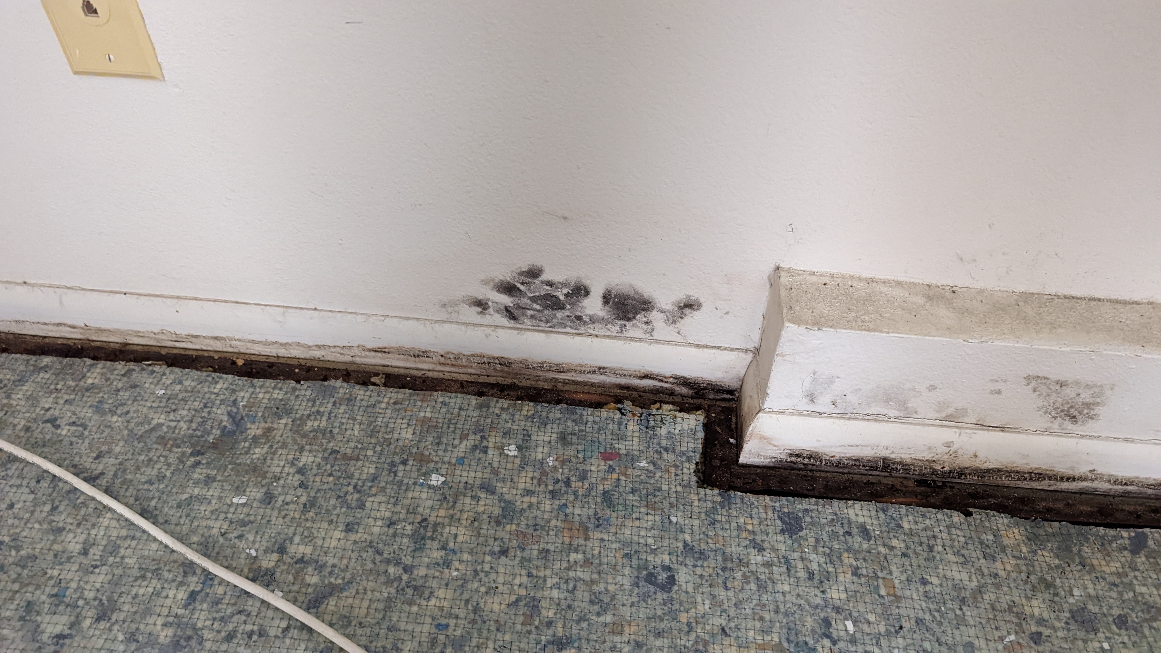

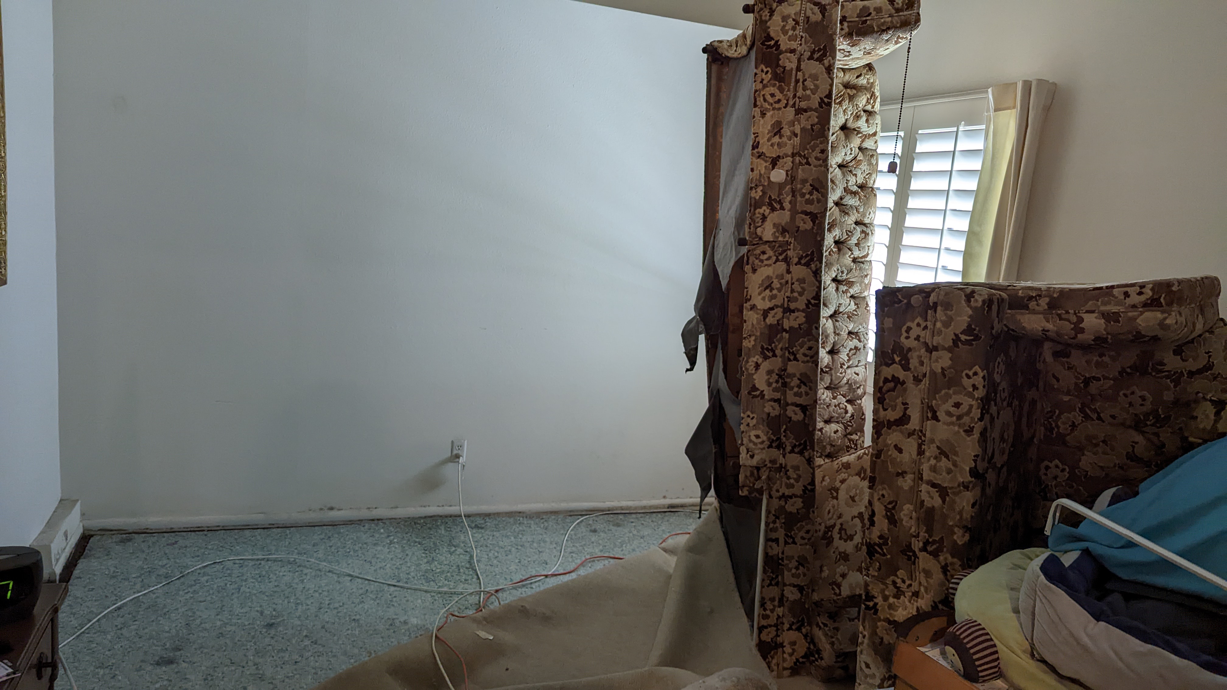

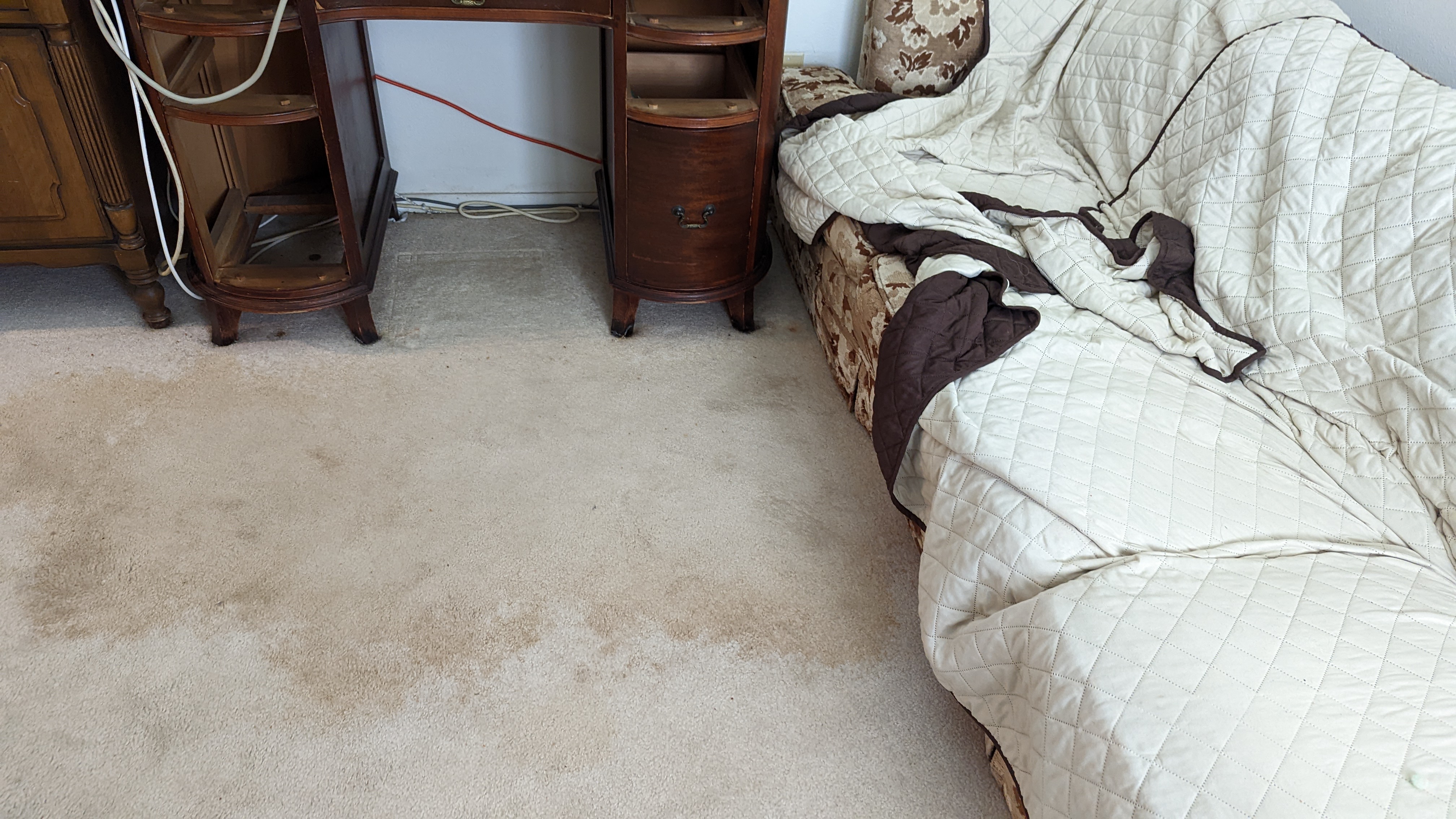

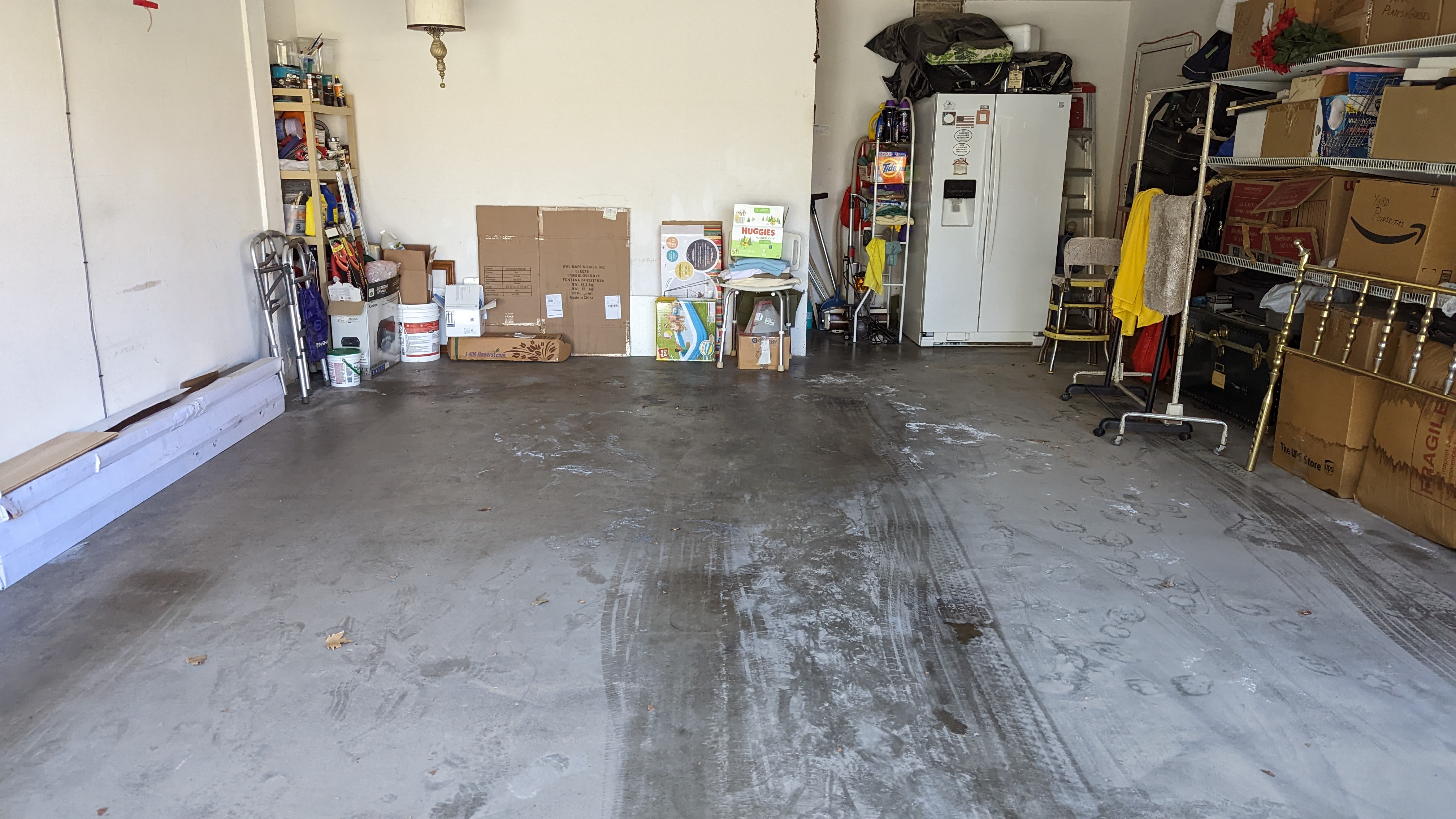

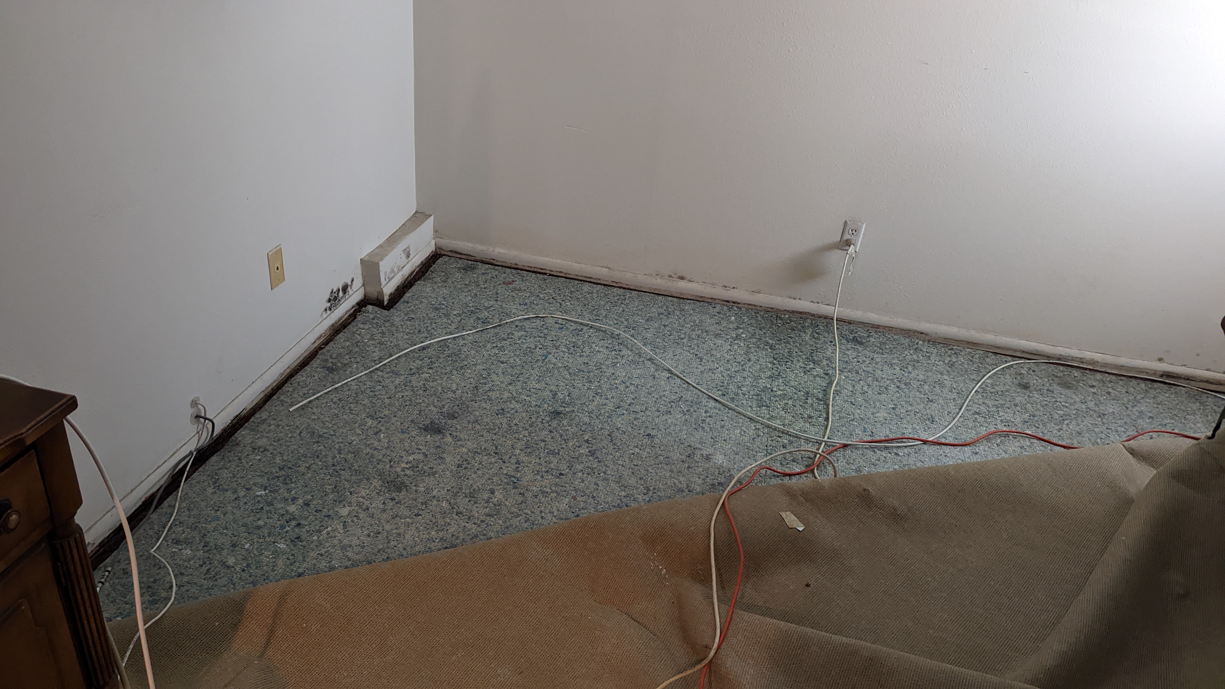

Flash flood went through a garage and into a 3rd car garage bedroom, she rents from family, helped with the down payment on the house for family.
They told her to get it fixed.
This is the second time is flooded.
Obvious mold on walls and base boards.
I told her I'll dry the carpet, I don't open walls.
So I moved furniture, pulled pad sprayed quatalot top and bottom.
Extracted and cleaned replaced furniture with tabs and blocks and dropped a airpath.
I'll go back tomorrow for moisture readings.
She's a 80 year old senior treated like shit by family.
I told her $200 she said no $300.
I'm a sucker for old people.

Ps I removed wet pad and sanitized top and back and sub surfaced one small area I could pull the pad.
It could be cat 3 from her dogs.
Hopefully Quatalot works.
Technically it was fresh water not sewage
Fresh how? Was it rain that came through the window?
or rising waters from outside flooding a previously water damaged room that has mold.....and dogs?
and you really shouldn't introduce air movement (like that) into a structure with mold......not only are you now blowing it around but you are increasing the humidity in the room
you couldn't pay me extra to do things wrong, even to help an old lady, when the possibility of me getting sued over it is nonzero
I may have offered to remove the carpet/pad and extract with a written recommendation that she contact a restoration/remediation company and documenting why I did/didn't do things

I told her the walls need to be opens and that this wasn't a optimal fix.
But I guess my solution is better then leaving it.
Ps it will be dry by tomorrow she's sleeping in another part of the house.
I didn't open walls where any real problem exists.
Ps she loves me
They had the AC running no windows open.
They already transfered the problem through out the house.
Is it though? The carpet should have been removed. Mold, dogs, furniture stains etc. Especially since it was a water intrusion so not likely a situation where insurance might have a say/delay the removal. Then there is no reason to introduce air movement (by you).
and I may be wrong but you weren't even dealing with the homeowners right? That increases the potential of you having issues.
