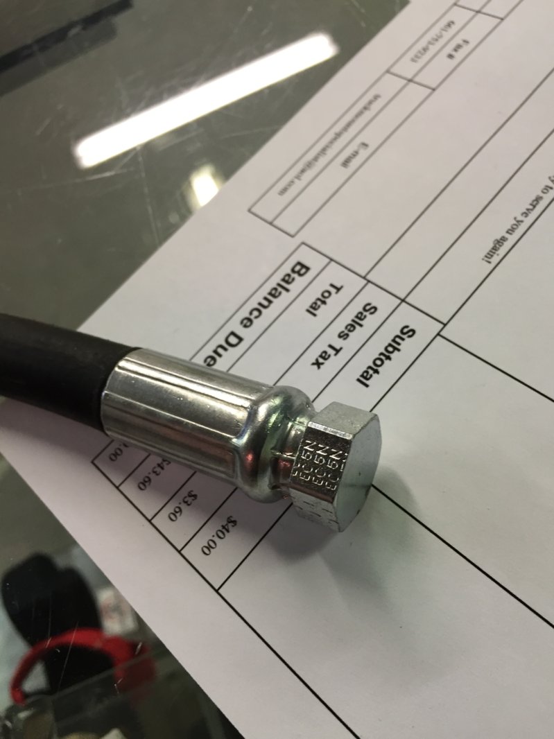

Whats the going rate to recharge??? Sapphire machine use pulse hose's and I've been buying them for my 405's for years. a pulse hose will usually last longer then a acumulator on one charge. I get about 2 years out of them on the average.

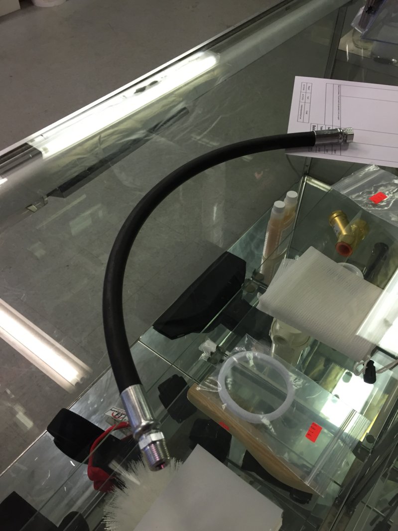

A 3cp still could use a pulse hose, in fact the vise of the pulse hose is based on the size of high pressure system (heat exchangers, Chem injection) and the pressure and unloading in your system.
On a mid size unit 20hp 4 blower with a couple of heat exchangers I have found a couple of pulse hoses connected by by a coupler works great.
On prochems we assemble 2 pulse hoses together with a coupler and a plug on one end and screw/thread the other end right into the pressure assembly where the accumalator was. Then loop it up and across to the other side of front grill and use a couple of zip ties to secure in place or use a a simple 1 screw hose holder to secure in place.'
We buy our pulse hoses from Cobb carpet and they are pretty reasonable something like 20 bucks a pulse hose.

I'm sure all of my accumulators are shot, though I haven't noticed any issues... Why not add one of those hoses? I bought 3 from Cobb for $57 with the shipping..

The one on my 870 is a cat with no way to check or rebuild. I have a rebuildable stainless one on the shelf. Because of the angle it's installed I'd be Leary to change it to the much heavier one. I had pulse hoses in the past and they always broke. I gave up on them and went to the rebuildable.
