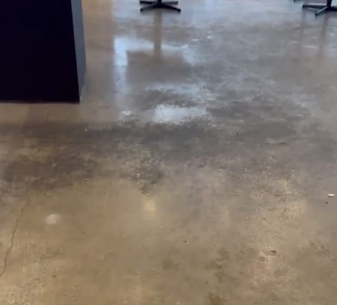

It's a city cafe, VERY neglected. Here's a section before. He said he got it re-polished for a bargain...Aggregate was unevenly exposed throughout and obviously pretty etched from the spills that hadn't been mopped up properly.

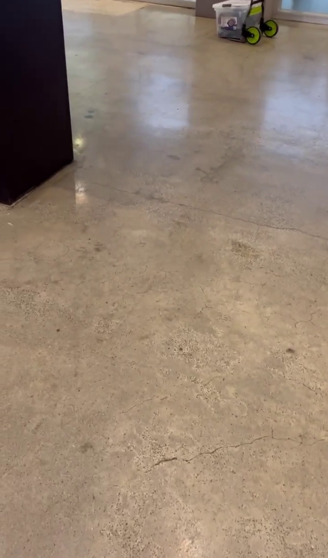

Here's after. Couldn't get the footprints.
If the footprints are underneath the polish, you need to strip first.
