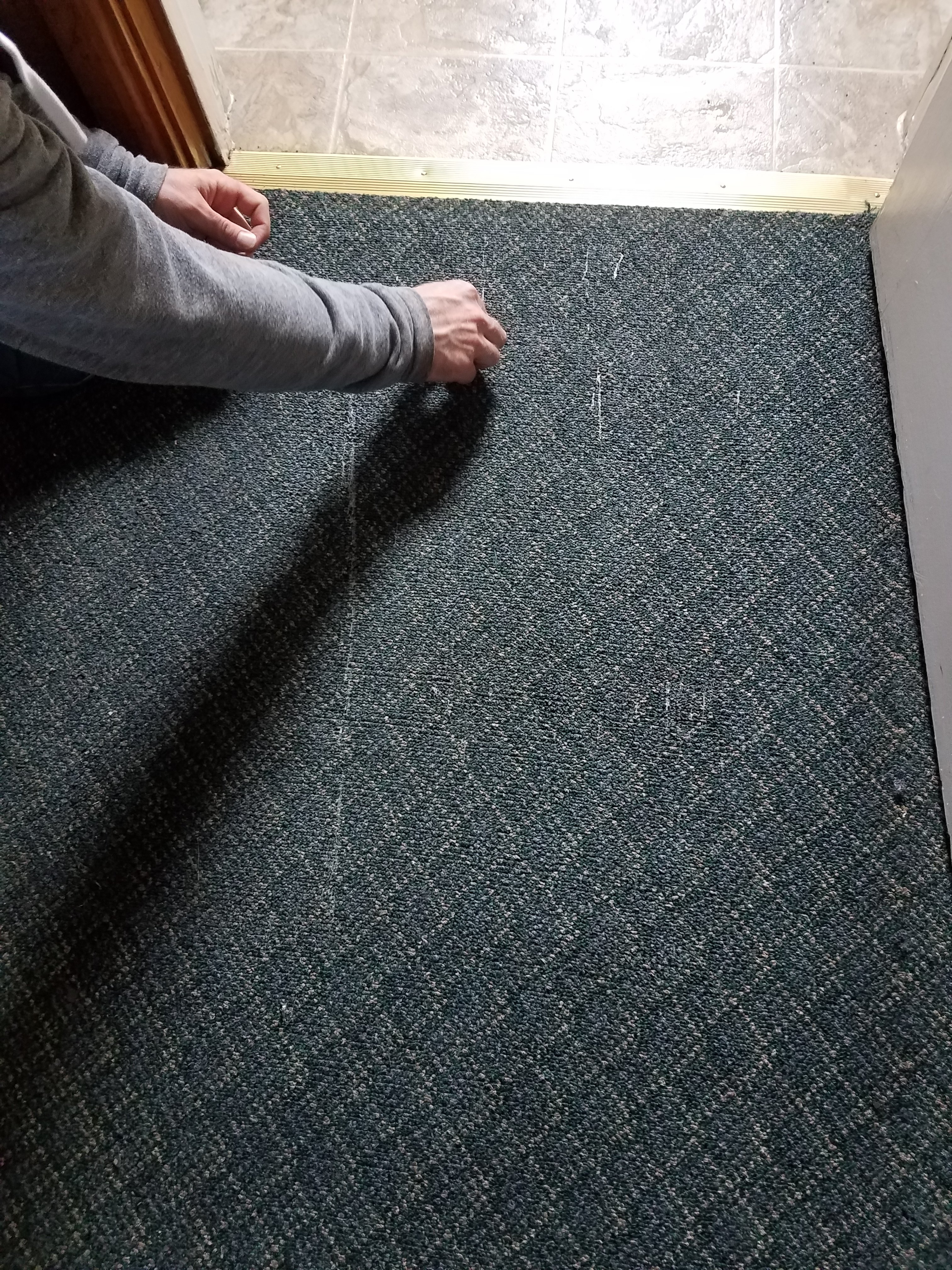

I'd be inclined to leave them with "their problem" you've done quite a bit, unless there is light at the end of the tunnel and its drasticly improving?
Even if it is salvageable with cleaning new carpet installed in those areas seems more cost effective

I would question whether that was enough to break down everything you built up.
Best if the encap polymers only have the residue to deal with for testing integrity.
Ok. I'll Pre spray tomorrow and wand out then encap.
Prespray, scrub with a fresh pad, rinse, straight-encap with a fresh pad, (...maybe post pad with an absorbent???or not???..leave more polymer???)........ cross fingers, condition customers expectations, and subtlety address the fact that it was not the brightest thing to do.
Tell them it will be your final attempt at correction, and if unsuccessful, they will have to consider replacing or whatever.....and........very subtlety.......that it was not the brightest thing to do, and keep the fault on them for being ignorant, not for you not being able to solve the problem after such a valiant effort, if that is not already the case.
Always wise to "check" your customers understanding of the situation and cover your arse.

Acetone will work but will delaminate the carpet in a hurry. At this point, I would use a volatile solvent such as Prochem powersolve. Lightly spray on and I mean lightly, with a misting bottle. Buff it off with whatever floor machine you have and absorbent bonnet. Repeat, then repeat. Then replace the carpet.

Carpet is pretty much delaminated. The guy had a putty knife in there for when he peeled the tiles up. Lol!
28,280
I've already told them it's a loss. But I would like to know if it can be removed.
Probably not without causing more damage. Sounds like the damage was done before you showed up. If you want to experiment, try what I suggested. Volatile solvent just means it's fast evaporating. Its usually my go to product for that type of situation. Solvent and agitation and absorbancy are the key. You don't want to leave solvent on the carpet.
