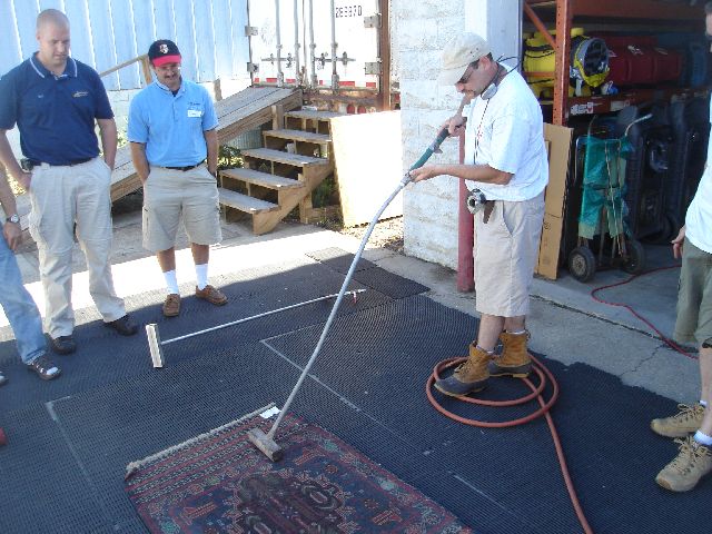

We are currently designing a permananet rug pit. We expect to process 30-50 rugs a week. It will be a submersion type similar to what Jeff Bishop demonstrated at Connections. Obviously we hope it will process more buy we are being conservative. Rug Badger or Compressed air? Which and why? Any advice is great appreciated.

Compressed air will only make all the soil airborn, settling in your shop and other rugs.

Thats why you dust rugs outside. We went over rugs 5 or 6 times with the rug badger and then we hit it with the compressed air and tons of dust came out. I was really impressed with the compressed air.

If I were in the market for low-production dusting and had only one choice, I'd get a Badger.
Air dusting removes more fine particulate but isn't as good at moving larger grit. Fine particulate is easier to remove during the cleaning process, so pre-cleaning removal isn't as critical as moving the heavy stuff. The biggest downside to the air system is the high cost of a compressor large enough to be effective, and trying to trap the dust cloud of that fine particulate.
I've found a pad sander modified to use a smooth plate works fairly well and removes more of the heavier grit than air dusting, and will be gentler on the carpet, but will take much more time than a strap-slapper to do it. You can get a pawn shop sander for $500, so might be the best product if you have more time than money.

Badger, you don't have the mess of compressed air.
Greg's got tons of money bulging out of his pockets. Why pay $3,500 for an effective machine when you can spend $10,000 for a messy system?
