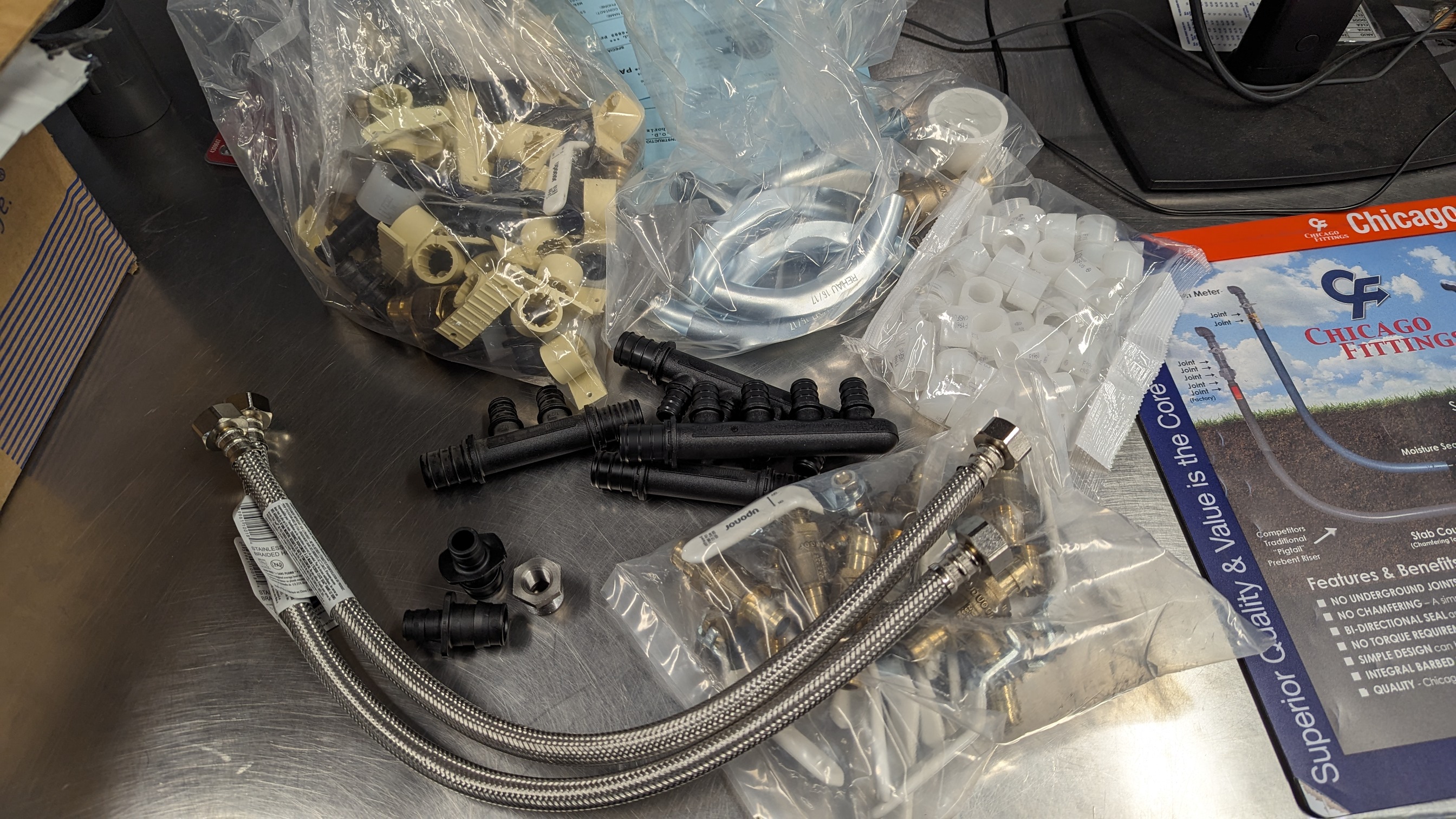

Sir, that is cold expansion PEX A / F1960 If you buy that pipe you gotta buy the expansion tool to assemble it. PEX B uses the crimp or cinch rings.
I bought the $70 manual tool for single fixes, and my supplier loaded us the Milwaukee tool at no charge
