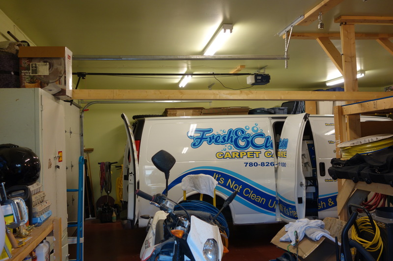

I've always struggled with finding space to dry area rugs. Had a good rack made out of 2x4's (think it was modeled from a picture Ken Snow posted years ago) but after a period needed the space for storage and tore the rack down. Recently had a customer drop off a fine "Persian rug" (was a pos synthetic) and needed to come up with a way to dry it. Lucked out and found a spot where 12' 2x4's would span between a shelving unit and a tool cabinet with 9' of clear span.
Have a look around your shop, maybe the space is there.

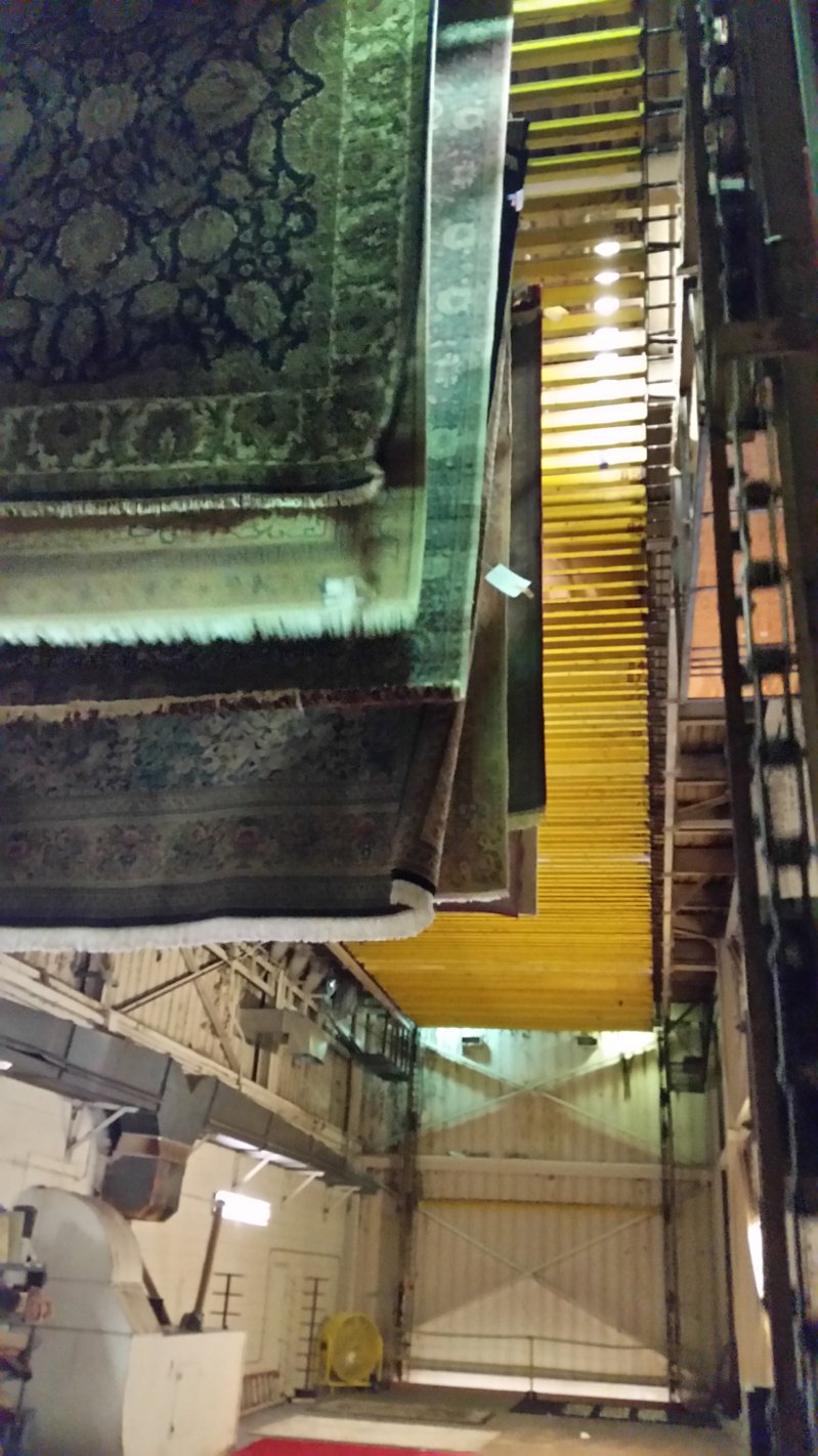

If you need your rugs dried, send them to us. We have a little excess capacity this week. View attachment 16080
We'll keep it nice and warm too, promise!!!
Brian I don't think he could be profitable sending the rugs to you, it would cost him to have them cleaned and he would loose lots of money and time.
I think that was a bad idea. Imo
