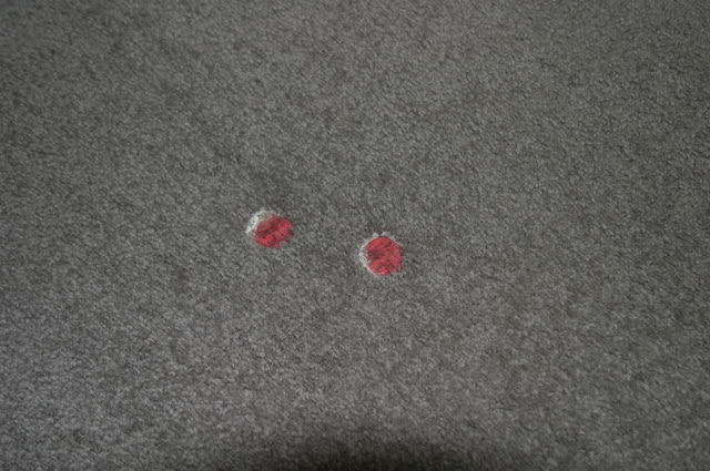

Cut pile carpet. 4 yrs with a fair bit of fade and wear.
Plug came out of the bottom of the bar stool and cut out two neat little circles.
Only donor carpets was an off cut un touched from the attic. No fade or wear at all.
Full replacement cover from her insurer but decided to let me have a shot at saving it for him. First job for this office as they are 3/4 hour away.
Problem area.

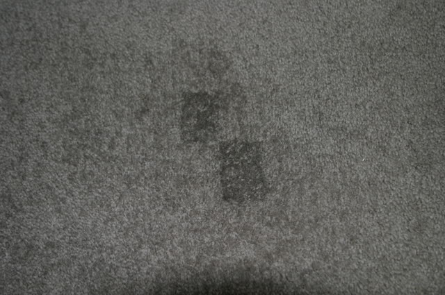

Ready to go.

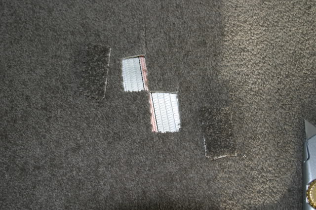

Glue gun seamed the edges, KG tape underneath. Ready to 'fade' it to match.

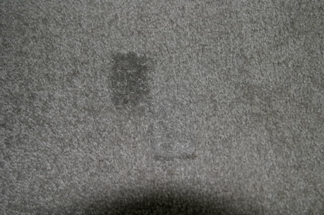

Half done.

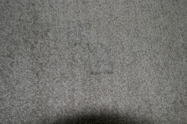

All done. You have to really look closely to find it.

I should clarify that last statement about being hard to see.
If you walk into the room, you don't notice it and you have to really look to find the repair.
If you know where to look already, then they are noticable, but only for a month or so because of it's location is a traffic lane on the edge ot the curved breakfast bar.
This is on the main traffic lane from the fron door around into the kitchen and onto the family room so it'll wear in fairly quickly I'm picking.

nice, did you freehand cut the pieces, use a template, straight edge, or how did you measure the cuts for the donor pieces?

Steven, Harry nailed it.
I often do a small cut beyond the repair area to get tape under and then often run a small bead of hot melt glue in the cut before fitting the insert.
By doing this, it saves stretching the shape of the cutout while getting the tape under.
