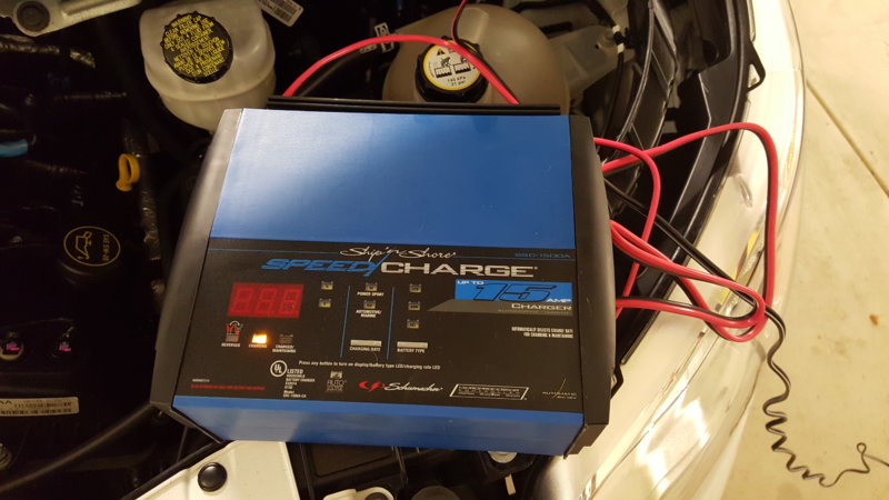

My mechanic buddy talked me into getting this thing to charge all my vehicle batteries every 4 to six months.
He says the four seasons drains them quick out here.
Never worried about it in Cali
But I was never impressed with my battery life either..
Any of you follow suit?

Lead acids batt's really would like to do there job charging and discharging at 70 degrees. Much higher and colder temps have significant effects on performance and then life span. If that charger is designed to blast some constant current on demand (to push back hard sulfation) I would say it could help with longevity. In automobiles 3-5 years is the average life and what manufacturers have in mind. Fancy charger you got there....
