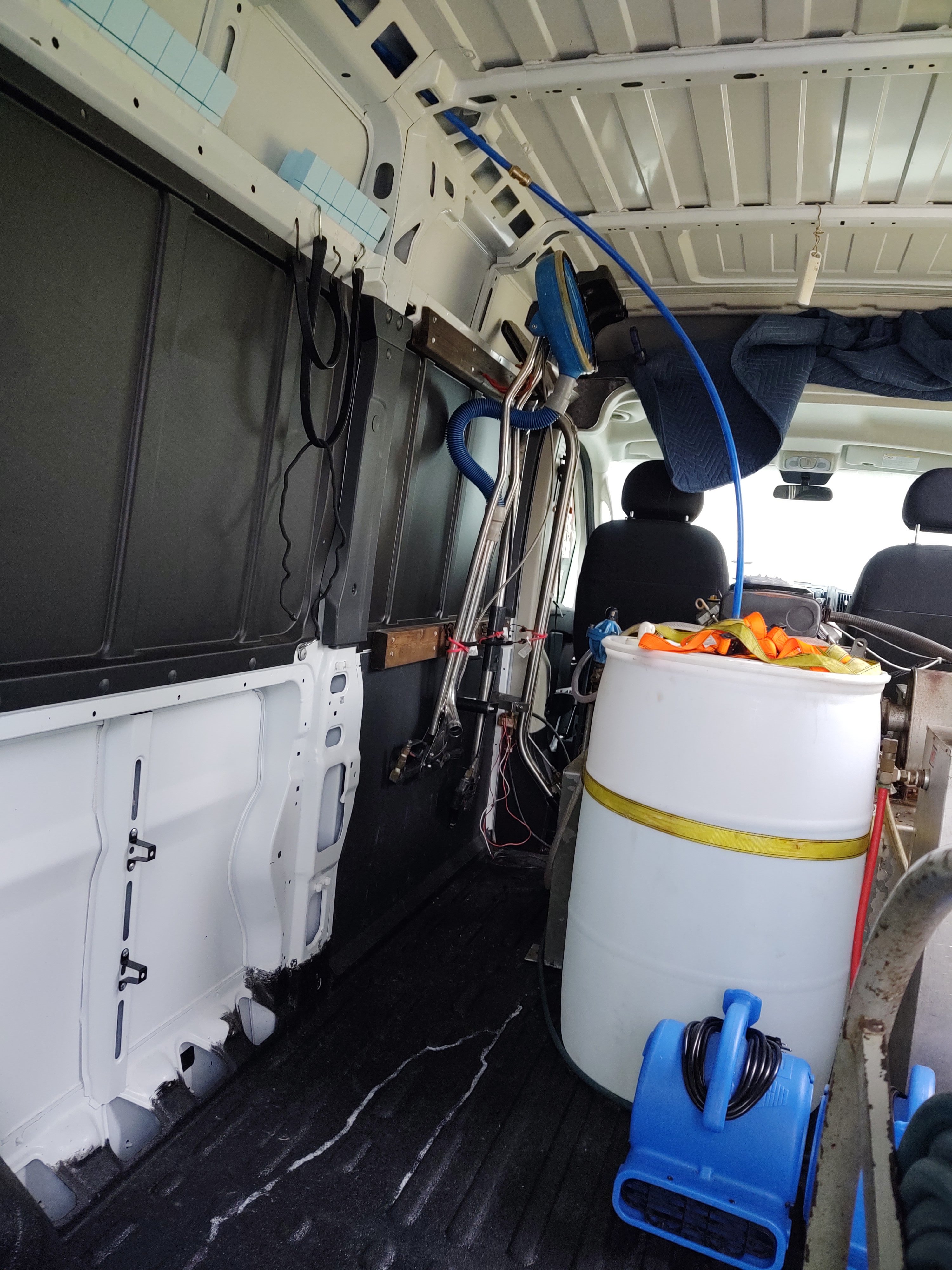

Ok what is the trick to getting the white soap residue off the coated floor??
I should of rinsed as soon as it happens.
But eye didn't.
Presprayed and scrubbed with deck brush then used 600psi to rinse with pressure gun.
1,846
BradFenstermaker
Thanks
So there is nothing that will actually remove it??
I may try some all fiber rinse and scrub by hand with brush.
I have black paint already if all else fails.
Marty you trying to get me to ruin my floor or will that work?

I also did herculiner in my van. It doesn't harden up like the linex stuff.
Next bath day I will try super high ph followed with vinegar and see what happens..
