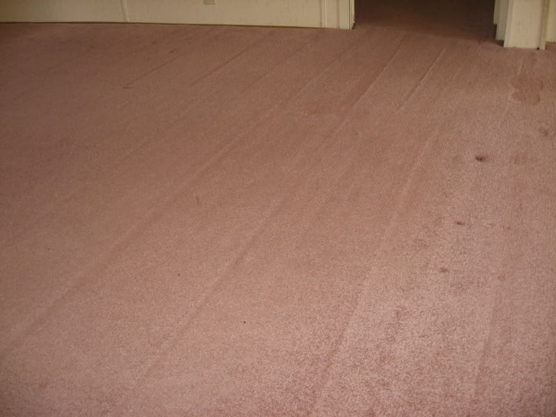

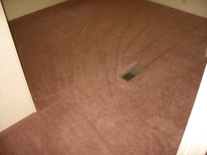

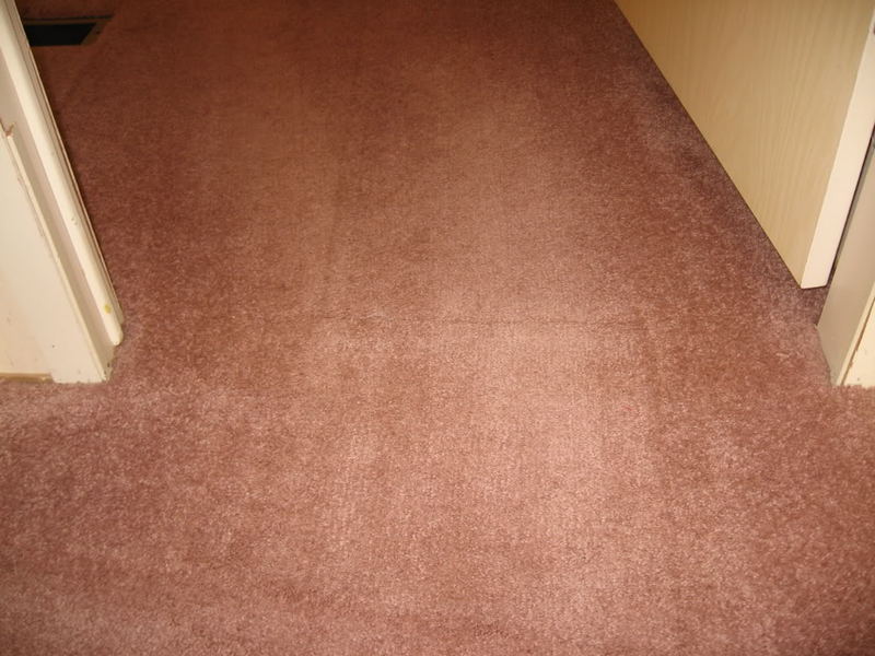

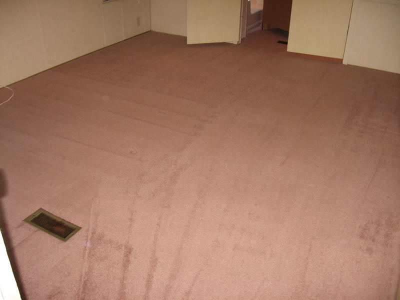

This is a rental of my in-laws so it was a non paying job. Anyways here's some before and afters. I'd say it was a light to moderate soil job. So it got PS, dwell and rinse. There is a lot of wear on it for sure.

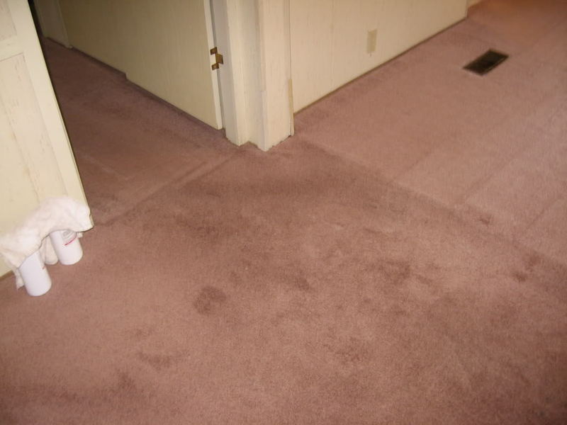

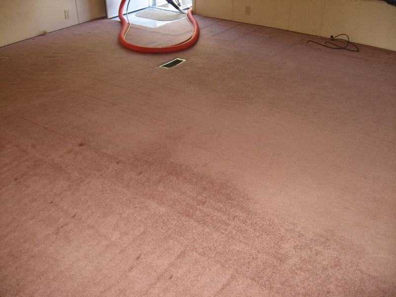

The following 2 show traffic lane grey

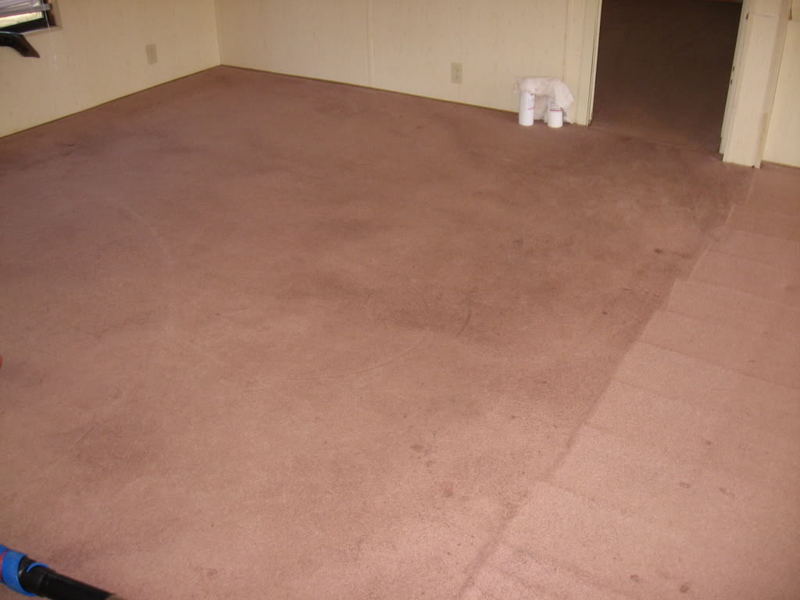

view from other side of previous pic and it's also an after of the 5th pic.
