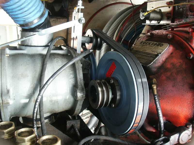

I'm considering the possiblility of adding a tensioner pulley to my blower belt system. This would be an attempt to make belt changing easier. Currently it is a very difficult and time consuming job. If it were only once a year it wouldn't be so bad. My question is where can I purchase these kind of parts. It needs to be wide enough to handle three 3VX belts. Its seems to me that I've seen something on some other TMs.

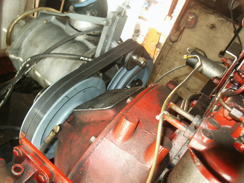

Ron Werner
8,726
Ron Werner
Took a little extra engineering to make it fit but it works great.
Got it from John's Machine Shop.

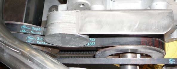

Larry Cobb
5,795
Dallas, Texas USA
Larry Cobb
Doug;
I loved the 30 second belt change.
Reminds me of the constant valve adjustments I had to do on my wife's VW Beetle.
On the belt tensioner ...
We do have a stainless ball-bearing design that mounts on the engine.
It was designed for the flat side of several 3VX belts.
