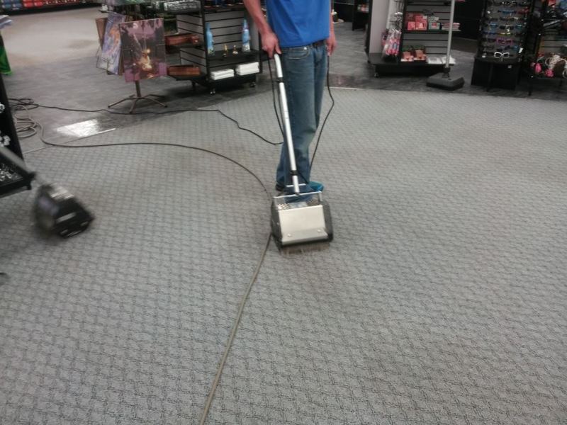

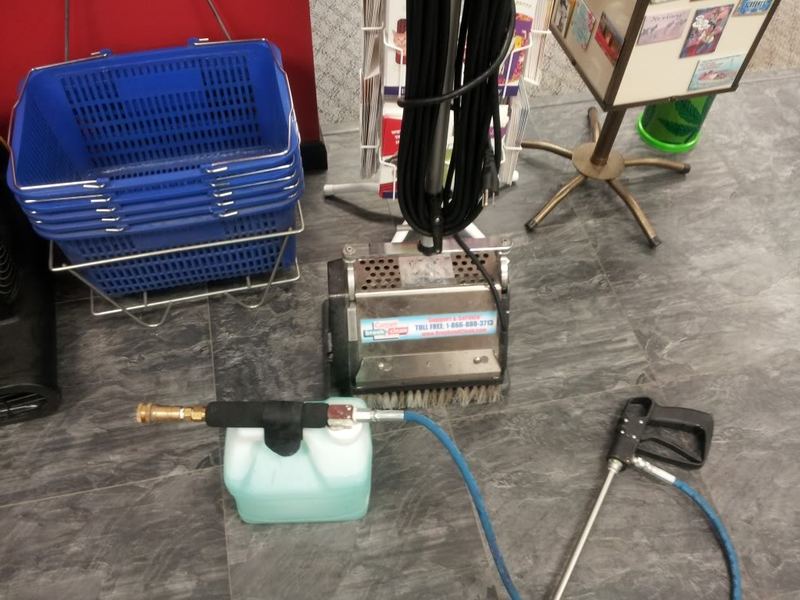

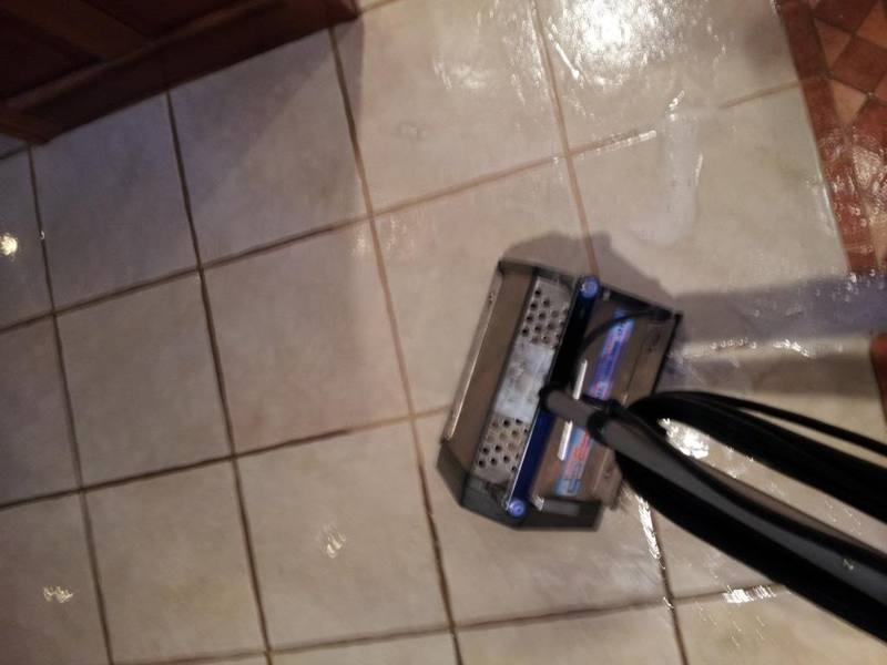

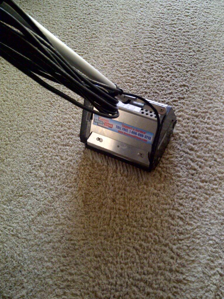

I also have the Windsor drimatics too.
To clean the CRB units in the pics, there are 2 push pins going through the center of the brushes....real easy to push out and the brushes drop out for easy cleaning.
We sometimes just spin the units backwards from the normal rotation and things come out easy.
For the Drimatics, we were using our suction hose from the truckmount to also suck out the junk and clean. Every now and then you do need to pull those apart and get the gunk out and relube the ends where the brushes go.
These Other CRB units are way better I can tell you.
