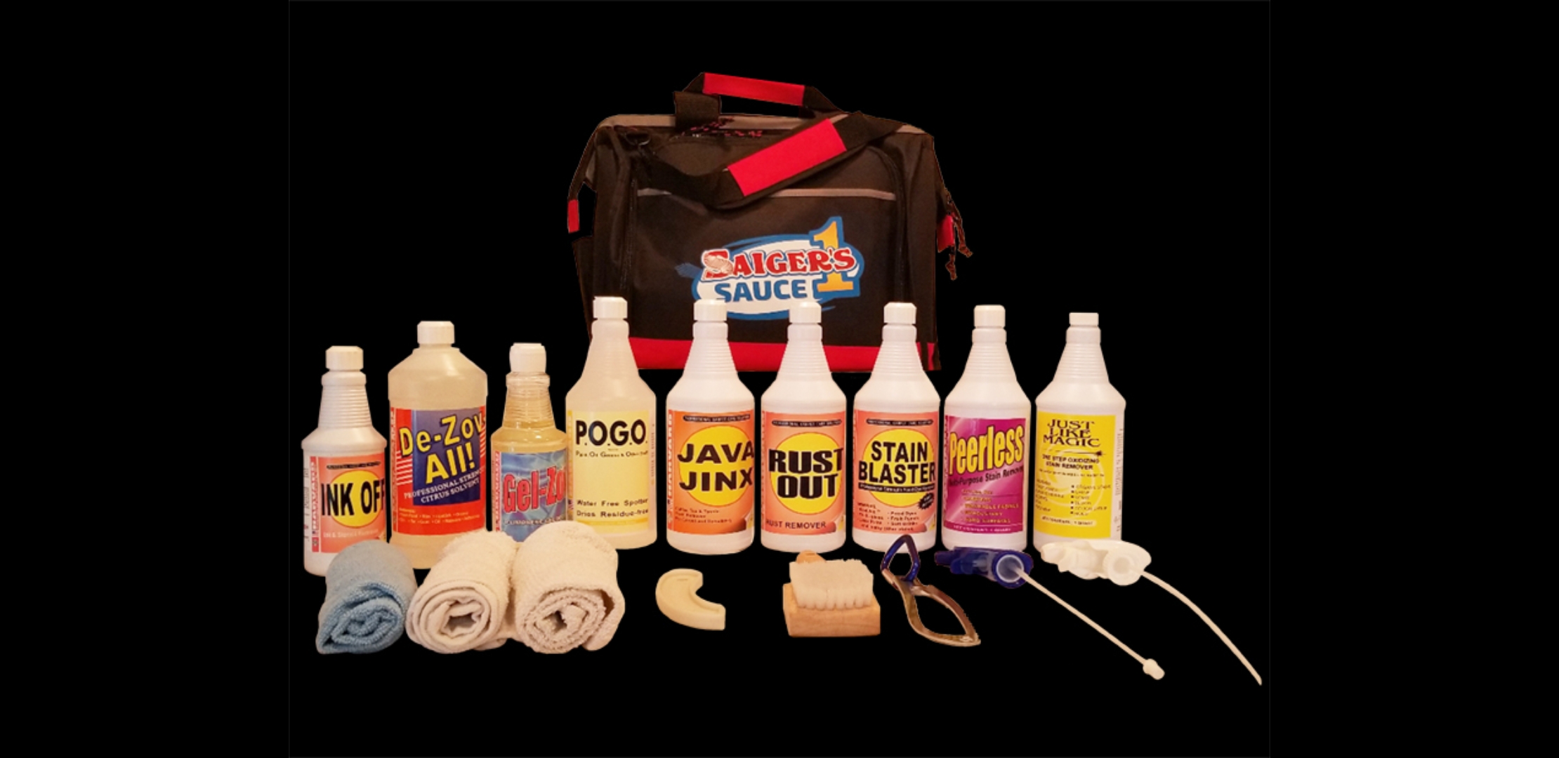

Harvard Stain Blaster works for us.
https://www.saigers.com/supplies/category/spotting-kit
Harvard was one of the original companies my understanding to come out with the first red heat transfer Chem
https://www.saigers.com/supplies/pr...l-aid-and-red-dye-remover/category_pathway-14
https://www.saigers.com/supplies/product/stain-blaster-12-x-1-quarts-case/category_pathway-14
http://www.jondon.com/harvard-chemical-stain-blaster.html
