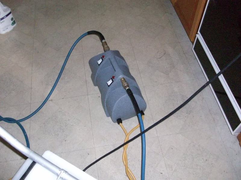

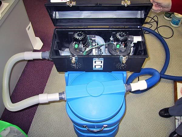

Here's a 7 cord set up. Only 3 for machine and 4 for heat. I've done it a few times and always live in mortal fear of a power surge.
2 plugs for base unit- 3 vacs, 600 PSI Pumptec.
1 plug for vac booster
First 3200 watt heater
Second 3200 watt heater. The water gets screaming hot on one, two really doesn't make any difference unless the wand is keyed for long periods of time.
No blown electrical, but I ran 3 cords into the shop. This was a buddy's house and I just was playing to see how much I could squeak out. I've also done this setup in an office as well.

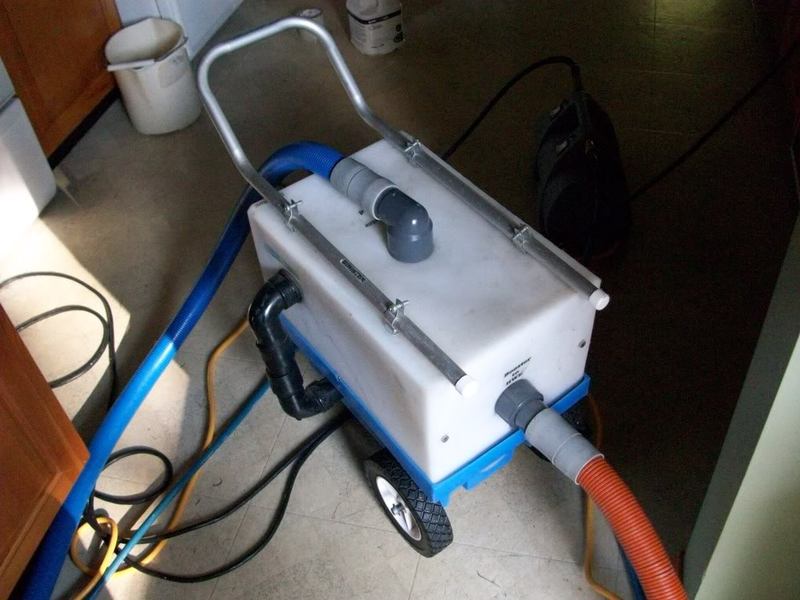

And here's the quad vac setup I had on my old Ninja, with a big azz old General pump, pegged out at 500 psi. It was a 3 cord setup, but AWESOME power:
