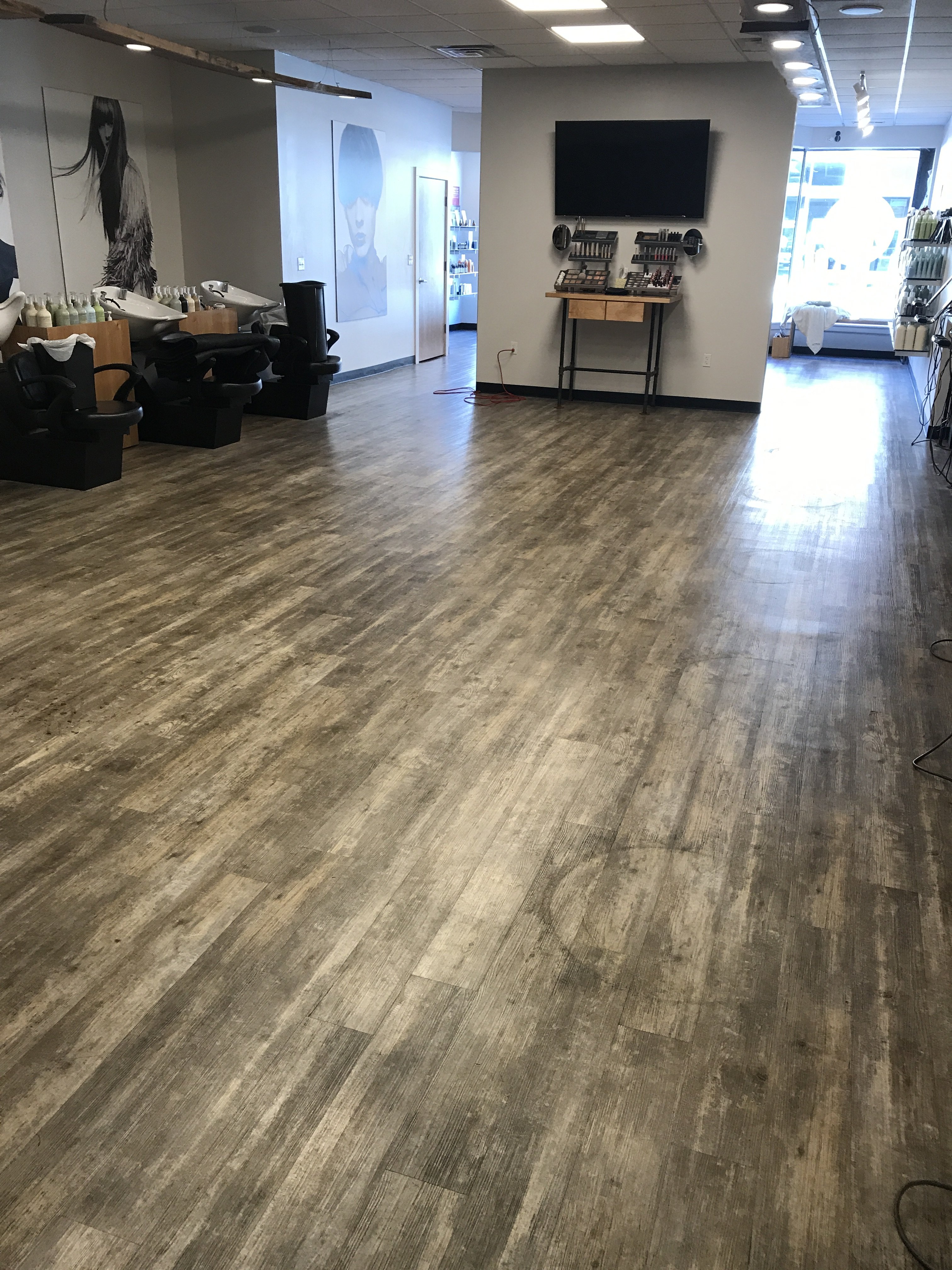

I bid on a 1200 ish ft.² salon today. It’ll probably take a while to scrub with my 10” CRB, before rinsing with the tile spinner. I plan on using Code Red for chemistry.
Is there a brush that might scrub into the grooves in the LVT, that I can get for my 175 or Cimex?
Should I just suck it up with my widdle CRB?
Any other ideas?

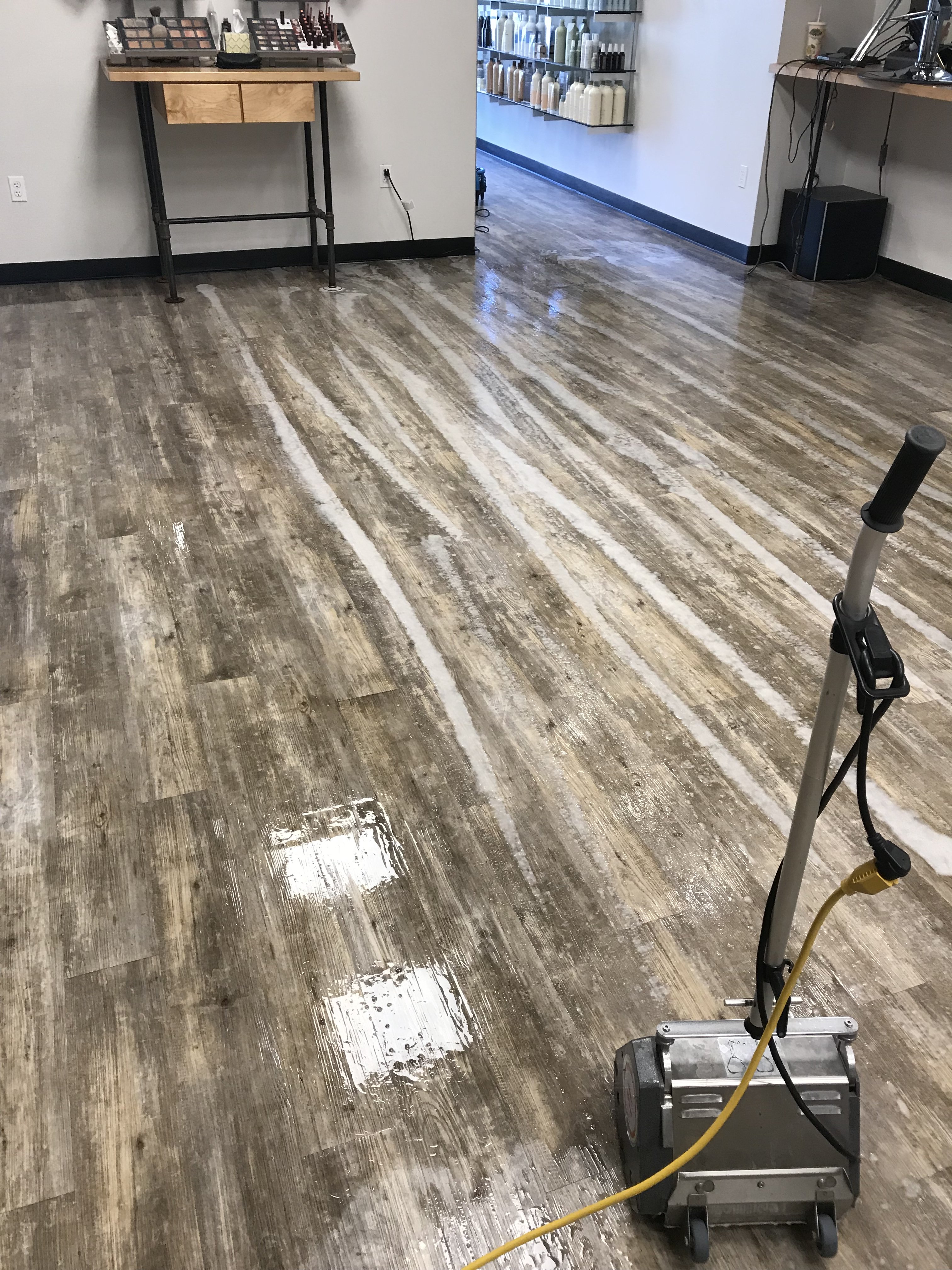

Well that was a piece of cake.
I mixed the Code Red heavy in a hot mop bucket and just watched the soil melt off and was scrubbed with the CRB and held in suspension until I rinsed with the Devastator Wand.
Thanks for the tip guys. That was the easiest money I’ve made in prolly a week :biggrin:
