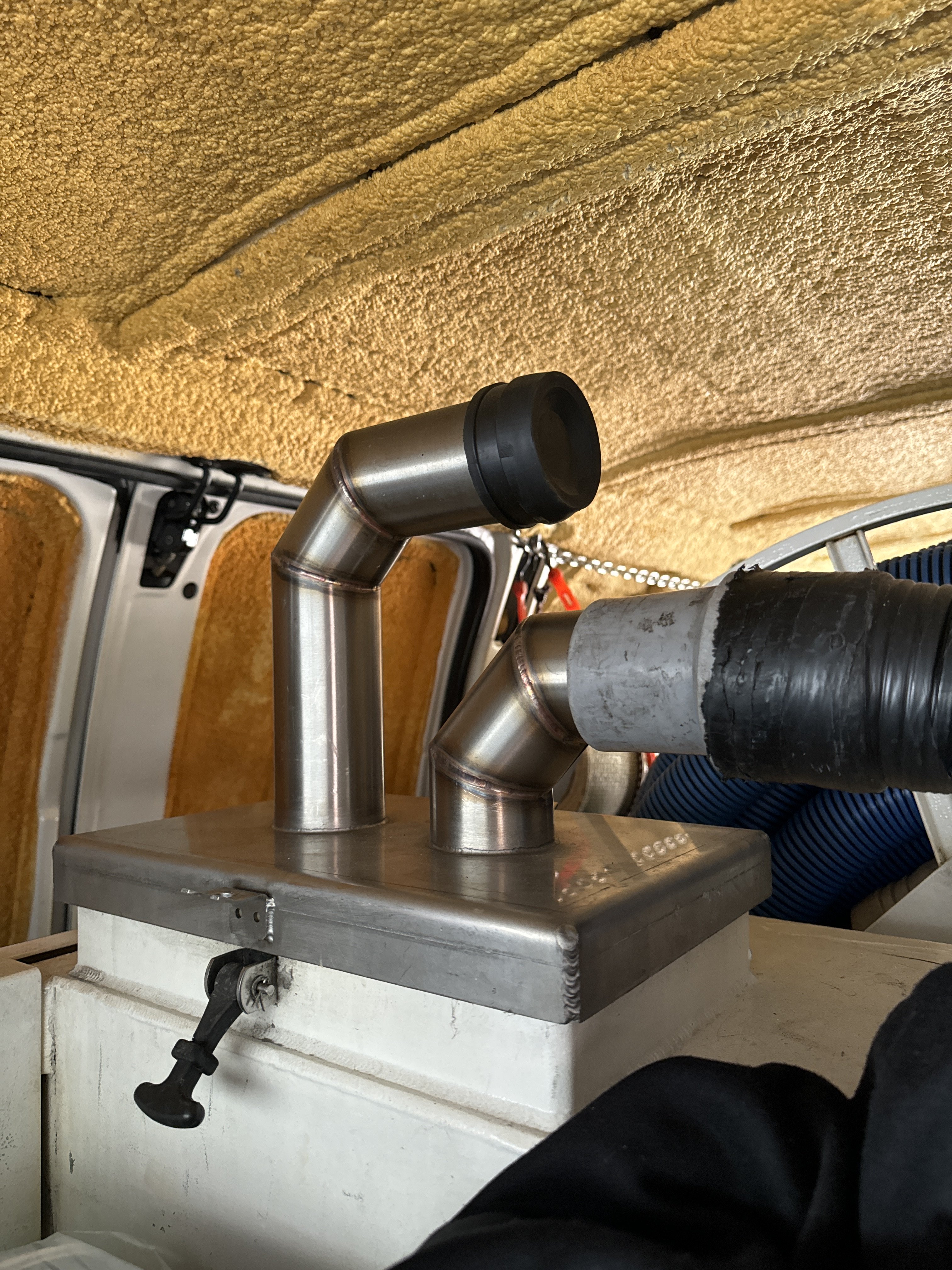

I did 3 jobs today, all in a higher end neighborhood.
2 jobs I ran 175’, and the third was 225’.
Now I run a supercharged mid level TM (47 blower, Cat 5CP pump).
By supercharged I mean I run the TM 600 RPM’s above recommended. (2850 recommends, I run @ 3450).
I also have a custom , stainless steel waste tank lid W/ 2.5” ports.
My first 50’ is 2.5, then I reduce to 2” for the remaining….
Everyone told me that running it like this would cook my blower, WELL….. that was 8 years, and 6200 hrs ago.
I do NOT regret running the system I have, and can EFFECTIVELY clean up to 450’….
