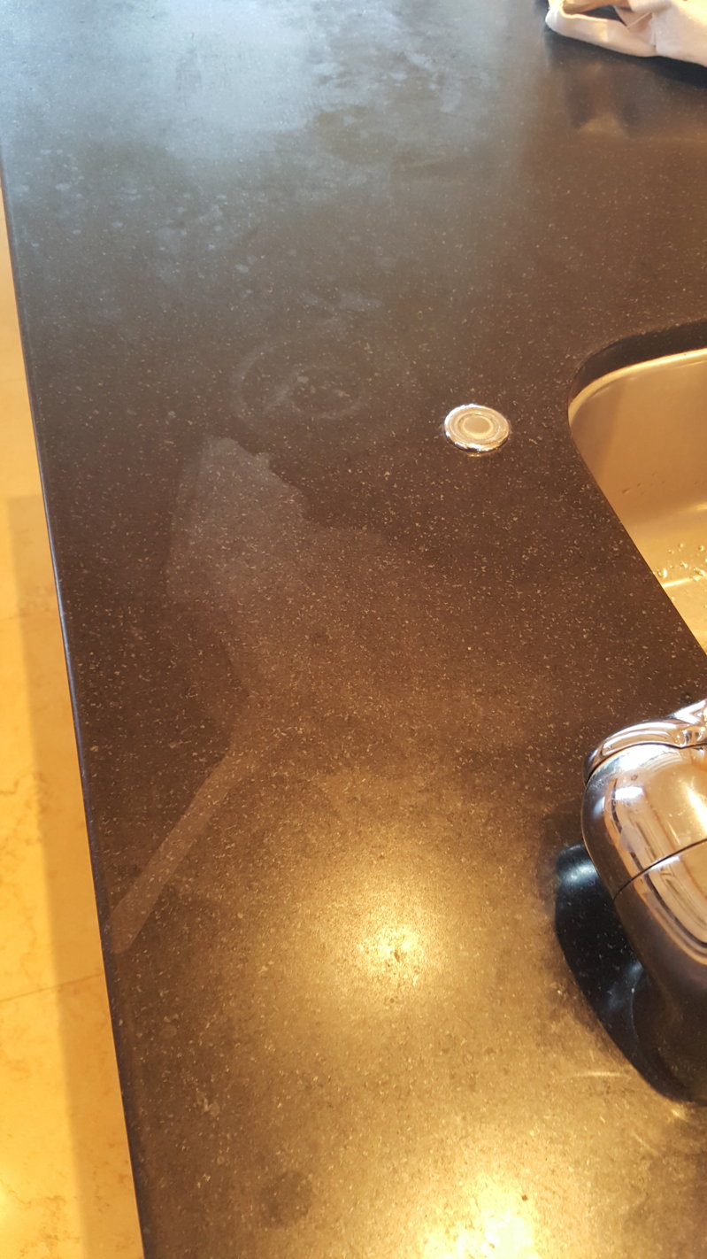

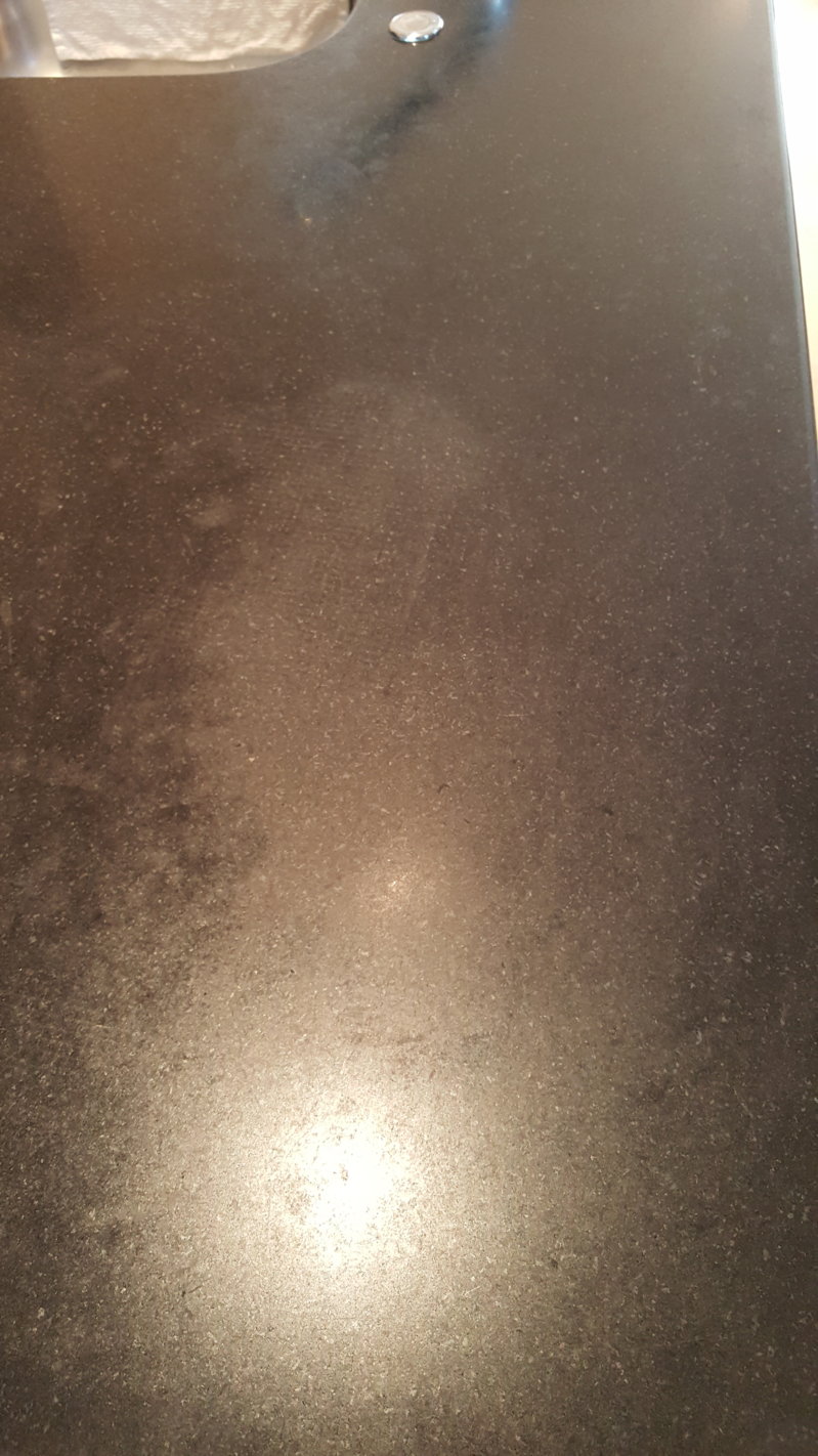

That looks like black absolute honed-it has a color enhancer on it-thats whats etching and degrading.
You can use a honing powder from 150g to a 280g range to remove all the residues of the enhancer.
Then give your client an option to color enhance or leave natural.
We do a lot of black ab here in the city-sometimes busy kitchens are better left natural.
If you give the client sound cleaning advice they will do well with honed black ab.

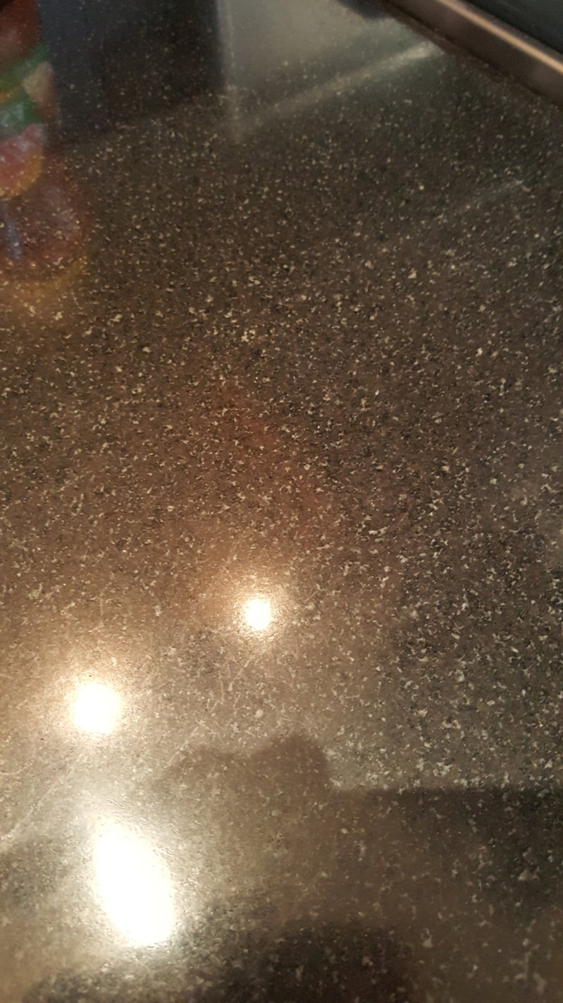

The grain structure sure didn't look like Absolute.
Never seen the sort of "etch" damage one one either...It's twenty plus years old so I doubt it's been died.
The house keeper says she "oils" it frequently till try and hude the stains/etching or color loss if you're correct, with no success

this is a version on BA they sell on the market, but it is not the original Indian Premium Black. This is a version they dye to achieve the black color and it etches fairly easily. So when you successfully remove the etch marks and restore the polish, you will often be left with a dark gray color instead of the deep black. The larger white speckles is what gives it away to being the cheaper version. This stuff is a nuisance and the only way to be sure it turns out evenly IMO is to cut the entire thing down and bring it to a honed finish, then use an enhancer.
You can also re-dye it with Tenax Uniblack or Tepox V, but there is no guarantee that it will be even and not splotchy

Yeah we have had a few of those dyed slabs. The dye etches .
You can use an acidic compound(5x or MB12) to pull the dye off in some cases and just color enhance.
Or like cam said cut it down-color enhance.

BA is incredibly dense, so not far. A fraction of a mm I would suspect. You can redye it with Tenax Uniblack 1, or Tenax Tepoxy V. Uniblack 1 will need to be periodically maintained with Uniblack 2. Tepox V is the stronger, resin based dye. They say to mix with Ager, but DO NOT do that. It coagulates.

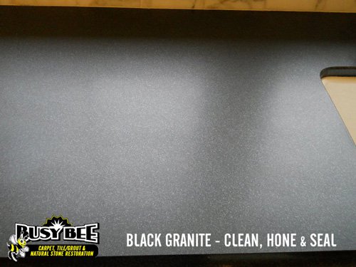

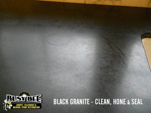

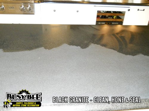

Here's how these come out looking Mike. This job was a referal from Stu several years ago (Thanks Stu!). I honed with 200 and 400 honing powder and enhanced with STT CE
Reactions: Jimmy L

I can't take all the credit on that one, the customer was a Brain Surgeon at UC Davis and he demanded that I took a similar slab (4x4) and tapered off 6 different sealers to determine the best as he poured booze and milk to test....so I was really under the gun LOL... Stu guided me through it :)

STT CE won over over Aqua Mix Gold, Stone Pro Ultimate Pro and some others I cant remember...I think the MB-22 is similar to the STT CE? Stu or Cameron could chime in on this :)
