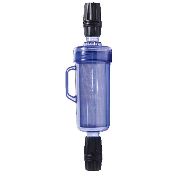

How many cfms are lost due to the restrictions of a blower filter? Seems like a lot. Looks very restrictive. Would it be better to have 2 pool filter types inline? This way seems to allow the blower to maximize air movement in the tank.
Am I over thinking this? Does it really matter where the filter is placed - before or after the tank.

I didnt mean pool filter literally .. sorry ..
This is what I use with the stainless screen .. I was asking if 2 before the tank would be better than using the one plus the use of a blower filter - to create more vac pressure in the tank.
One of those pool filters is way more restrictive then any blower filter (at least on Prochem tm's)should be.. I run filter less EXCEPT for the blower filter. My vac is always the best it can be..

I would dump the pool filter and get yourself a Devastator Filter, and KEEP the blower filter! there are many other ways to increase your CFM, the type of vac hose you use, the type of connectors you use on the hose also can effect your CFM and how your vac hose hooks into your waste tank will also effect your CFM. But always leave your blower filter in place, even if some board guru claims they have ran that way for years. To me that filter protects a major part on the tool that you use to put food on your table to feed your family.

As far as Dev, SS CDV, Rc filters vs the other smaller filters, there size is where they shine, a smaller filter flows pretty good actually when clean, more than enough when wand is on carpet, the problem is it only takes a cup of debris to start to affect its flow, they are affected much much sooner.

Some of the smaller filters don't even need a cup full of debris to become restrictive.
They flow nice till you add a little turbulent prespray laden rinse water and airflow drops off the chart.
That is why you see guys having to run two of them to keep airflow at a premium.
