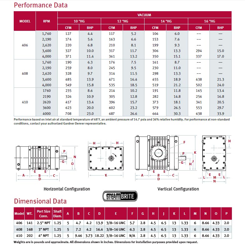

I’m hoping to learn the factory set RPMs of the blowers (and engines) on the Prochem 370, Peak 500 (same blower as the 370 but better air flow) and the 650.
Can any of the three be spun slightly faster through engine speed or pulley changes to increase airflow, preferably without causing long or short term damage to any of the components?

sapphire 370ss 3402 RPM (GD TI406)
peak 500 3402 RPM (GD TI406)
Everest 650 3125 (GD TI408)
Thanks Fred. Am I mistaken that the Peak set up moves more air than the 370? Just to double check, the 650 is a 408, not a 410? Can any of the blowers spin a bit faster without damaging the blower and improve performance?
410....I put 408 by mistake....will edit
you could provided the horsepower is still there at the desired RPM. The increased load/heat/etc would likely wear out components faster

I've read on old posts of some of the garage builders running 10% over
when you consider that these blowers aren't made specifically for this industry, and the hrs they run nonstop elsewhere 10% over sounds feasable

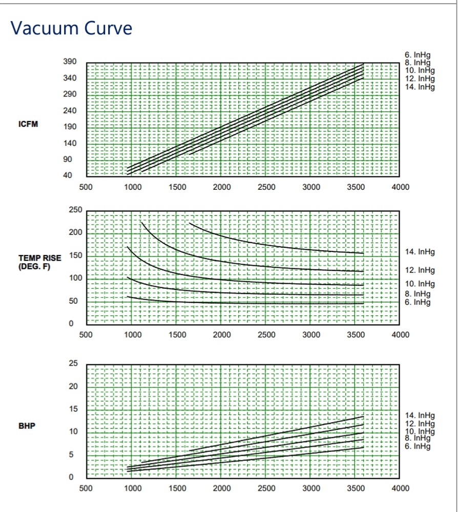

NO. The faster you run a blower the hotter its exhaust, largely due to the compression of exhaust gasses.
again only going off what I've read from old posts.
but thought the rationale was higher airflow less chance to pick up blower heat, therefore cooler?
higher Hg the blower is working harder (more heat) less airflow (more transfer of heat) theories are wonderful things
I think Lee is talking about the actual temp rise of the blower and you are talking about the velocity through the heat exchanges allowing less time to give up heat..
maybe I'm misreading the heat rise chart on urai 45?

If you restrict the exhaust of a PD blower the temperature rises proportionately. Thus many post blower designs severely do just that.

I’d love to hear of plumbing restrictions that could be changed on the 370 and 650!
The only restrictions that those two models have is the first 50ft of vac hose connected to the tm. Just get 25-50' of 2.5" hose if you're looking for more suction. Other than that...adjust the hg up to 14" from it's current setting, and get a rpm gauge for the 370 to make sure it's set at 3k rpm on the engine. Suction on those two truckmounts is very good as is. I've seen both directly on the job. No need to do any more
