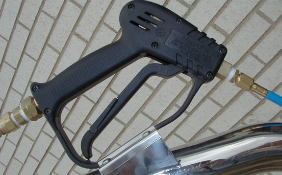

I would look @ the method of mounting the gun before you consider it.
We have several customers who have broken the gun, because of the mount at the thinnest upright section of the gun.
Tomorrow, I can post a picture of the mount system if you want to see it.

Wand Valve Photo
I would change a couple of things on this wand:
1. Attach the valve at a stronger section of plastic.
2. Increase the size of the line from the valve to the jet bar for less pressure loss.
(Compare the 1/4" QC to the crimp on the hose).
Larry Cobb
