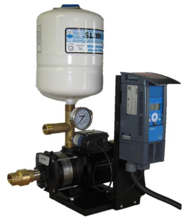

The TW1000-30W-50 Flag Frame Booster System (Shown above) is equipped with a centrifugal pump regulated by a variable frequency drive that controls the pump operation to maintain constant pressure regardless of varying demand or fluctuation in incoming pressure. This system will supply 30 GPM with a 50 PSI overboost.

The suction (inlet) on that pump is 1-1/4". If your domestic water piping isn't at least that size then you probably won't see 30 gpm. And the description matches my earlier comment that the pump's function is to maintain pressure, not boost flow. Same suggestions as before. Not a bad looking setup, though.
