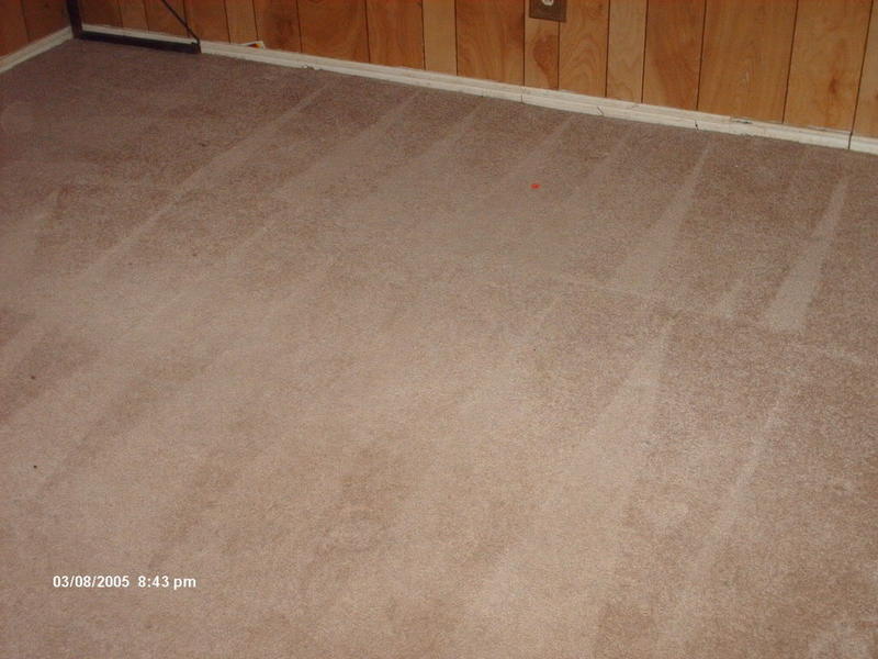

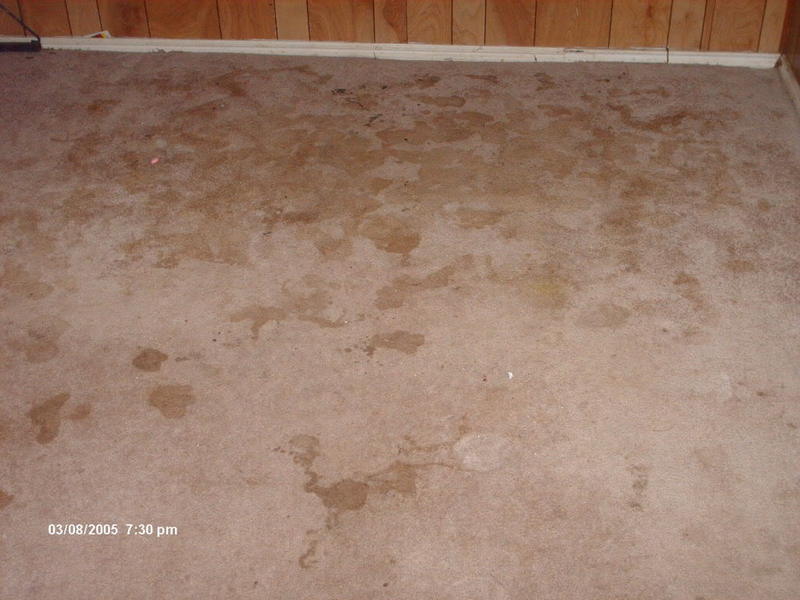

I used it on a pet stained carpet that was so bad. the reason I was there was becuase child protective services was ready to take the kids. And turned out pretty darn good, the only draw back was powder residue left after dried.
after with Bridgepoint with Hydrocide, dumped on after mixing in bucket, scrubbed in, water clawed out whole area, and then cleaned with regular pre-spray.

Remeber this was just to get the child protective services off this guys back, and I did a for a cheap price, very cheap, and all while the guy let his kid run all around me while I was doing this too, hence the crayon piece and other crap already on the carpet after just being cleaned .
