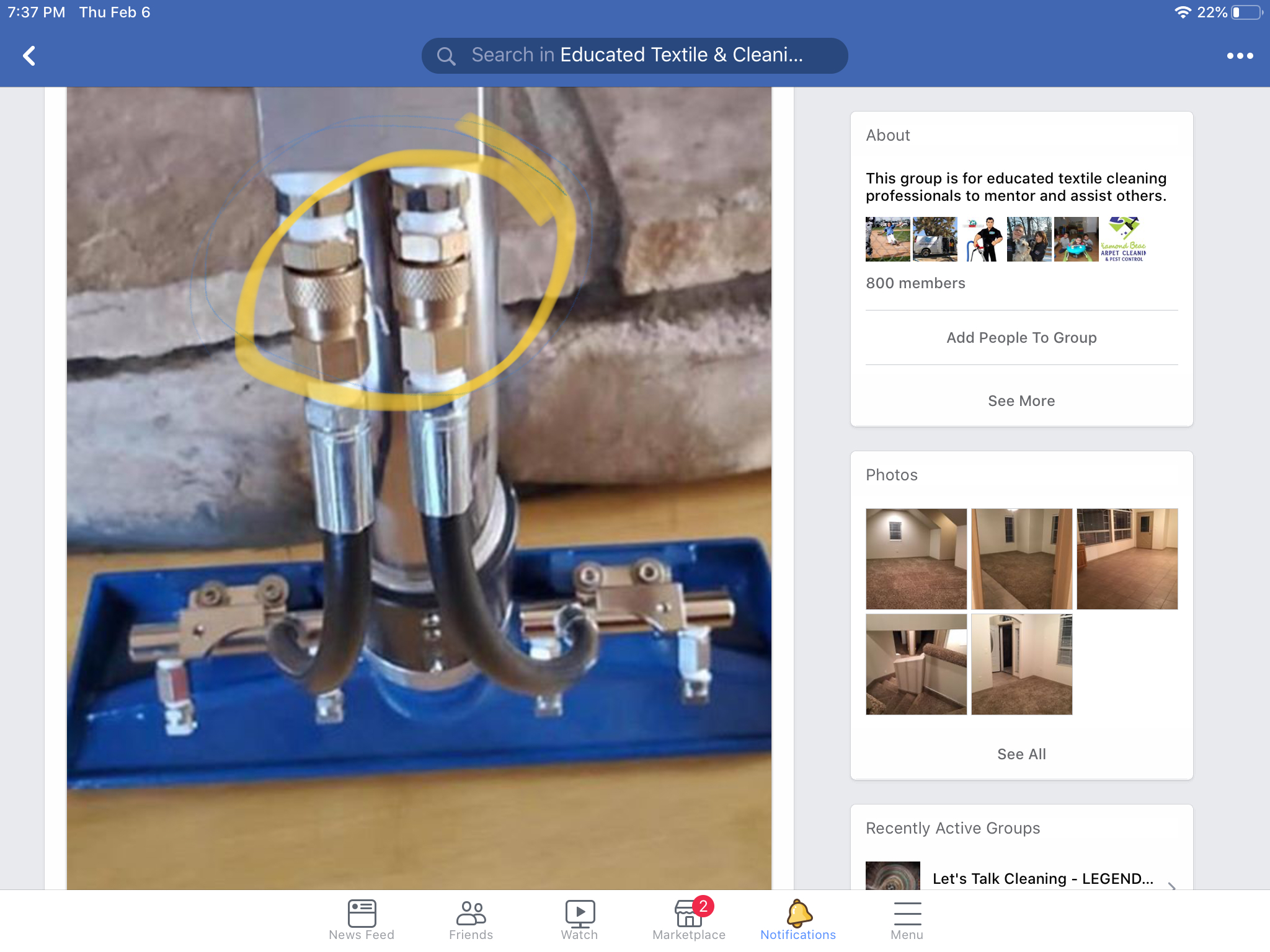

My dev 14 has a bad leak in the brass water area quick connects need to order more quick connects
messaged Tom just wondering if these are available anywhere??????
11,536
Thats a dang wand not a tom wand and its not the wand with the leak used for illustration purposes only.

Try pressure washing outlets. Looks like an open flow QC. Maybe even home Depot.

If there open flow 1/4 inch home depot should have em. In a pinch sometimes you can flip em around and put the worn side down and the good side up.

They are on the web site, $42 for two pairs.
Thanks I found it needed a new slot glide too.
Is there something in should do to make these brass disconnect last longer? Wd40?

Superlube. Either in a spray can or grease in a tube. Part of regular maintenance.

Because the couplers are NOT repeatedly uncoupled there is likely very little metal to metal wear.
It's all o rings.
11,536
I ordered new ones from the website I also needed a new slot glide for my 14 inch dev
