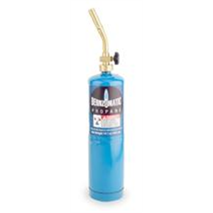

I s this somewhere you can take a propane torch to them. A couple heat cool cycles and your other methods should work.....

pick up a torch...works abosulte wonders on stuck exhaust components.............

if you gonna heat it ...heat around the stud without heating the stud as that would cause the stud to expand........
