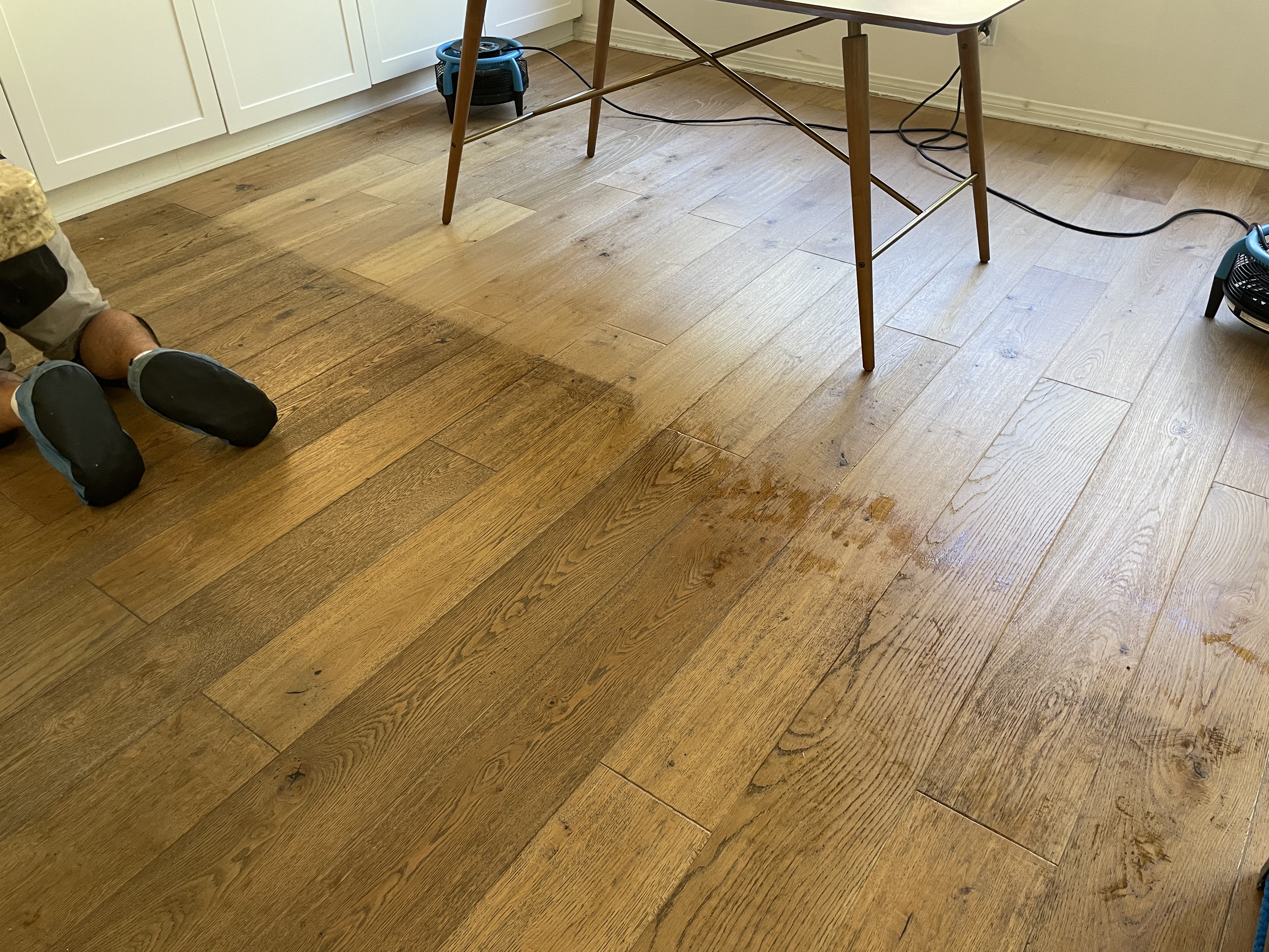

I know I should post this in the hard surface section but there’s more people on here so here we go.
In a pinch is it OK to use a brush pro 17 to scrub out hardwood floor with basic coatings IFT, It’s really dirty!
Then rinse and extract with gecko brush head and temp turn down and pressure 300psi using basic coatings squeaky.
TIA
116,449
You certainly can assuming there's no issues with water intrusion and potential swelling or water staining.
If all the joints are nice and tight and the original coating is all sound, then go to town
Work in 100 to 200 ft areas at a time to play it safe

That’s exactly the plan and I use dri pods to immediately dry and I actually do it in 50 square-foot increments
Wood floor cleaning’s fairly new to me about six months typically use the Oreck orbiter but on real dirty wood floors or acrylic wax removal it just doesn’t do the job and I was able to rent the brush pro.

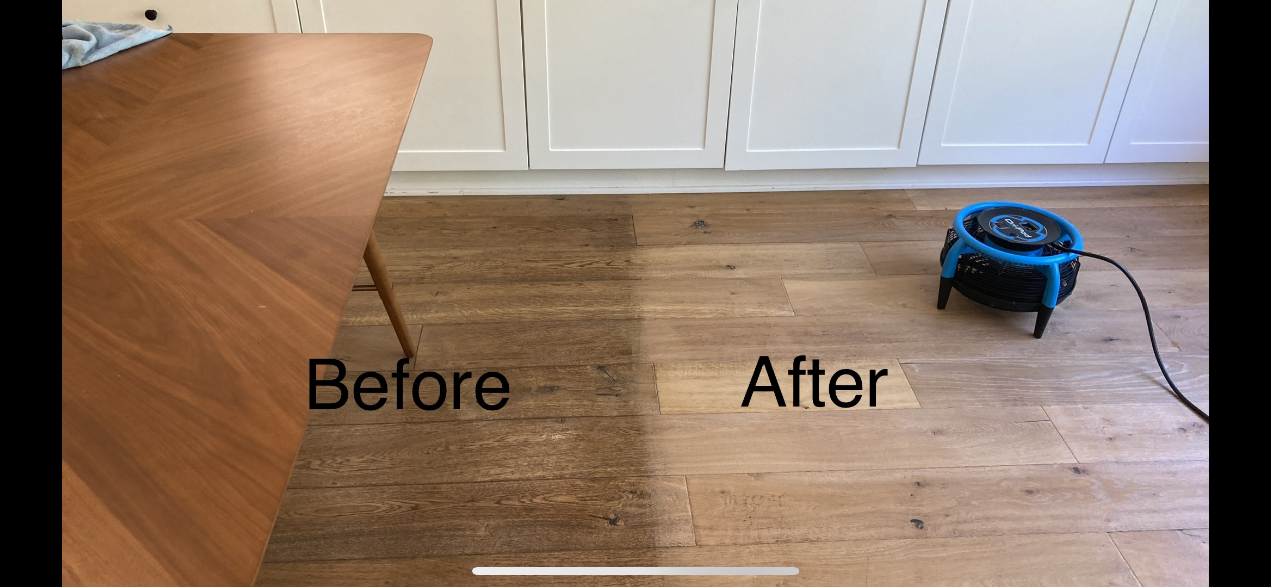

Demo spot with oreck orbiter black carpet brush and basic coatings dissolver, then rinse with squeaky and dri pod.

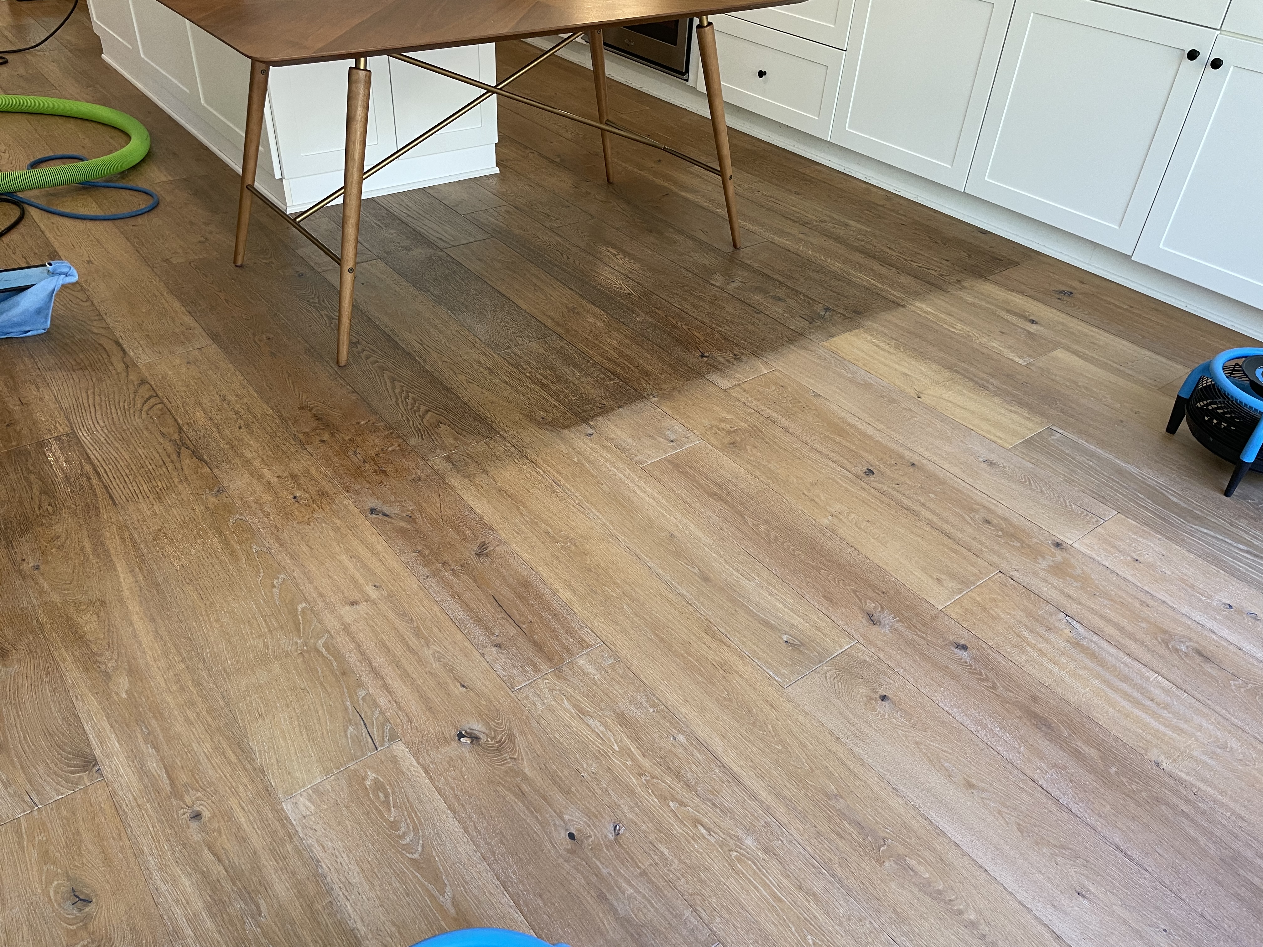

Brush Pro killed it!!

IFT is a perfect cleaner for filthy wood floors (as well as LVT / LVP). And then follow up with Squeaky. Keeping your moisture level under control is paramount for wood too, but it looks like you have that well in hand. Nice photos by the way! We started selling a few of the Basic Coatings items. Our customers love their wood care products! https://excellent-supply.com/collections/basic-coatings
