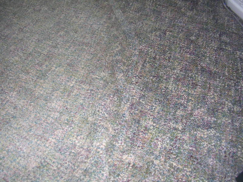

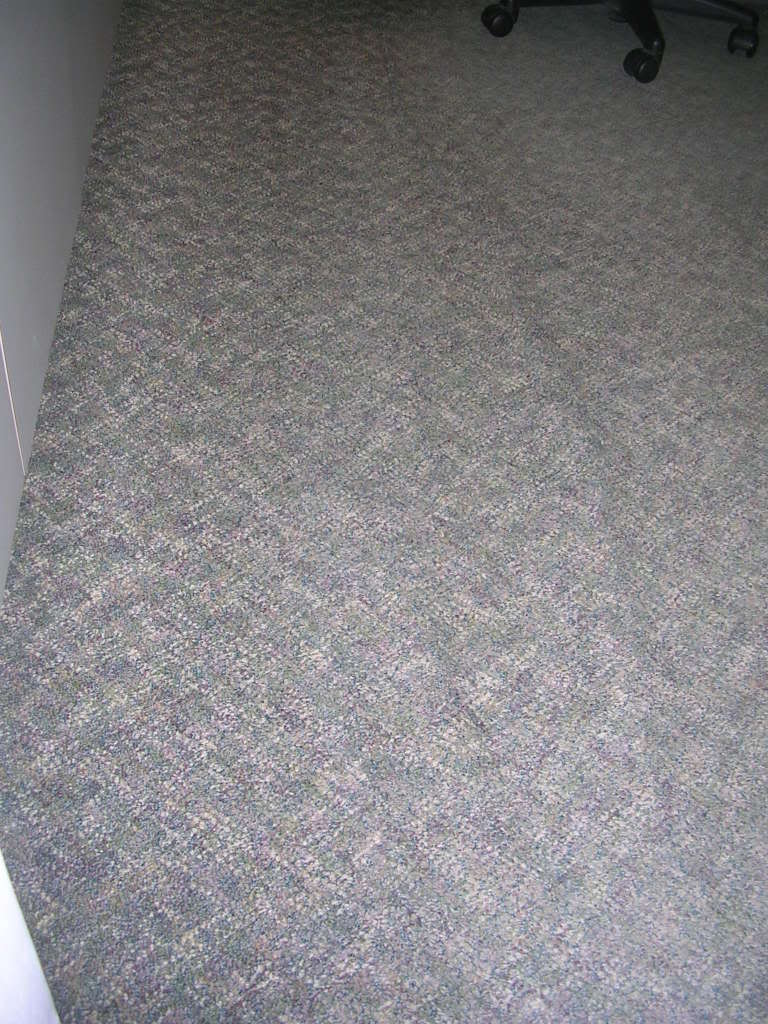

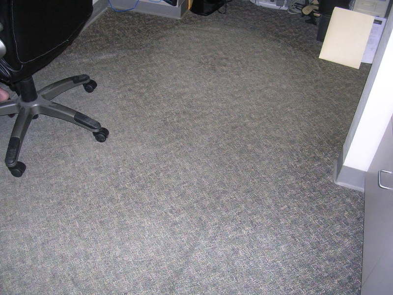

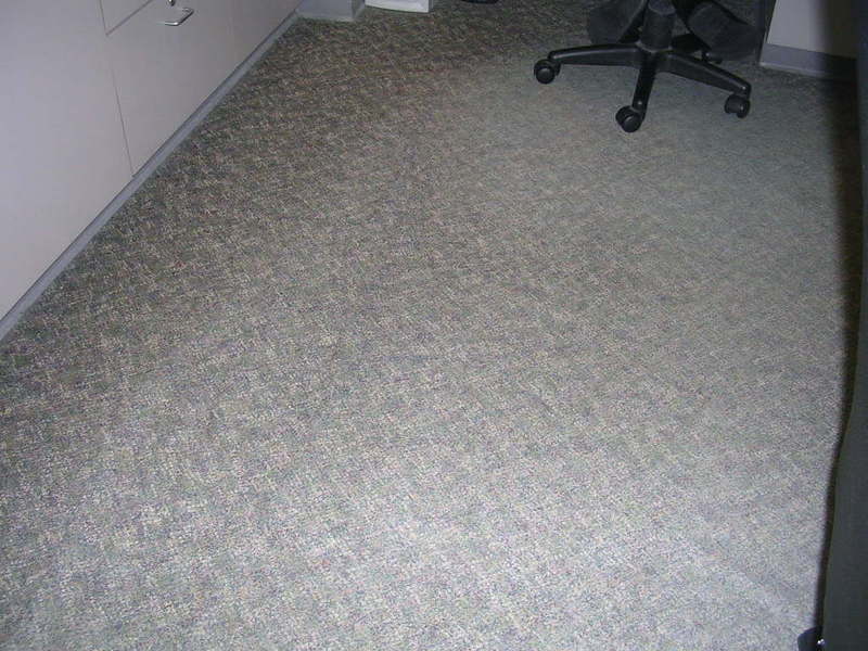

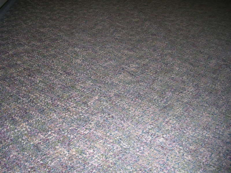

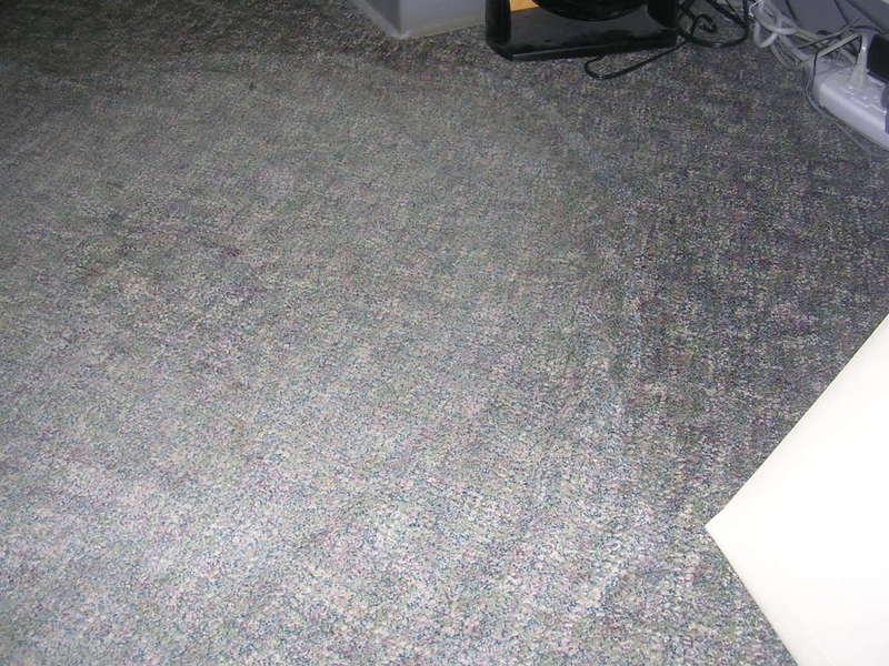

OK guys I need some help on how to tackle this repair. This carpet is is a Doctors office where the receptionist and billing clerk sit. I think the carpet is a looped type glue down and it seems to be stretched out from the chairs rolling around on it. The waves (1 to 2 inches tall) in the carpet are mostly on 3 sides but they pretty much circle the office of about a 8 X 12 size. Can this be lifted up stretched and glued back down? how do I tackle this?

aside from replacing it there is nothing that you can really do to fix it..the backing has probably torn away and it has no hope....educate then on chair mats....

First thing is The carpeting does need a chair mat. You could pull the material back inspect it see if the backing is coming off. If it is slice the secondary backing only .You can re latex it let it dry overnight than, powerstretch it.
Stevea
Feb 3, 2007
436
Rolling traffic on tufted carpet will delaminate over time. First, test it to be sure it is delamination, (pretty obvious this one is) and then reverse what occurred, re-laminate it. Small or large area, as long as you can get to it, it should work well.
Harry said is well and to the point. One thing I might add, by putting another backing over the area that one would re-laminate, this will re-enforce the carpet and help resist the rolling traffic and give it a little more 'body' to work with, when you put a chair pad on it.
