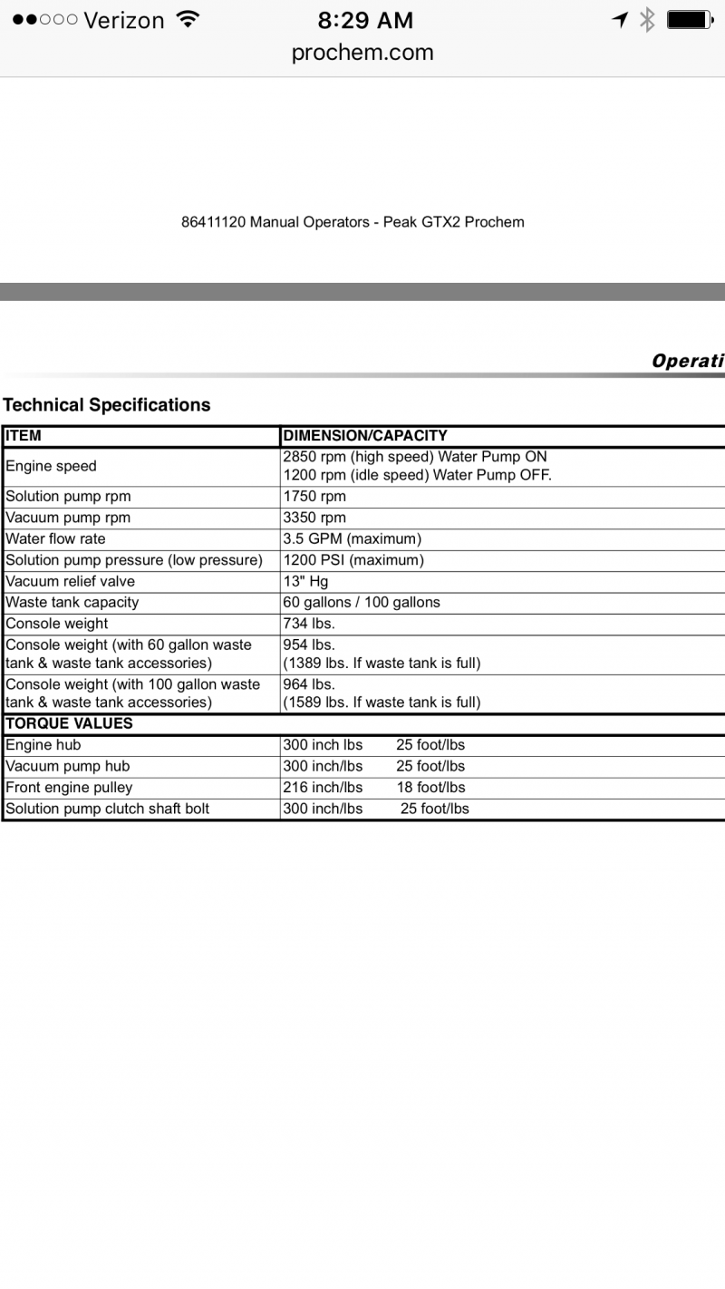

J1940 Power hp(kW) 1 25 (18.6) ...........................This is your hp
Displacement cu in (cc) 45.6 (747)
Bore in (mm) 3.3 (83)
Stroke in (mm) 2.7 (69)
Peak Torque lbs. ft (Nm) 41.2 (55.9)
Compression Ratio 9.1:1
Dry Weight lbs (kg) 105 (48)
Oil Capacity U.S. quarts (L) 2 (1.9)
Lubrication Full pressure w/full-flow filter
Dimensions L x W x H in 14.6 x 17.7 x 24.5
Backpressure Limit 2 50
J1995 Power hp (kW) 3 24.7 (18.4) .....This is what your getting at max 3600
J1995 Rated Speed (RPM) 3600 ............. I believe 3600 rpm is what the motor is ran at to get the max hp rating of 25 hp, if you are running at 2850 I do not believe your motor is producing 25 hp I think it will be less than that
I can't find specs but I think a #4 blower can take @ 18 hp to hold at 14-15 Hg but Prochem knows that it is not really going to hold 14 Hg on carpet more like 10hg. At 10 hg the HP needed drops way down, this is why they can put a high Pressure water pump #4 blower on a 20 hp motor.
Mine does fine with the increase, but when doing CGD carpet where I get really good seal you can really here the motor working much harder because I have also cranked down my vac relief it opens at @17-18 hg when you cup the vac port, when I do that the motor really can feel the load
These numbers are not exact just trying to recall out of memory when I was doing mods to mine.

I was just looking at the numbers, and asking how they did it?! What size do you think they went with Tom?
