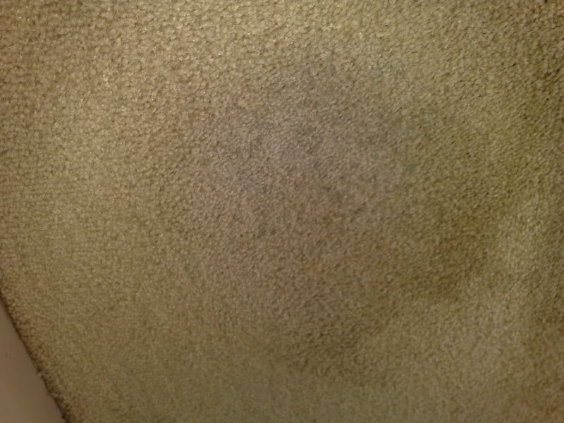

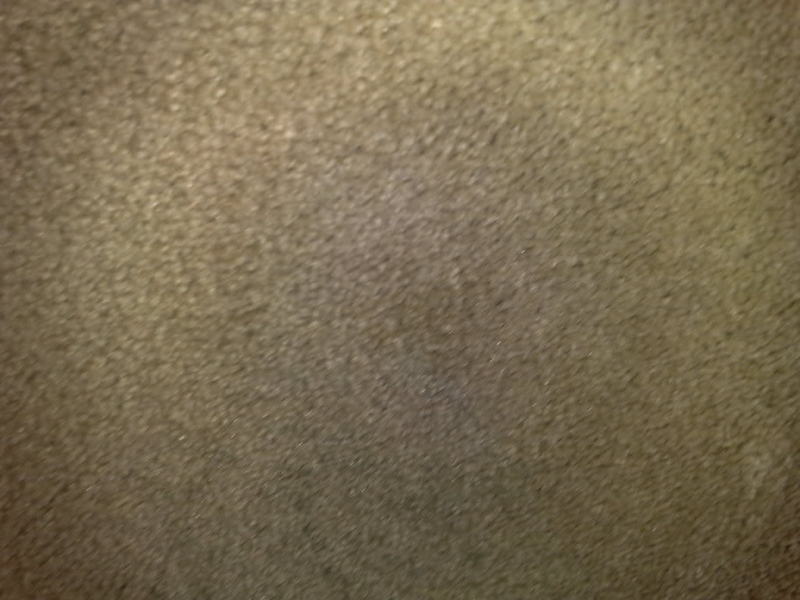

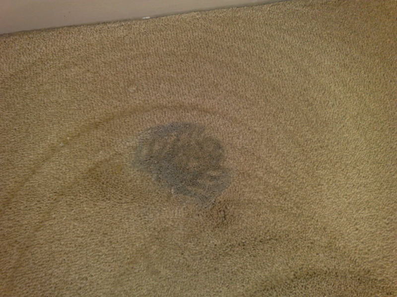

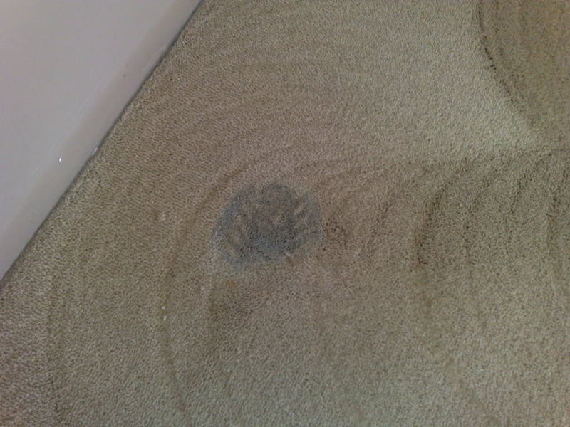

Had a job today the owner is wanting to sell the property and the agent has it open tommorow, master bedroom carpet had a iron burn No donnor capet, no mats,the only thing I could come up with was to crop the area.
I wasnt overly happy with the results but the owner was over the moon.
it looks worse in the photo than it did in person my question is. Is their something that can be used to crop a little more evenly, I know M posted a picture of the machine he uses but it looked rather expensive?

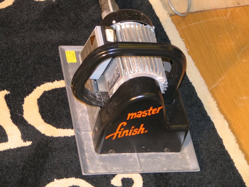

Andrew, napping shears?
The cropper I use is a Munsinger, and last time I priced one in Oz they're around the $5,000 mark. Then, if you want, fit an extended handle and vac unit. That way you can stand up to use it, and not have to vac after. So probably about five and a half, or so.

Just a suggestion, I have had and used these for almost 20 years now and they work great for many portions of repairs. If you get one I am sure you would appreciate what it can do.
Having said that, the use of this with burns will work but there is a much better way. If you use this very much with taking out burns you will probably have some problems since it is a precision piece of equipment, melted plastic is very hard and tends to dull the blade and other possibilities. It will work but I think for that use you should look carefully at your purchase.

Looks great Andrew and to finish up to perfection you'll be :D amazed how much better it will look after a little crayon work. :)

Hay slow down we did groom the job the customer asked me before I started if their was anything I could do with the Burn when they said that they had no carpet or mat's I said no Sorry, it was only while I was working that Remembered the post about cropping out burns so I thought it would be worth a go. Never tried it before and would never have thought it would be possible. But thanks to you guy's and the tool box it something I will be keeping in mind for the future.

Steve, if you're referring to the cropper in your pic, it's four and three quarter inches (the blade)
I'm using one as well, and find it a little easier than the B&J I also own. It's a six inch blade, and if your not careful, it will take the top off a loop pile going over bumps.

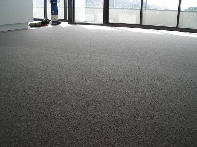

Anthony, just to give you some idea of their uses, this job below was an apartment building, just nearing completion.
The carpet (wool blend loop pile) wasn't standing up to initial wear by all the tradies.
It was fuzzing like crazy, and starting to pill.
We went in, spent about a month going through the building and cropped all the carpet.
The carpet in the foreground has fuzzing (filamentation). The other half in the background has been cropped.

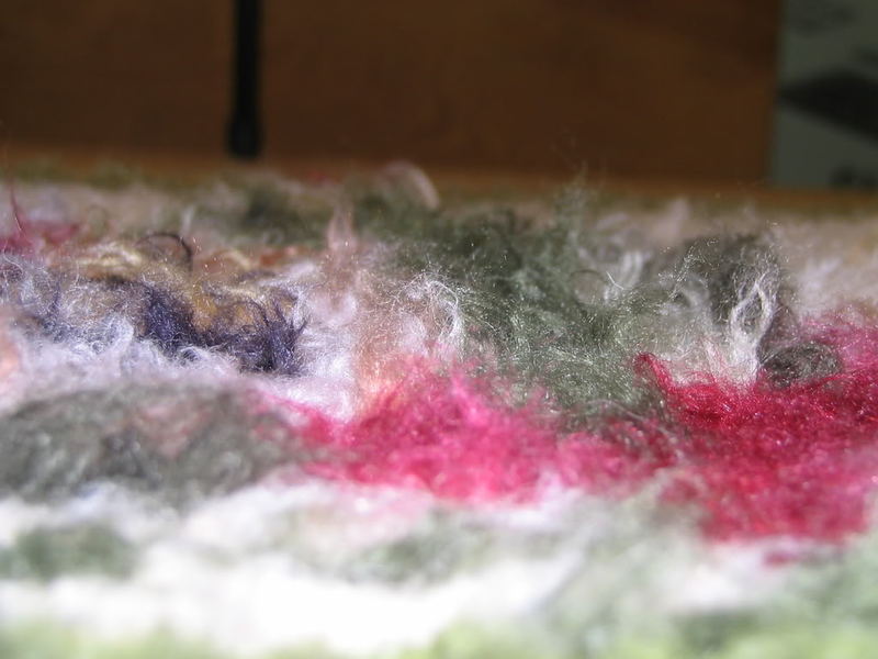

I actually have a wool loop pile carpet this Friday to do some repairs on and it is fuzzing all over, I will probably be shearing it since it is in such good condition otherwise.

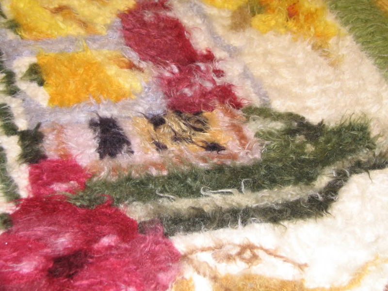

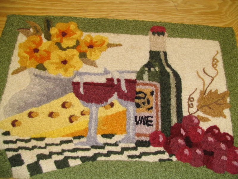

I have done some where the carpet had a very poor bundle wrap and fiber slippage, so we sheared it all off in a school. Makes it look like new. I have a hand unit I use for upholstery that will make a pilled piece of goods look like new again.
Here are some shots of a little area rug I did that had terrible fiber slippage, I have shared these before but now they may make a little more sense, I did not use the Micro Shear but my hand shears, still same effect
