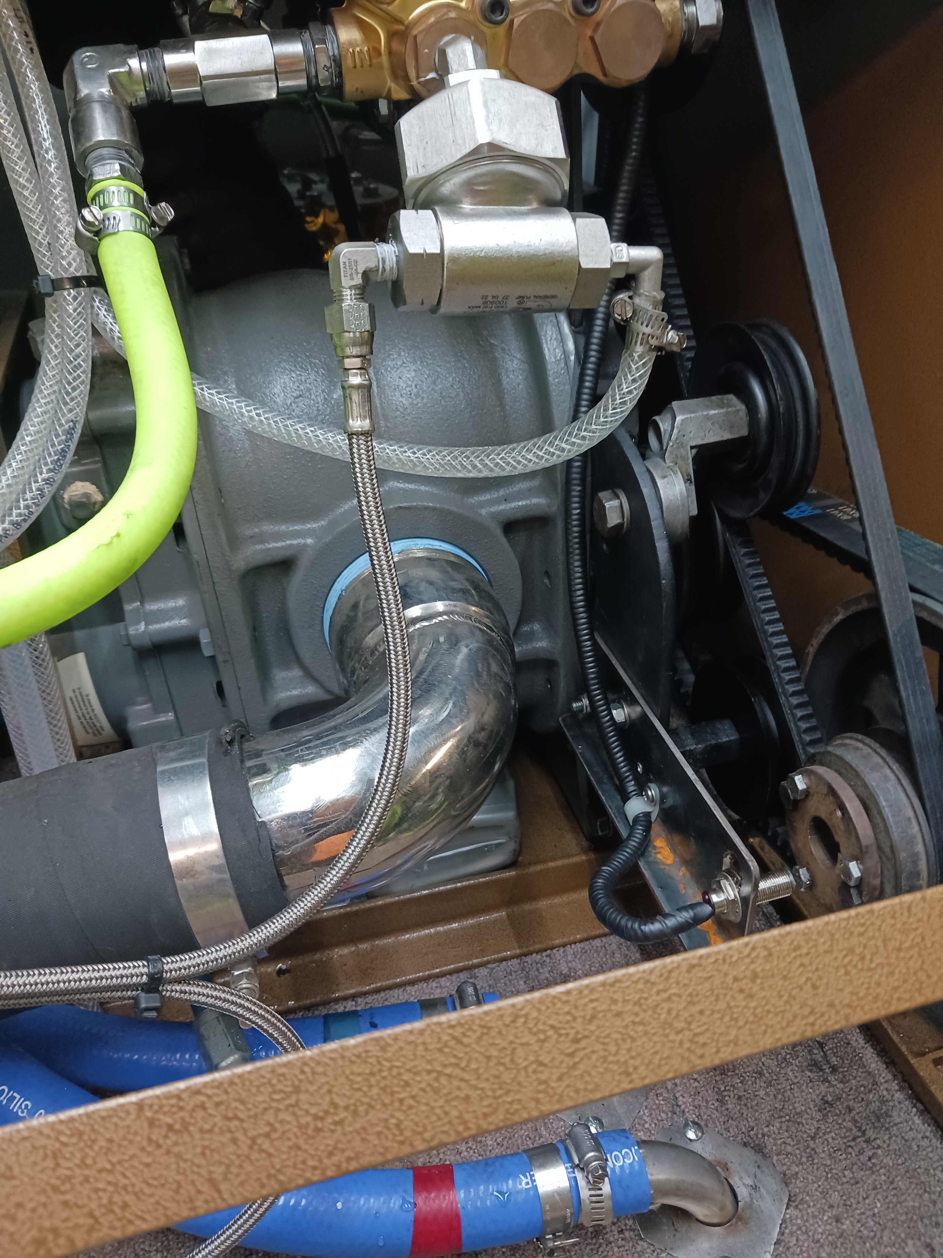

Can someone enlighten me on what causes these GD Trilobe blowers to fail?
27,885
I just wasted $6k on a new blower that wasn't needed.
After installation of the new blower, took it to a job. Less than a hour in the job, the same symptoms came up of the bogging down on full throttle/load, and the belts smoking and stretched. F$%*!!!
Parked the truck and admitted defeat. This was the most expensive misdiagnosis I've ever done. Not a fun lesson in business to learn
Submitted myself back to JD and they checked it out and tested it. I was impressed by the technician that worked on it. I think they fired the JiffyLube tech that worked there last time I had it serviced. They found that there was a gap in the spark plugs too big that caused plugs to burn hot/lean from the way the plugs looked. The tech said that it made the engine work too hard, causing the bogging down, giving the reason it seemed like the blower was seizing. The vac release valve was sticking a few seconds before opening properly, enough to add to the problem.
The only good news is this wasn't my fault. Well, it was my fault falsely diagnosing and buying another blower, but the cause of all this wasn't. The plugs were falsely gapped and never checked before JD's tech installed them at the 2khr service I had them do 700hrs ago.
So...do you guys know anyone that might want to buy a blower with 2700hrs on it? I'm have no desire to store it in my building

I could be wrong but I'd be willing to bet that the relief valve had more to do with it than improper gap (if it had anything to do with it at all)
Improper gap can cause misses and the like but your description doesn't indicate a poorly running engine. It describes an engine trying to overcome stress. Why I asked about the relief valve and the exchanger.

Blowers are positive displacement, what goes in has to go out and vice versa when sucking without or with a stuck relief valve they will continue to pump down till the engine stalls belts slip or tank collapses higher the lift the more power required

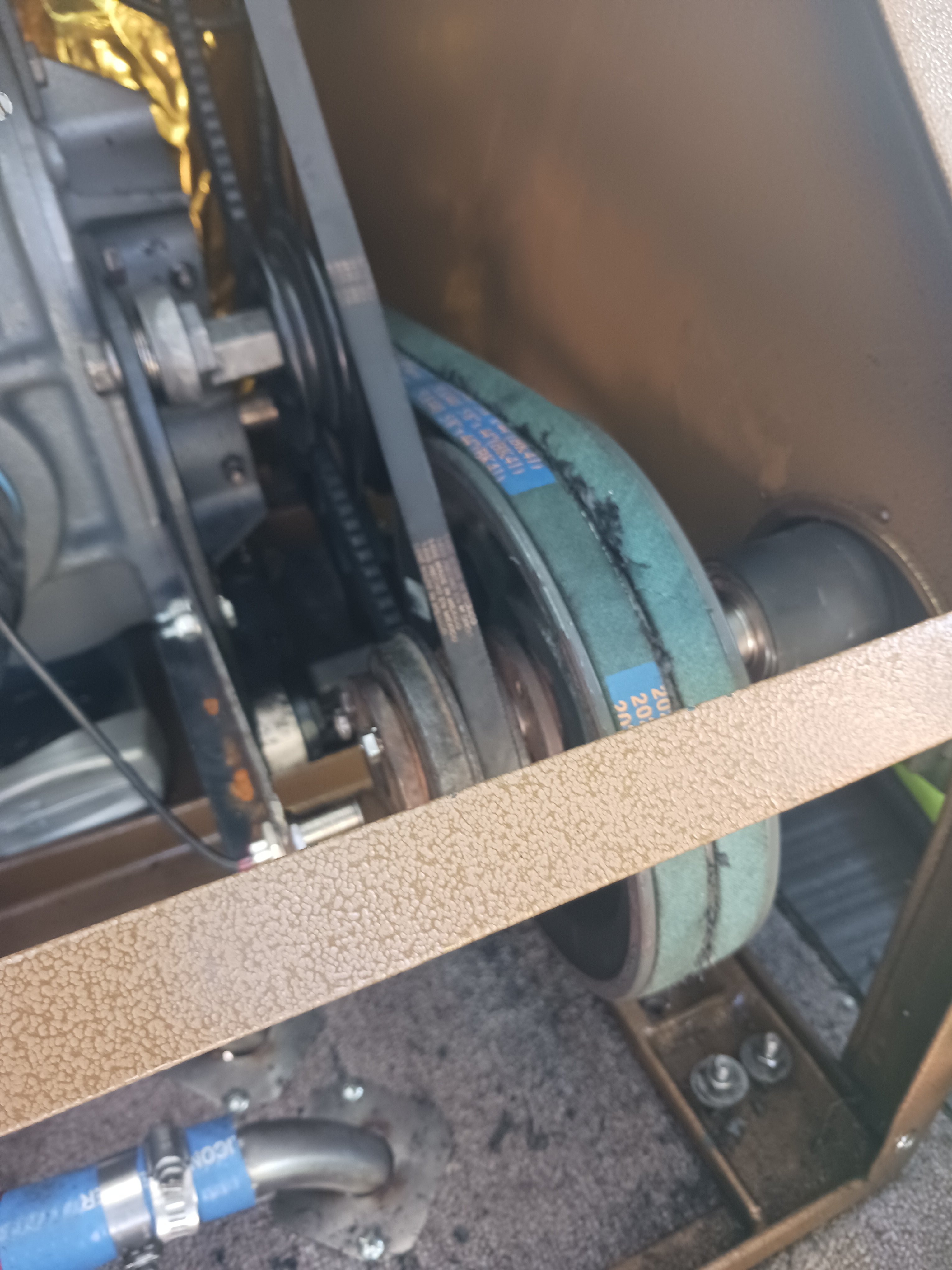

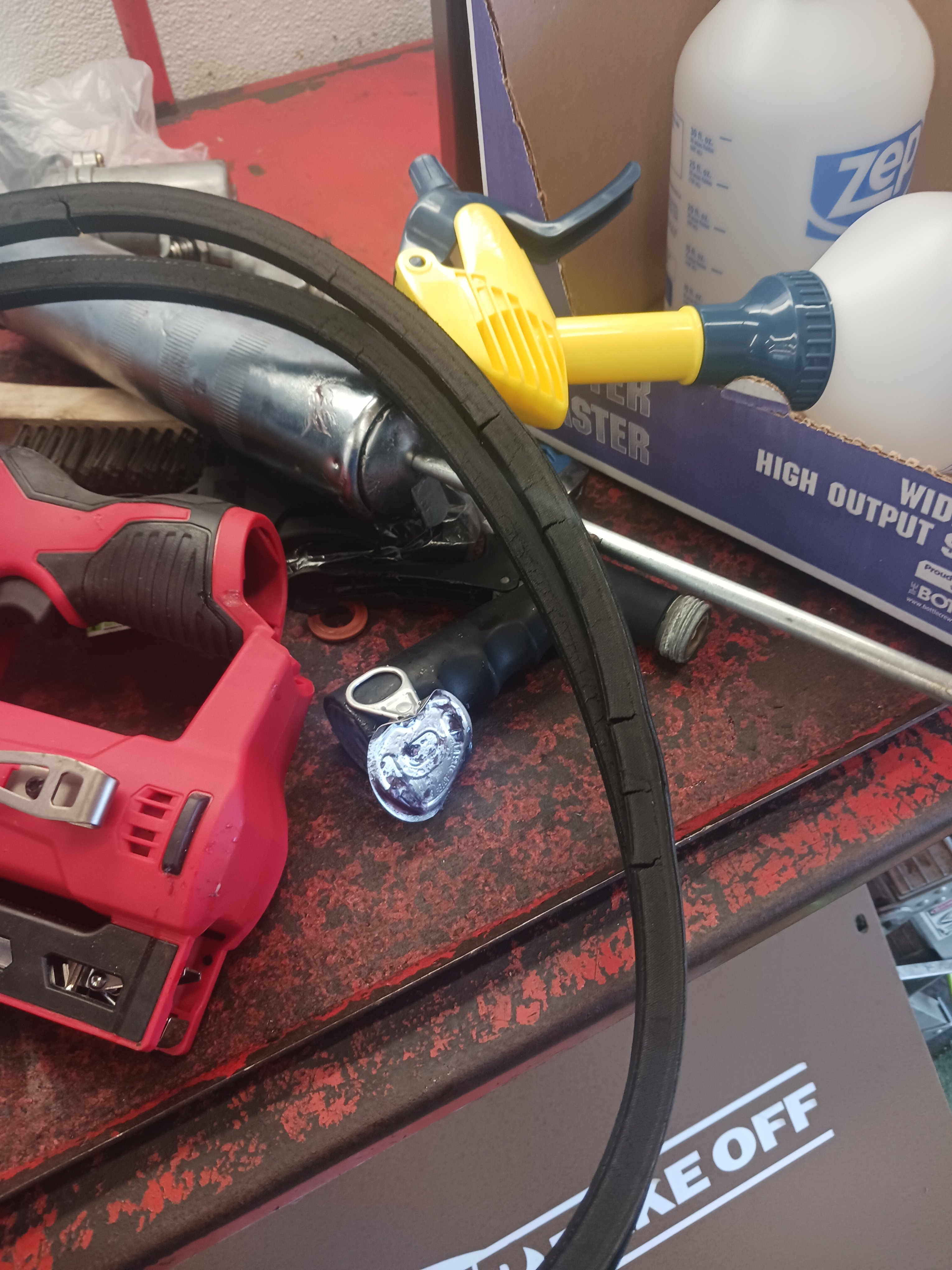

So if im doing the math right you've gone thru 5 belts in 2800 hours?? you're getting on average 560 hours on a belt?? and you feel this is good??
I feel pretty good about the number you came up with, I don't run my belt to a pulp, always remove one link when the belt is getting wobbly. Never had a broken belt!!!
When the belt is getting thinner, I toss it out and replace it with a four feet section. I went through five couplers from TB Woods. It takes less than a minute to replace the belt, for coupler replacement, I need about 10 minutes since shafts can be pulled apart with an actuary motor. I share this for comparison, I'm familiar with standard belts and the timeline for their replacement. I may be OCD about my truck mount, I over-maintain it, I'm always game for spark plug changes, oil changes for a water pump, blower, and the engine as needed, and even more often. I'm proud that I'm one lucky bastard that spends zero hours and zero dollars in repair facilities. I believe that almost 600 hours doesn't sound bad at all.
