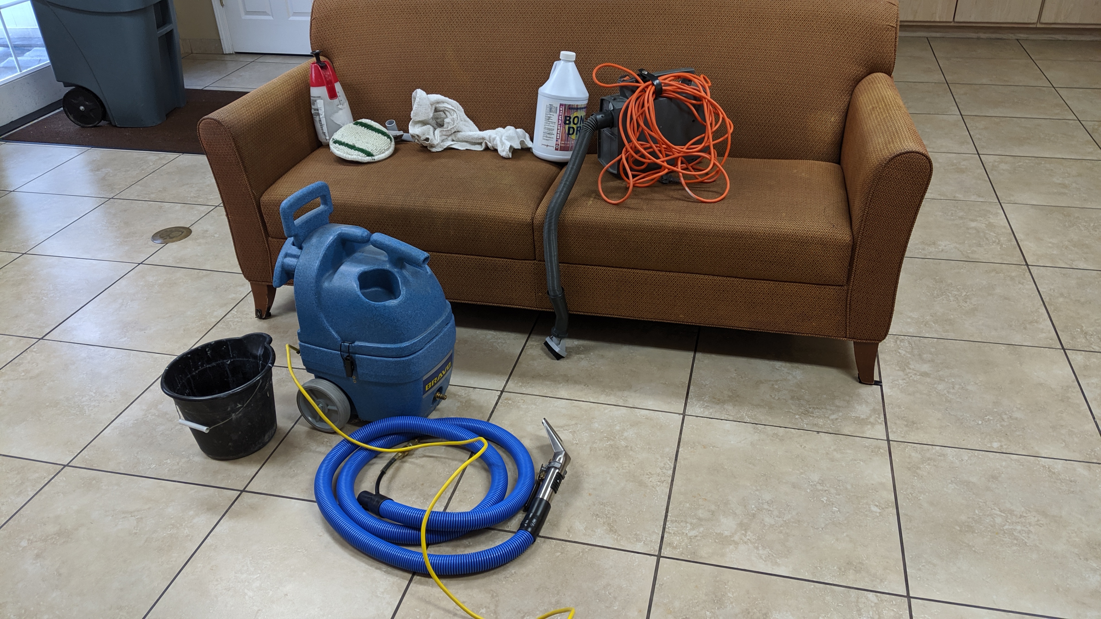

Vac port, and nipple for solution line is not mounted in same area...
Which is why it doesn’t come with a hide-a-hose...

The pump in the Edic is not powerful enough to drive any of the 3 tools mentioned... it doesn’t drive enough solution to the tool head to be effective....
117,272
well thats an issue for sure but not what you guys are not catching...
of the three tools I tried, the RVSD allowed for the most water to "interact" with the fabric, as it's jets are furthest from the vacuum port.
