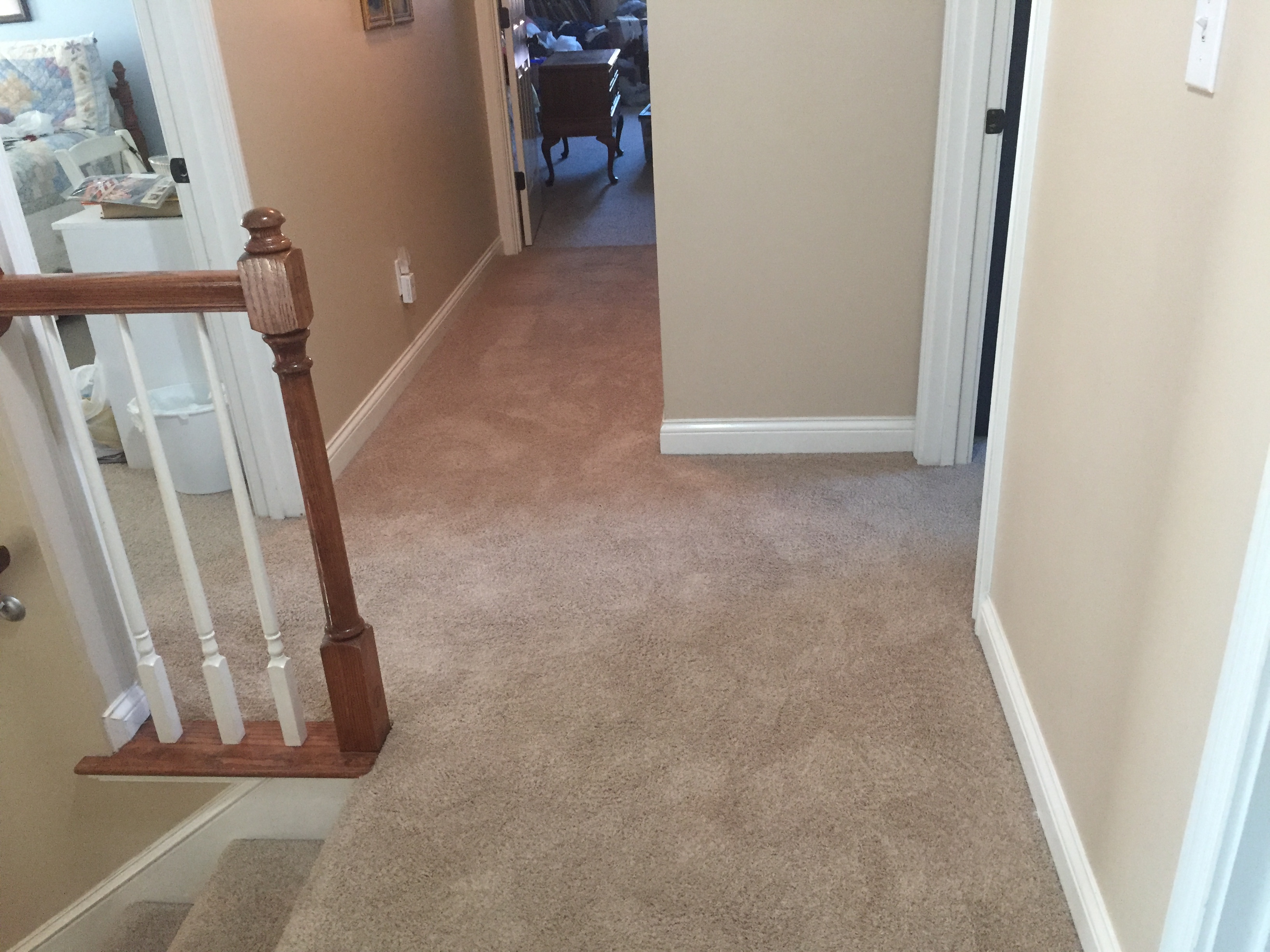

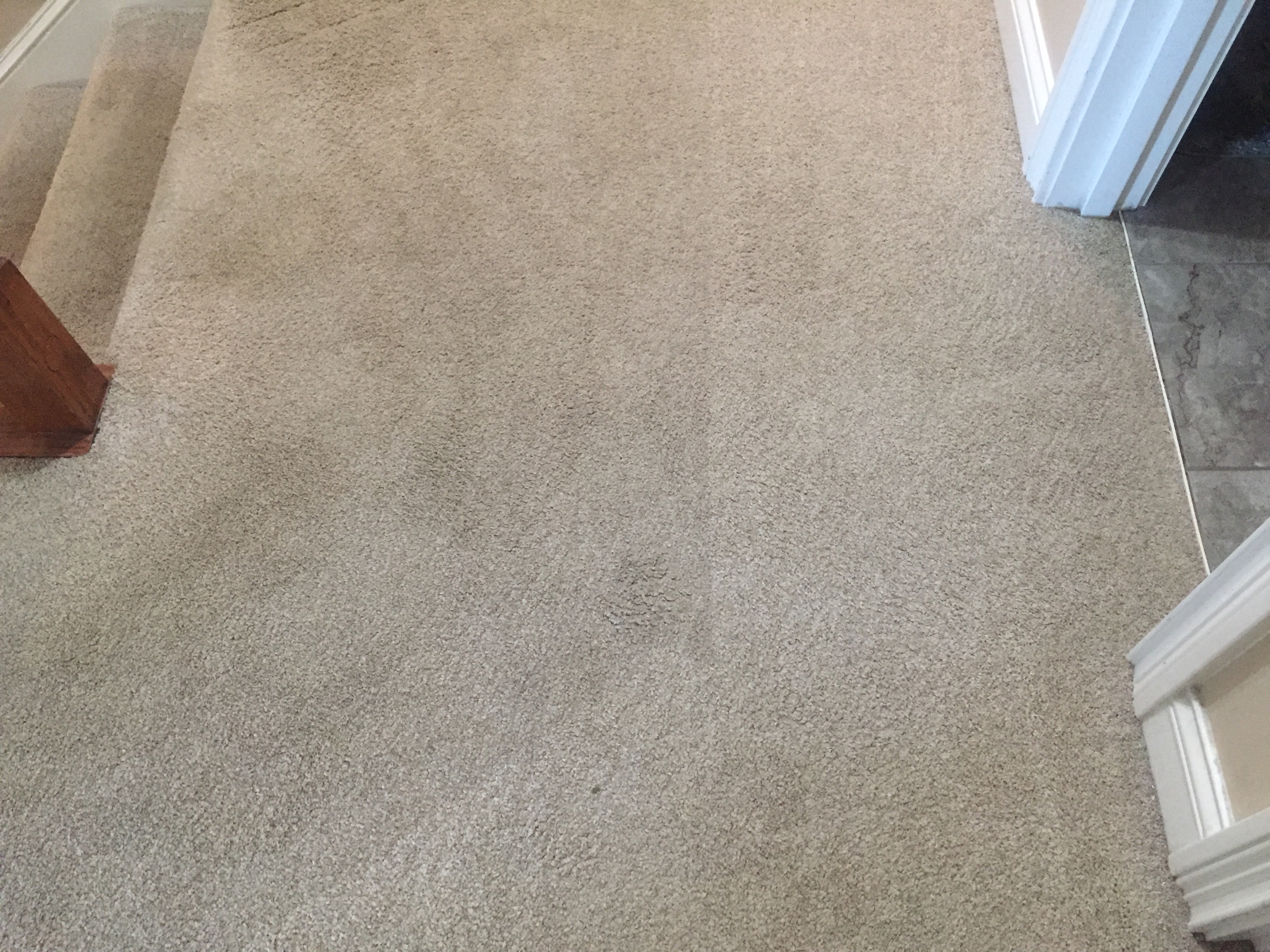

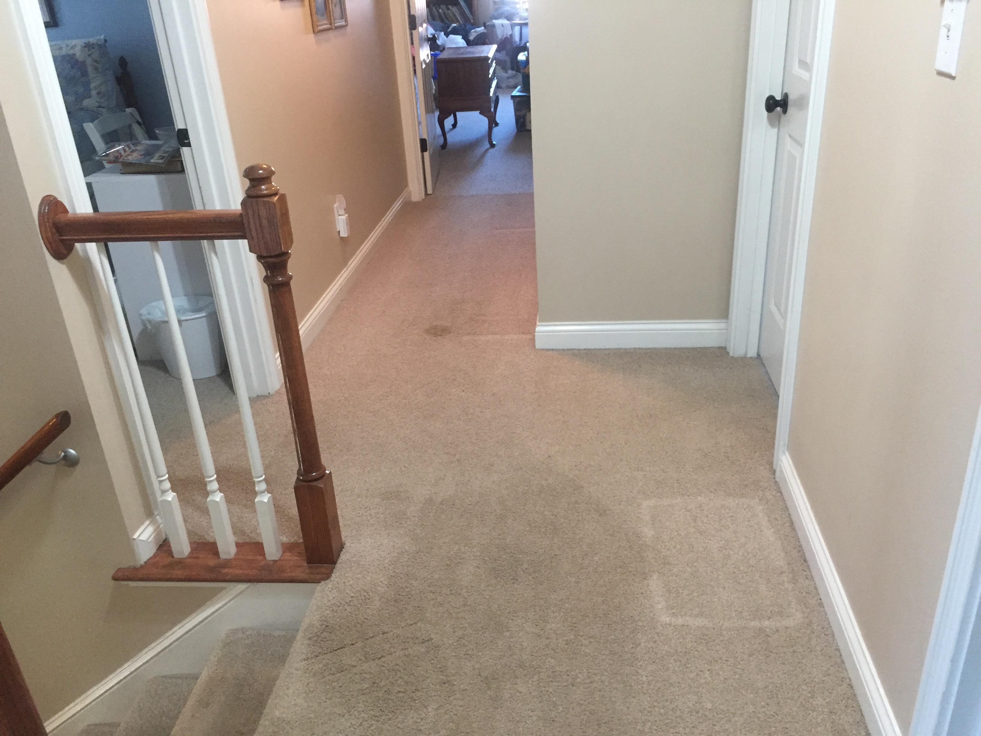

Before #1: It is easy to see where the plastic runner left adhesive on the carpet.
Before #2: The steps and landing show how soil has adhered to the residue.
After #1: Using a 50/50 mix of Citra-Solve II and distilled water, I presprayed the adhesive. I then ran the 360i brush head over it with no water or vacuum, to scrub.
Then I applied Saiger’s Free and Clear to emulsify (“DO YOU KNOW WHAT EMULSIFICATION IS?”) the Citra-Solve II and extracted the whole shitterie. Customer showed her husband the gunk pumping out of the apo hose and he lost his appetite, hahahahaha!
After #2: the whole place looks like new carpet. Job was done at .51/foot.
Not shown was a furniture stain spot from whenever; it came right out. Ditto for numerous other spots that I shot with Citra-Solve II. I plan to bottle the remaining solution for future spotting.
