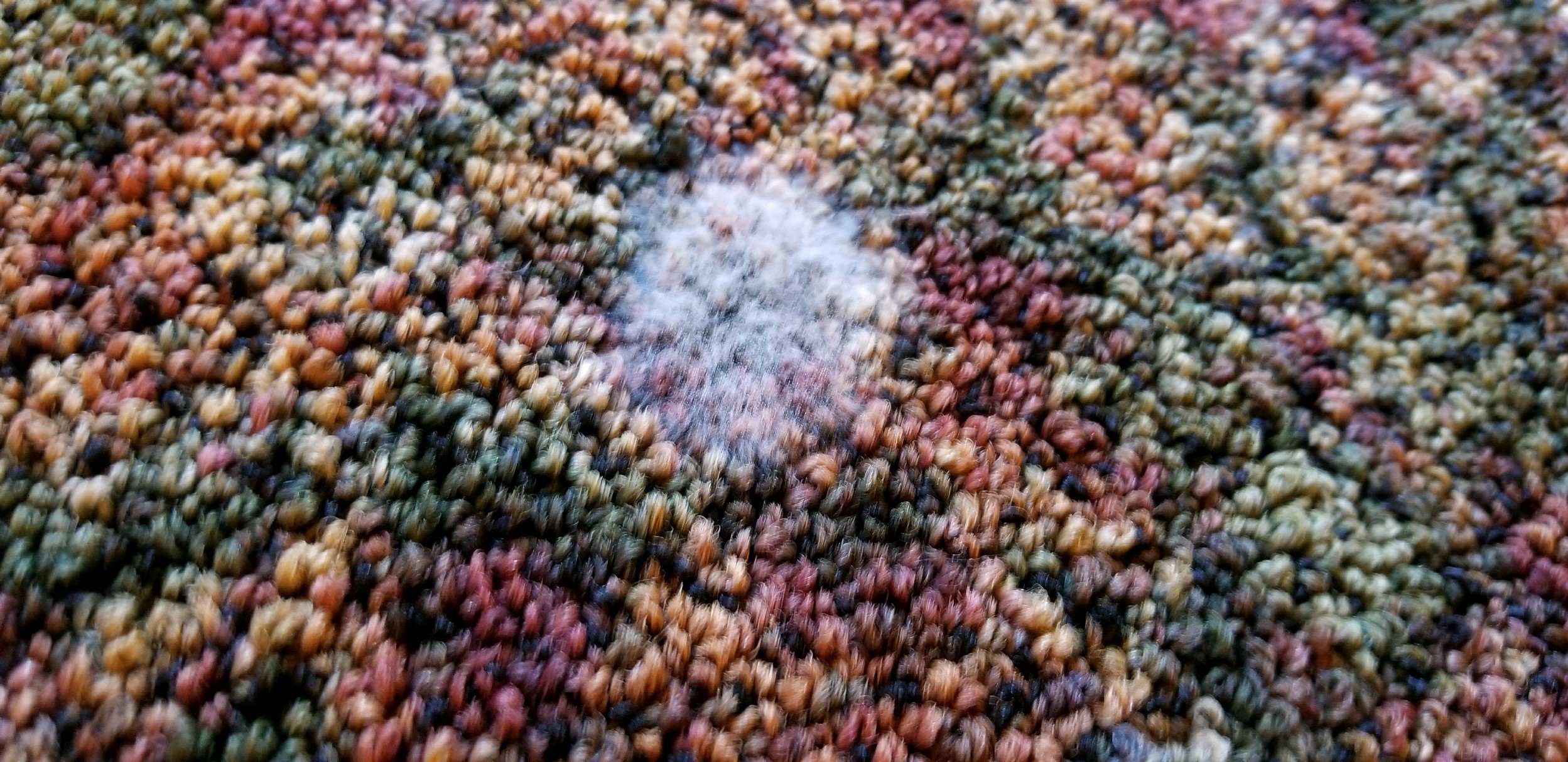

Rick J
Cleaning Professional
Jan 9, 2016
962
rick Jones
furry??
