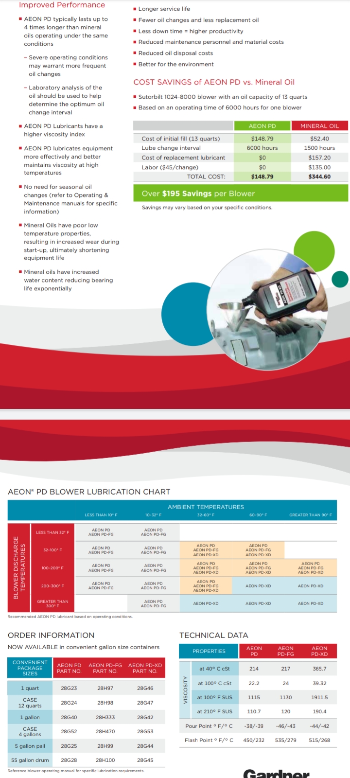

When giving advice i try to lose as much techno mombo jumbo as possible to get the information across and sometimes i dilute it too far. For those techmo geeks this one's for you

According to Dwain's chart, Amsoil Severe Gear SAE250 is too heavy. I would just order some Aeon, but it appears my distributor is closed for the holidays, as is PD Blowers.
I have some Amsoil Severe Gear 75W-90, which is too light.
Will try mixing 250 with 75W-90 for now. Or pick up some quality SAE 90 gear oil.
Thanks, Dwain!

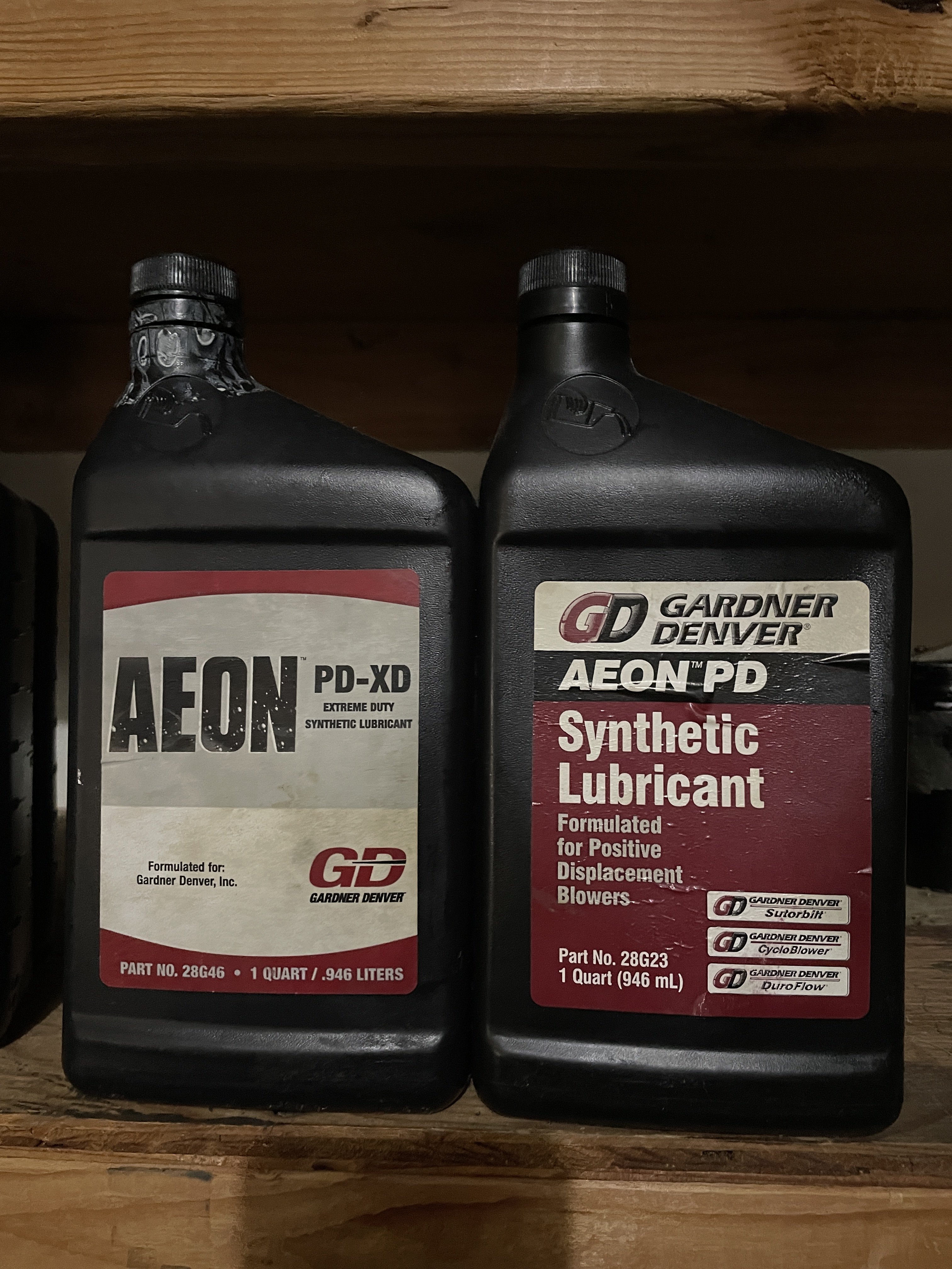

I think now you're just splitting hairs now if you look at the picture of the aeon bottles 1 says gardner Denver which is sutterbuild it's like pump oil , i have a hypro pump but i use cat oil in it instead of hypro oil because i can get cat oil from home depot and id have to special order hypro , it is more important the frequency of service intervals than which brand of blower oil you use when i built frankinstien i retired a 47 blower that was new in1991 and passed down thru 3 machines and has approximately 14,000 hours on it but i changed the oil in it every time i changed the pump oil 500 hour intervals
