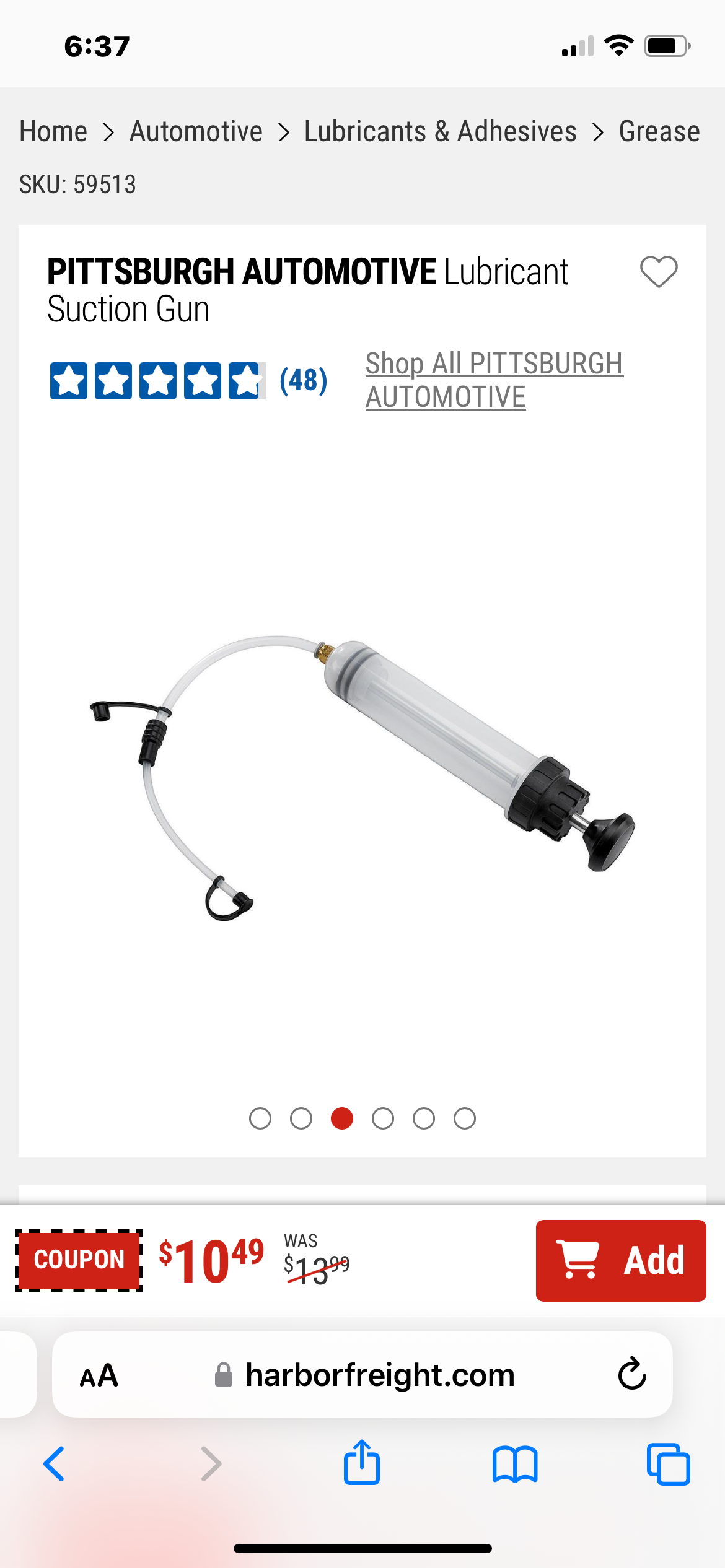

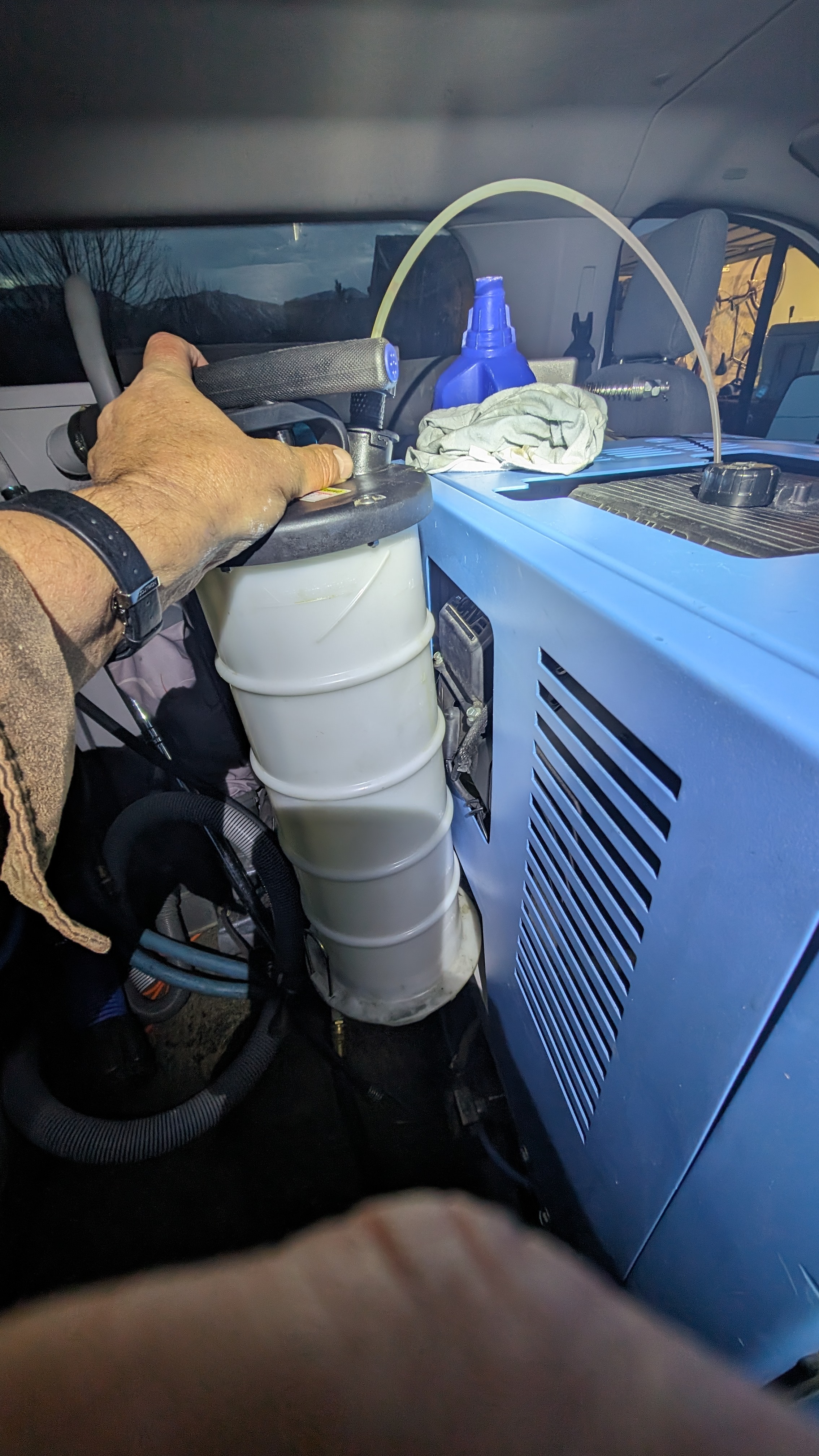

The exchange rate here of old Aeon oil vs New Aeon oil doesn't inspire confidence. Here we are as glorified vac cleaners and there's no vac attachment to extract...
Hold my bubbly water:
