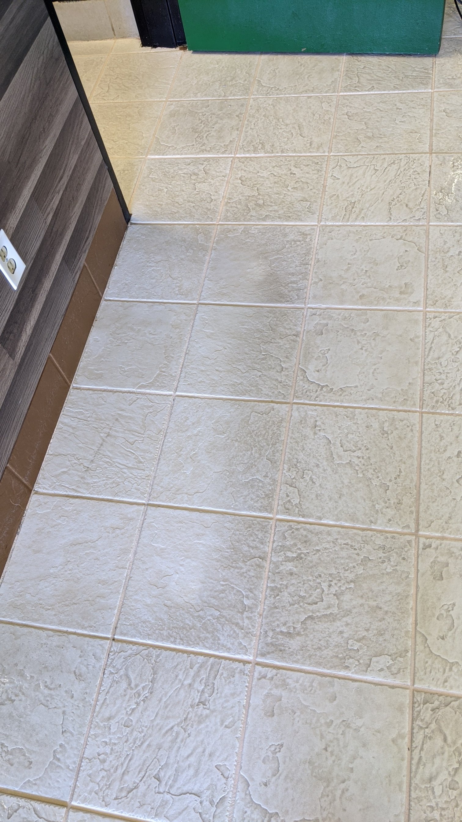

117,181
That's with double strength Tsunami, stripper boost, Nylagrit 175 super slow pre scrub and 1200 psi turbo rinse...
14,601
Did you try an acid wash to see if any of that was just bleach/soap residue from a stupid mopper?

Are you asking if I used undiluted acid cleaner?
No my next Prochem's restoration acid 50/50 and not even the slightest fizz or effect
Yes. Straight up for a test spot. Muriatic acid. But, if the 50/50 had no effect, probably a waste of time. May need a top of the line stripper with generous dwell.

Looks like they had something with two front legs sitting there. Whatever it was protected that area from whatever happened to the rest of the floor.

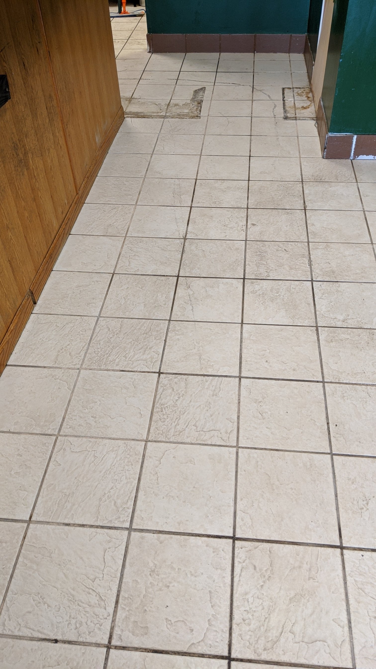

Yes it's a restaurant
where they had rubber mats in the kitchen there's nowhere like this and the tiles look perfect wherever people were walking around the furniture in the dining room created this look
117,181
Yeah I've never seen anything like it , either as Brian Thompson

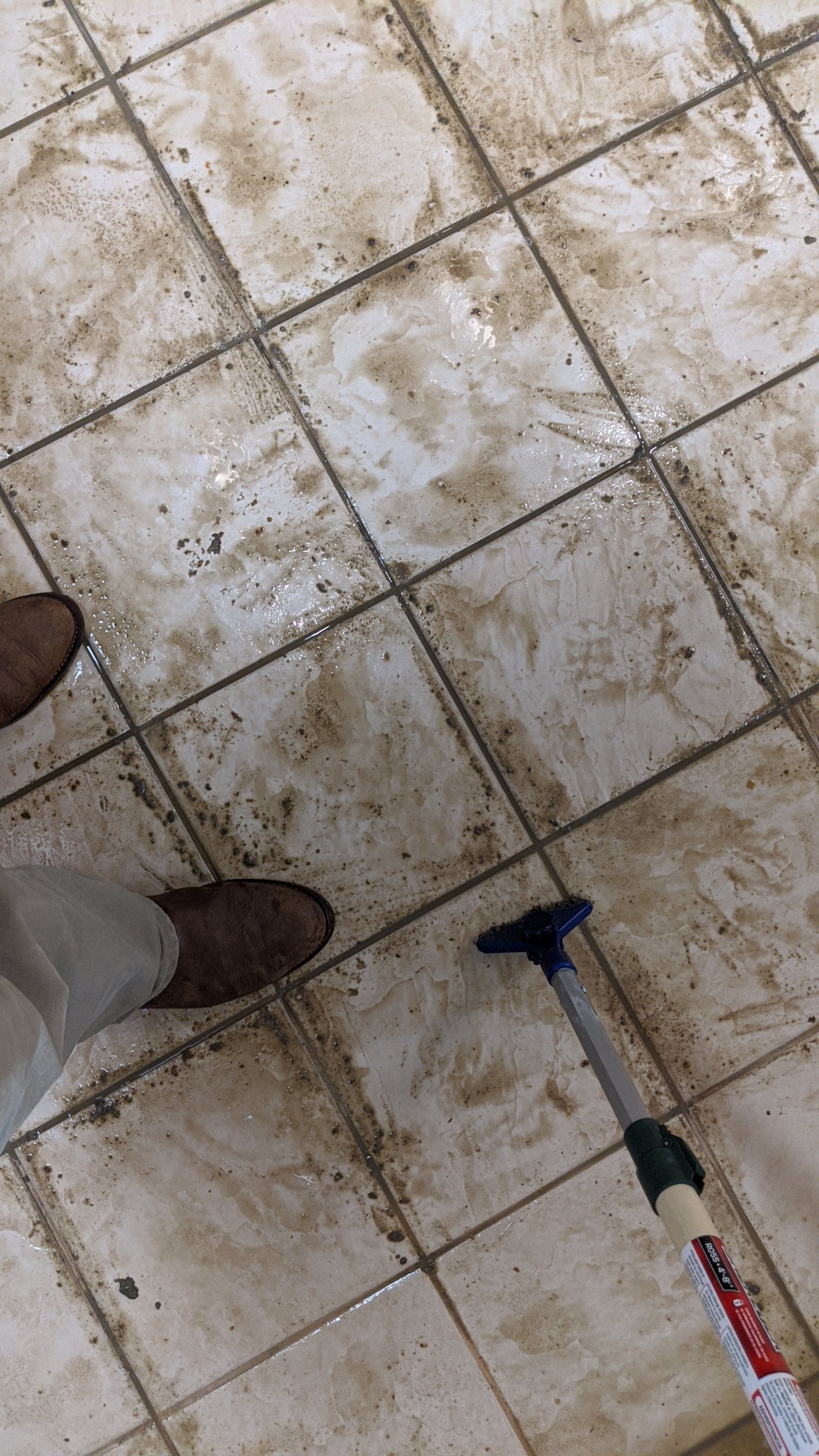

and I cleaned the living shit out of it, literally.

It may have penetrated and permanently discolored it, since ya did everything you could.
14,601
If acid didn’t touch it...I know tsunami is hot, so I’m just throwing guesses out there

need to add an abrasive like lava to your cleaner, then mono with your brush.
