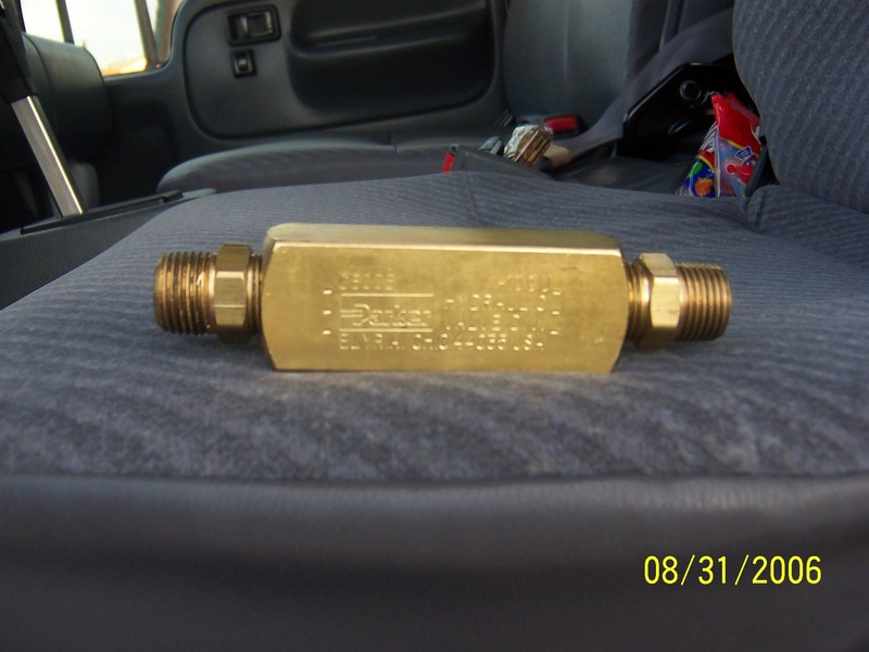

1/2 inch swaglok check valve coming out of e2 exchanger is bad, replace it and good to go.

Actually he had to call me to get the answer because he did not even know there was a check valve there....
If you get this one from windtrax......you will never ever have to worry about it again...thats what I put on mine...
