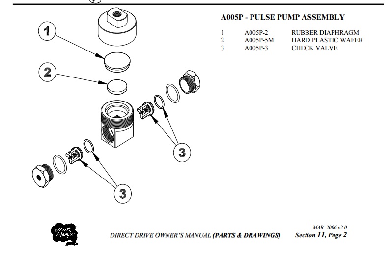

download manual:
http://mikeysboard.com/mblibrary/white-magic-pro-2000-and-pro-1200-manual.1/
section 11 page 2
also has exploded view of general pulse pump above (ignore the wm part numbers)

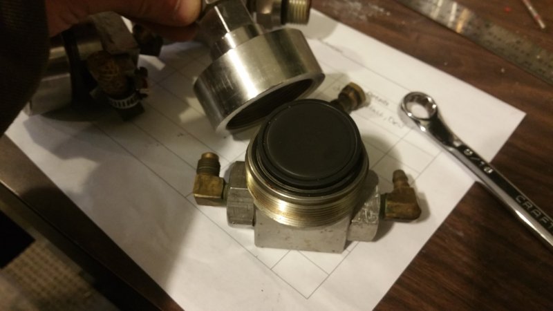

Make sure you put #3 (check valve) in the right way as shown on Fred's post or you will crush it and make it worthless.
Usually they crack in the center.. I would start with the hoses like Mike said, but a rebuild kit is inexpensive.
Take it apart and take a look..
This one looks good^..
