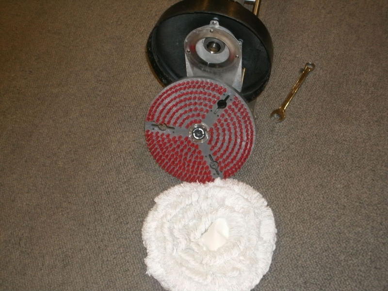

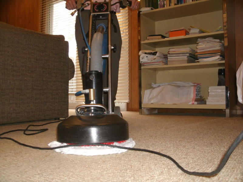

But you can encap with a 360i Sox, probably find bonnets for it awell. You don't have to run vac and solution too it bud. Swap heads, hook up your hoses and your cleaning tile and grout.
It has a speed control knob homie!
Down side is head size on commercial work.

Bonnets run easy on a 360i. Very versatile tool.
