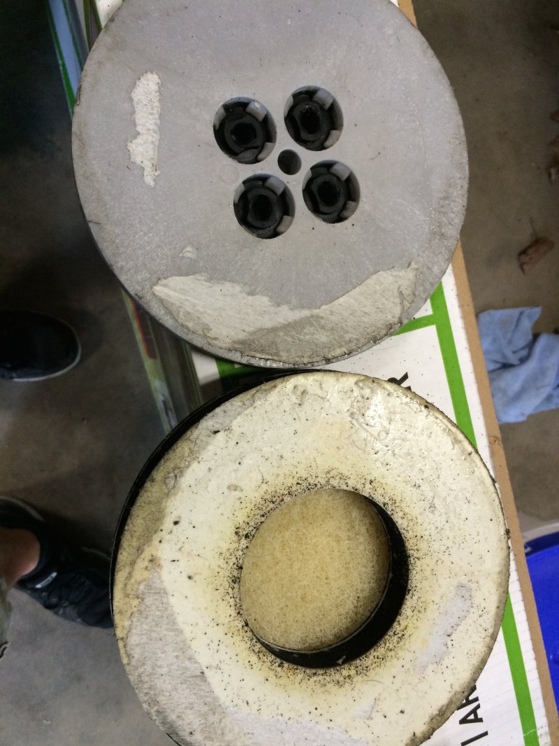

Anybody ever had their pad drivers separate? At the end of a job yesterday my pad driver separated into two pieces.

yea it happens.We keep a tube of that 3-m water proof glue in our container.
It works great when cured and last a long time.
Get it at NAPA 3M Super Weatherstrip & Gasket Adhesive #080002

I lent my Mex to a former MB'r who didn't pay attention to pad wear and cleaned half a huge warehouse with the just Velcro.. :eekk:

:yoda:Always carry a couple of spare boards.
Simply change over & fix the busted one when you get home.
