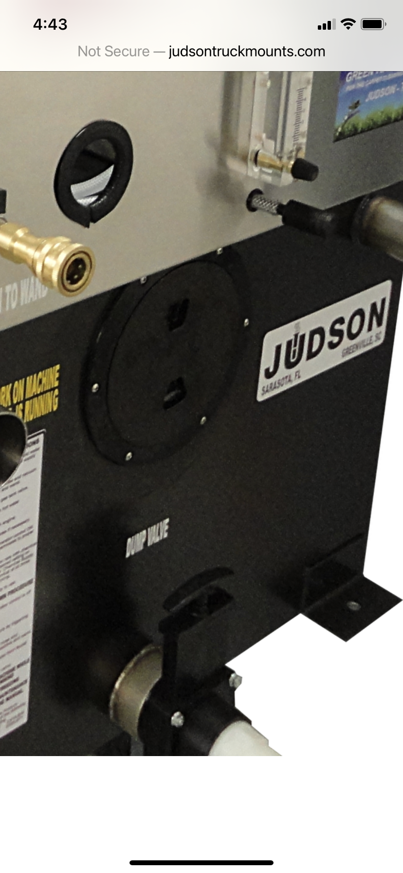

Any suggestions on how to remove the black cover on the waste tank?
pin spanner wrench, deck plate key, wood and a rubber mallet
you can also drive two lag bolts into a piece of 2x4
The Great Oz
5,295
bryan
Thumb and forefinger in the holes, twist anti-clockwise and the inner plate unscrews.
