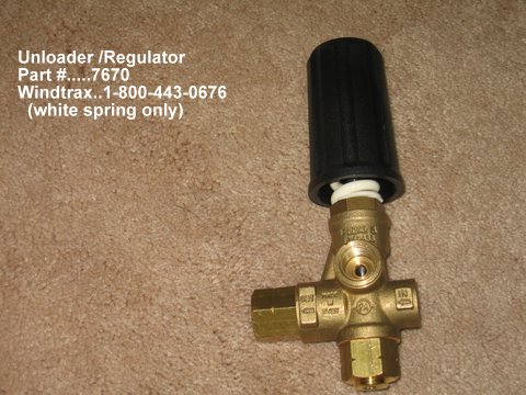

should be this one....check the physical appearance on both...

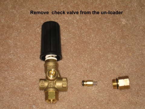

check the old one to make sure it has been removed...but you're probably going to have to remove the check valve if it is not in yours....

I picked out #7730 100 - 3000 psi or #7750 100-4000 psi.

the one in the picture above I bought a long time ago for the Thermal-wave... ....I think I paid less than 60 bucks for it then........and it fits in a lot of machines...

Hmm, I've never done that. Don't know if I needed to--they worked fine.
pending on where you buy it...some have them already removed...or if it is just being used as a normal regulator and not an unloader then it stays in....I have helped a ton of guys that were having problems and come to find out they replaced the unloader and it was still in there.....
